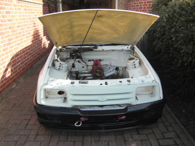

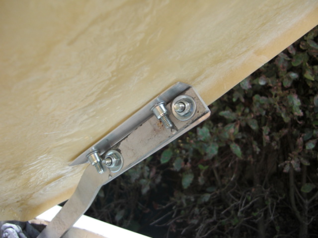

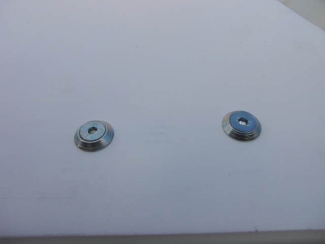

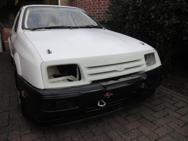

                  Finished fitting the new bonnet today, made some brackets to come off of the origional hinges and fitted M6 rivnuts. This means that the bonnet can be unbolted very quickly if needed and I fitted some nice cup washers and countersink bolts to spread the load a bit
                  Also fitted the bonnet pins, just gotta get another pair now, one for the front of the bonnet and another off of the strut brace if needed.
                  I then turned my attention to the rear of the car.

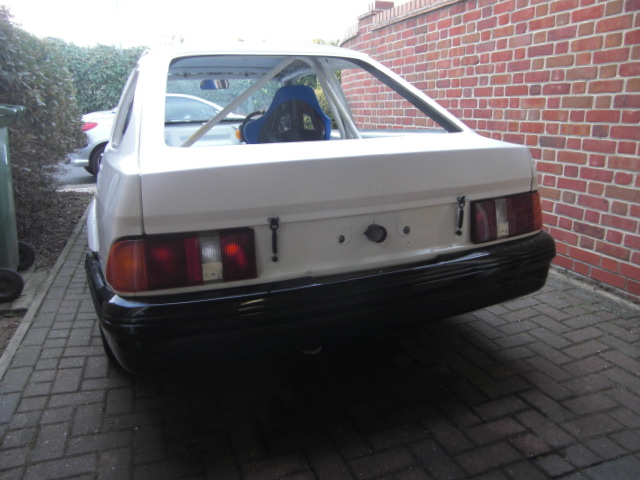

                  Fitted the LED rainlight into the back panel, and also removed all of the strengthening plates from behind it in the boot as they don't do anything now there isn't a heavy tailgate to slam down.

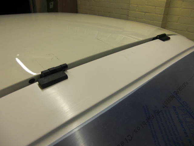

                  Then I fitted the tailgate using HD plastic hinges from rs and boot springs. I have got the angles right so they dont 'bind' the tailgate or bend it when lifting, plus you can also swing it right over and sit it on the roof where it is safe from gusts of wind.
                  I've hinged both the bonnet and boot because they are single skin and very light, so wouldn't really be safe if you removed the and left them off in the paddock, they'd either blow over, or away

                      Looking good Dave did you fit a resistor to the rain light if so what size ,where did you get the washers for the bolts and were they expensive as i would like to fit my arches on the nova with bolts and washers like that but am going to need a few,
                        #71
                        I have a resistor for the light, I'll let you know what colour code it is, I can't remember off hand.
                        The bolts and washers, I've sort of borrowed them from a machine at work.
                        I'll have a look and see if I can order you any, or if not where to get them

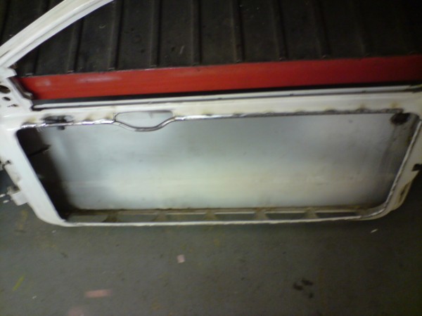

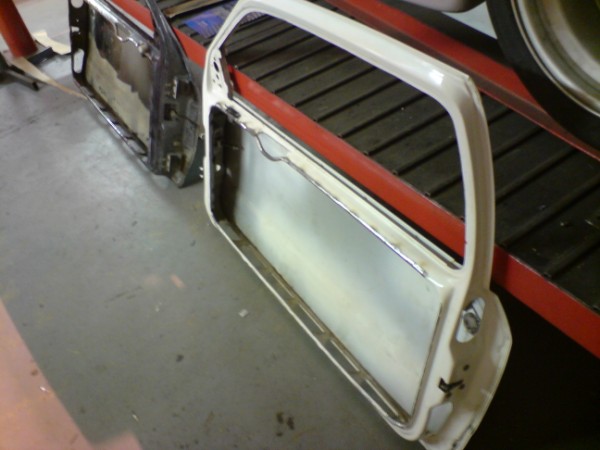

                            Weight reduction continues (of the car at least ), today I helped(?, made coffee..) Gary lighten the drivers door so now I have a matching pair, well sort of if you ignore the colours
                            Cheers Gary
                              #74
                              Your welcome
