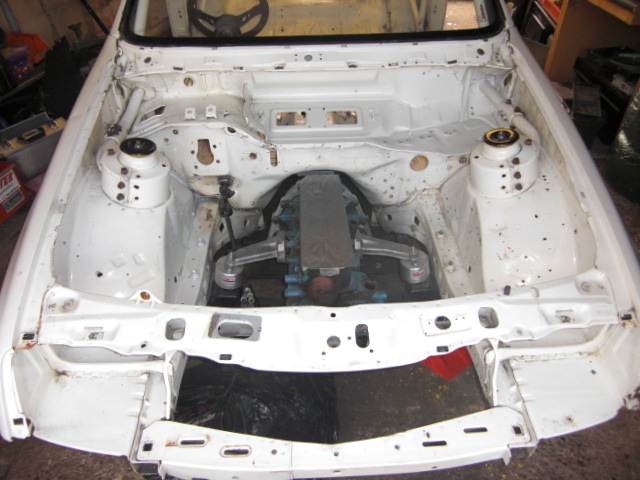

    Got the engine bay flatted down today, nothing major just used scotchbrite pads and emery just to get rid of any bad bits from spills or burns/scratches.

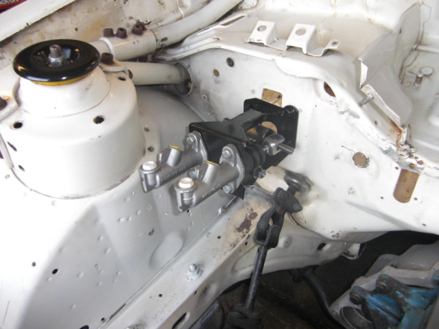

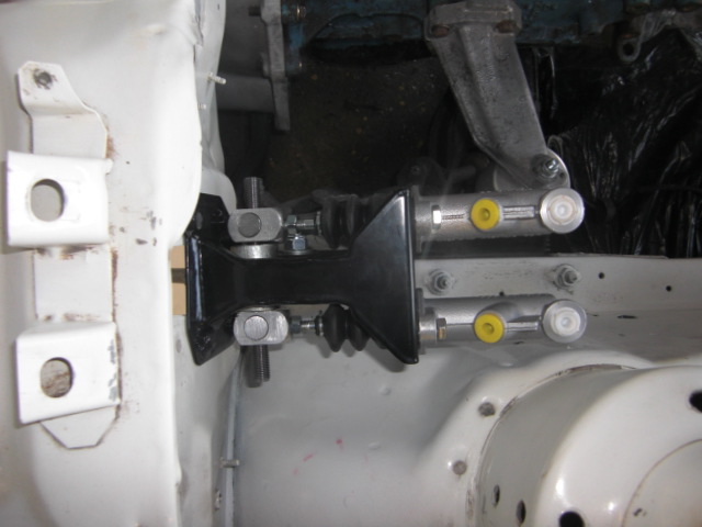

    Also test fitted my new bias box set up, which fits in place of the old servo and retains the std cossie pedal assy. Makes the inside of the car tidier and is a lot easier to work on the bias or master cylinders rather than the norm of having to lay upside-down in the car with your feet on the ceiling while brake fluid drips on you (we've all done it )
    I did start to try the manifold to check that it wasn't too near the cylinders but it turned out to be bloody miles away with about 6" of clearence

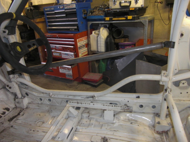

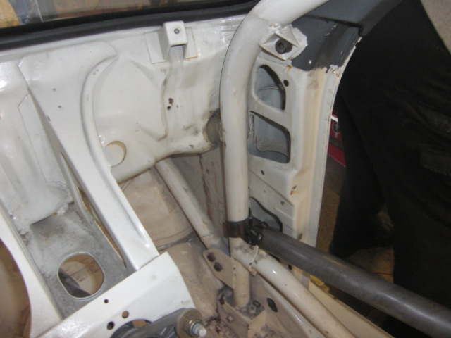

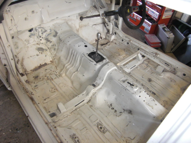

      The inside of the car is nearly prepped now, just needs a good clean. I have also been trial fitting the new (additional) door bars as the current ones do a great job of stiffening the shell along the sills, but do little to protect occupants
      They came from OMP and are universal so will need adjusting to length. This just means we have to break the spot weld on one end, slide the end piece out and cut down the tube about 10mm or so to get the rear a bit lower down the main hoop. The front of the door bar rests just above the existing one and although not ideal triangulation is about as good as it gets without refabricating the cage.
      Seems a shame to add weight to the car at this stage but safety has to come first and i'd hate to take anyone out on track in a car without proper door bars, especially as the doors are about as heavy as crisp packets now
      Front of door bar in position but rear needs lowering a couple of inches or so by shortening the bar;

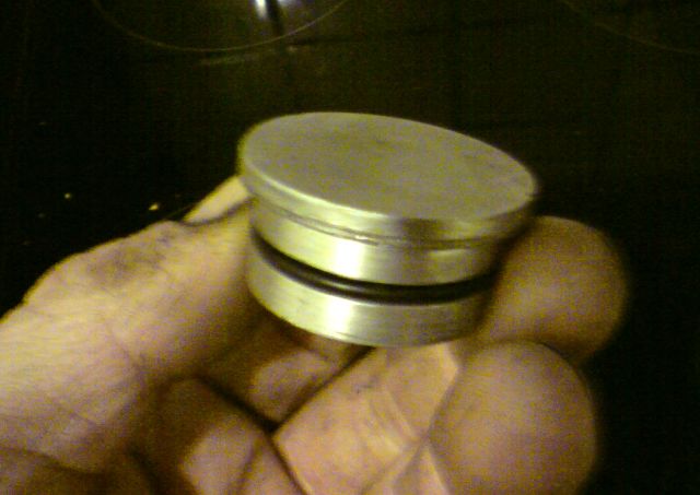

                          i made this for it today,
                          its a bung for the dizzy hole so thats one hole bunged up

                            Cheers Graham, better make another one for the pipester
