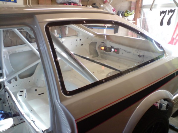

Will hopefully fit the tailgate window this week, that will be bonded in to give the hatch a bit of strength with maybe just a couple of bolts to be sure it cant move..

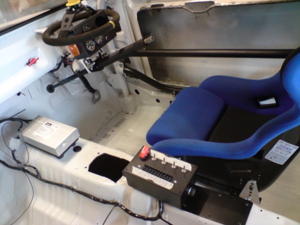

Got a bit more done today, Andy finished the wiring loom and has now wired into the switchbox and ecu. The battery is also fitted and wired along with the cut out switch on the bulkhead.
A full test of all of the cars electrics was tried and we were all overjoyed to see that everything works.

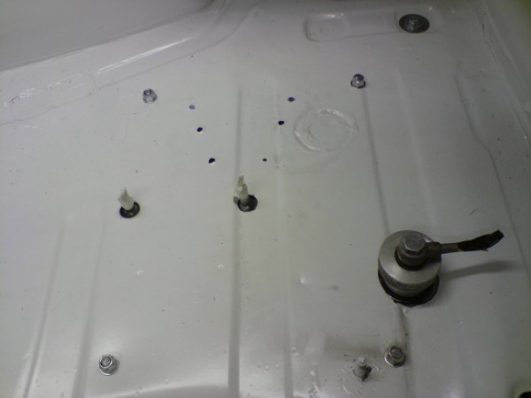

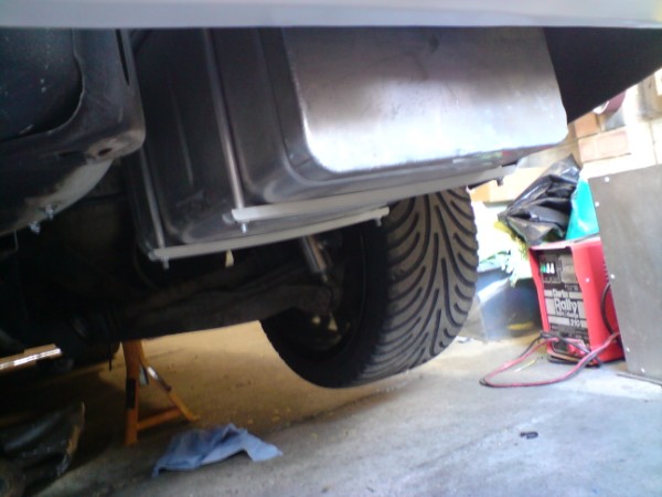

The next job was to get the fuel tank in. We did this simply (although carefully) by making 3 holes in the boot floor to correspond with the outlets and filler on the tank and then once lifted into place under the floor we made 4 supporting rods and 2 braces to clamp the tank up to the floor.
To keep it all clamped tight and not damage the tank there is also some strips of foam/rubber insulation above the tank plus it also fits tightly between the rear panel and the chassis rail so it cant move even if the rods bend. Myself and Ant carefuuly made the clamps so that we could get a very tight fit around the tank with minimal intrusion into the car and i'm well pleased with the result.
We just need to make a cover for the filler spout now to act as a firewall, this will be pretty small as the filler only sticks up a couple of inches

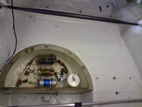

Andy also got the swirl pot and fuel pumps into position in the wheel well. We can now start to plumb in all of the fuel lines.
