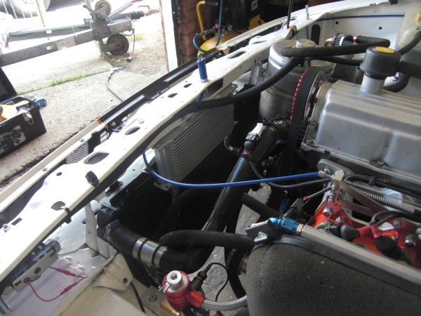

      I would have done but I fear that i might have added more than I lost with the addition of the oil cooler . Ideally i'd have fitted a smaller one but 16 row was the smallest mocal I could find with 3/4 fittings.
      I removed the blanking plate i had above the rad to fit the cooler and I think it gets decent airflow in there. I also removed all of the intake duct and trunking to the air filter as i doubt it was doing a lot and space is now getting short in the engine bay.

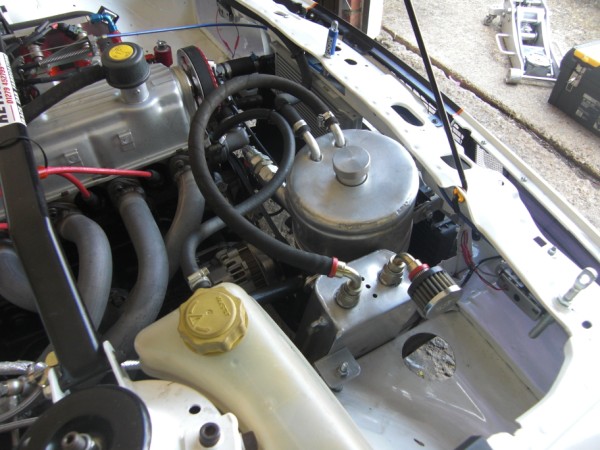

      We also tidied up the catch tank install as this had to be raised up at Brands as it was filling up with oil rather quickly Raising it seemed to cure it

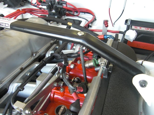

      John made a new means of holding the throttle return spring by drilling a bolt, we just have to remember it if we lift the strut brace

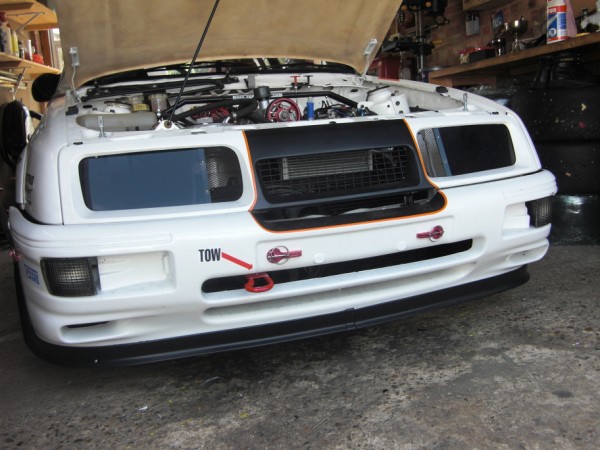

                the bumper looks better now dave , how much weight are you planning to take out of it ????
                surely it doesn't need that much out of it
                who cut the bumper and how did you get that curved edge so .... well ... curved .

                  I cut it. Black and decker jigsaw mate
                  I cut out as much as poss without it looking too ridiculous but at the moment I'm looking to remove anything that doesn't have a good use so a few more bits will be unbolted / cut off this week
