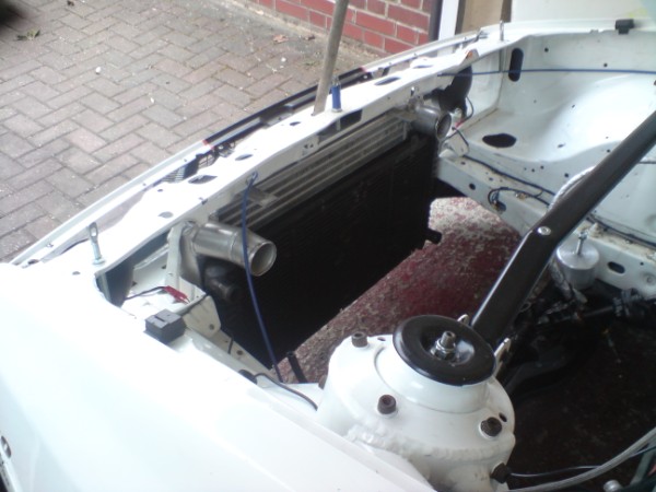

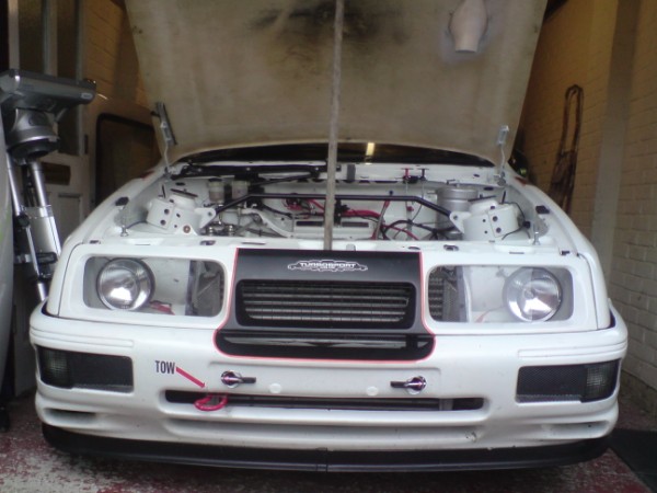

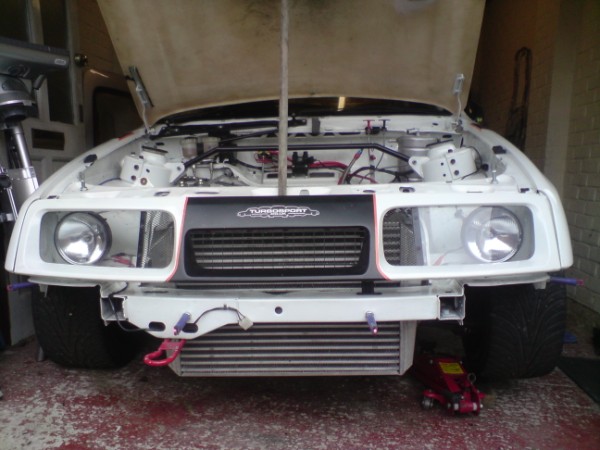

                      For now I've been fitting my recent purchase of an RS500 intercooler. 5 minutes to fit I hear you say, err no.. not when it has been modified in various ways for use on a couple of different setups in a bmw racecar.
                      Yes I have Mr Bahrs old intercooler that he used on his 500bhp M3 16v turbo engine. Trouble is that when he had it on the car initially with an 8v engine (I think) it had had its inlet pipe moved to the side and blanked off at the top. With his final setup its inlet moved back to the normal position but the side inlet was left but blanked off and this lined up perfectly with my o/s chassis rail
                      I have got over this by moving the intercooler over about 5mm towards the n/s and then made an extention piece to go on the origional bracket to allow me to use the normal fixing hole in the chassis. A bit of faffing about but well worth it as I now have an AH fabrications intercooler (expensive!) for lots less than I'd have paid for a crappy ebay special.
