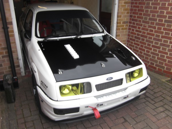

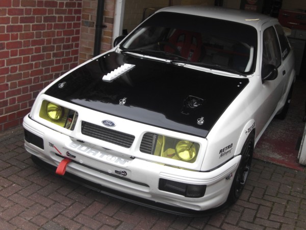

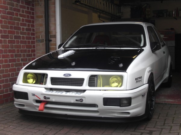

          Right as you can see the cars had a little freshen up. Doors, bonnet and new grille have been repainted (grille and drivers door replace the old, rather bashed in items). While Ray painted the panels I got busy removing the rest of the black stripes from the car as they started to look a bit tatty. Luckily they weren't 2 pack like the rest of the car so they came off with thinners, cutting compound and lots of elbow grease.
          I fancied a black bonnet to keep the theme but have had enough of matt colours so got Ray to give it a coat of gloss. Looks amazing when its not covered in dust.
          Grille is fibreglass as old one came off in three pieces and it sits on nice new lightened brackets.
          Scheme will be finished off with all of the relevent sponsors decals soon enough.

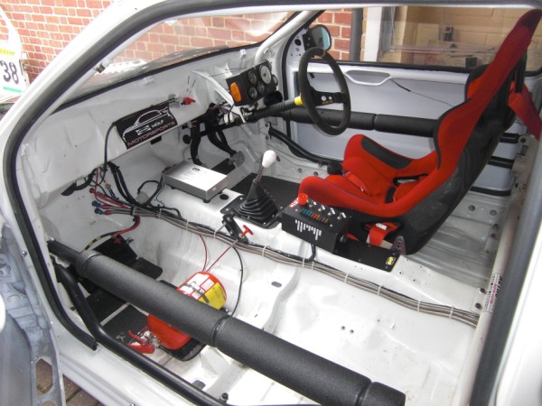

          Proof that there is a complete drivers door, window and mirror for the first time in ages.
            Big thanks to Ray and his son for the paint work. Not bad considering the car hasnt left the garage Will get it up to him for a mop to give it some shine soon.
            New drivers door from inside. Might need a new outer rubber as the one on there now is a bit ripply from being driven up

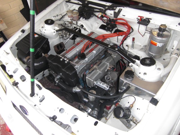

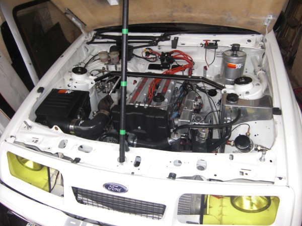

                      Current set up with the mocked up engine bay;
                      Once I have a turbo I can refit exhaust system and make a heat shield.
                      Any pointers on installation of the turbo lump appreciated, I'm still learning
