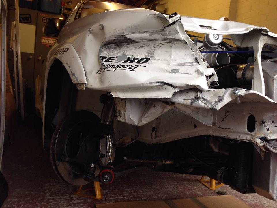

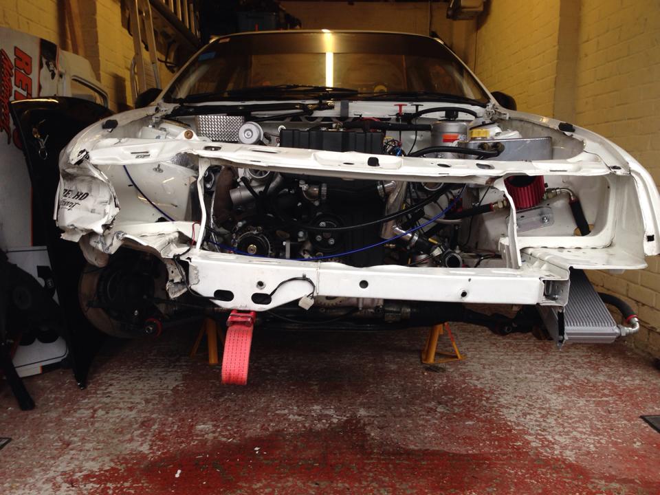

        Cheers Ian, as you say no one hurt and car will live again. The whiplash is easing slightly too now
        Gives you an idea of the amount the front has moved

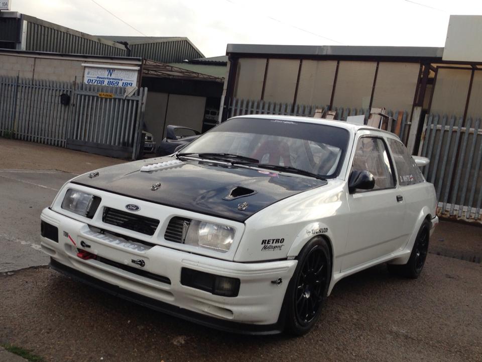

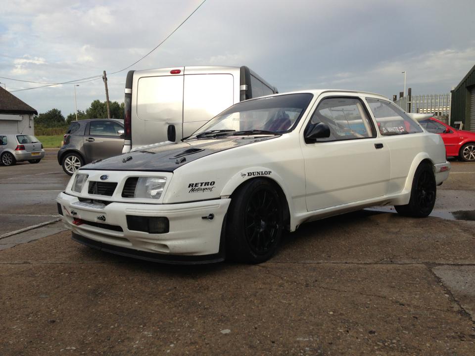

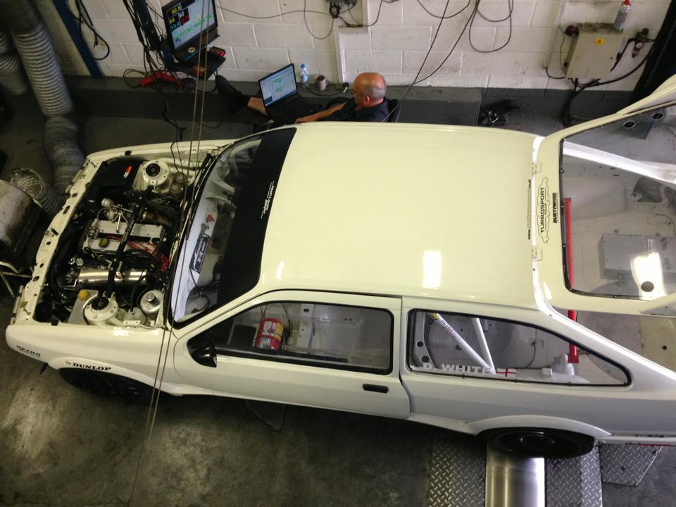

            Some rolling road pics from before just to cheer the thread up a bit, what a great day and a superb showing from the new engine.

                Gutted for you after all the effort you've put into the build but glad to hear you're still keen to get it straight again.
                Its no consolation but the car looks great in the rolling road pics.

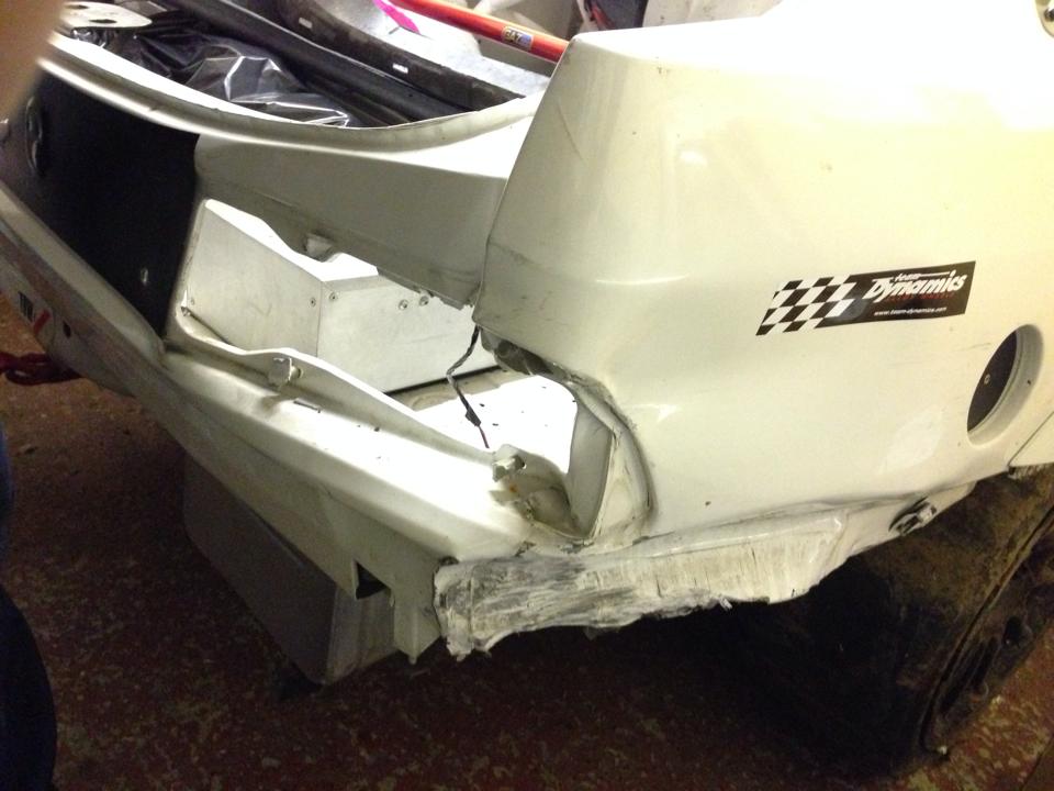

                  Was a sad sight for sure you also left the rear beam off the list of busted bits
                    True, hard to tell if the rear of the car is bad, front looks worse than it did at brands now its all stripped. At least I have a whole new rear end to use anyway

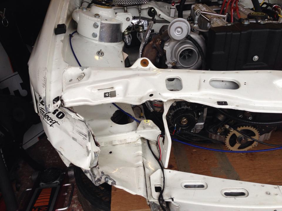

                        sorry to hear mate as long as your ok its part of racing, them strut braces don't do the chassis legs no good on impact but chin up it looks lovely in the pics like the air jack tanks lol

                            Strut brace did bend a bit but it was the rad crossmember that took the impact across to the n/s chassis rail. As you can see end of the o/s chassis rail was the point of impact and the whole lot got pushed over 2"+ bending the n/s wing badly that hadn't even touched anything!
