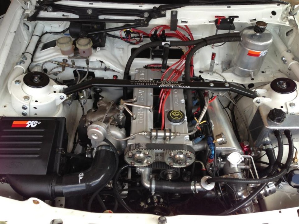

    Breather pipes on, throttle cable now converted to race type as std one wouldnt fit and was a bit short, plugs fitted and heat mat bought to start shielding everything on the hot side.
    New 3 bar map sensor fitted and plugged in too
      Thats looks just so right! Simply at home in there nice work! Have u booked it for rollers yet?

          Looks fantastic mate, very smart as usuall . Who are you getting to map it for you out of curiosity?
            Cheers, going up to Track and road as Ive used Steve Greenald for years and its only up the road.

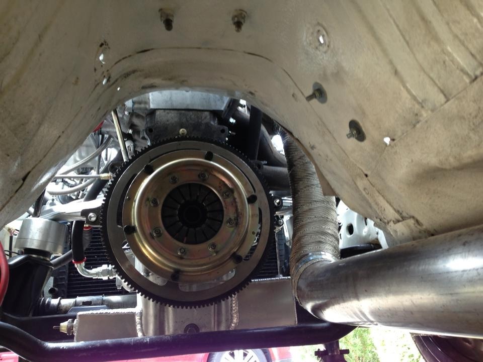

            Got exhaust manifold lambda boss welded thanks to Frank Frostick, fitted some titanium heat wrap, thanks to the Mrs! and got the downpipe and system all fully fitted. List is getting smaller!

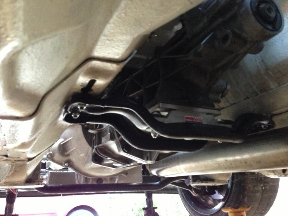

                    Gearbox in, prop in, new starter almost made and template for heatshield made.
                    Might modify heatshield as I go but for now at least I have somewhere to start. Have a sheet of nimbus heat shield to make it with which is easy to form and very light.
