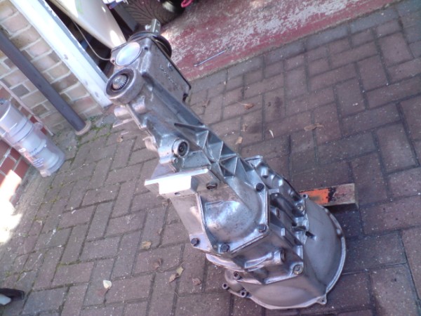

                The engine will have slightly higher c/r, a T3 or T34 turbo, 2wd manifold, baffled sump and maybe cams. In other words little or no lag! The other advantage of running the YB is that the T5 box will be a lot less stressed than the type 9 tranx box so with this in mind I have already purchased a nice T5 from an equally nice TS member and soon the type 9 tranx box will be for sale.

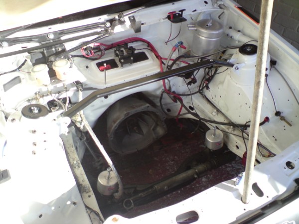

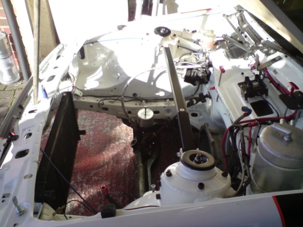

                  I've spent the weekend adjusting the car to suit a YB turbo installation. First of all the dry sump tank etc was removed, the engine mounts put back to their standard position and the rad moved back to make room for an RS500 intercooler.

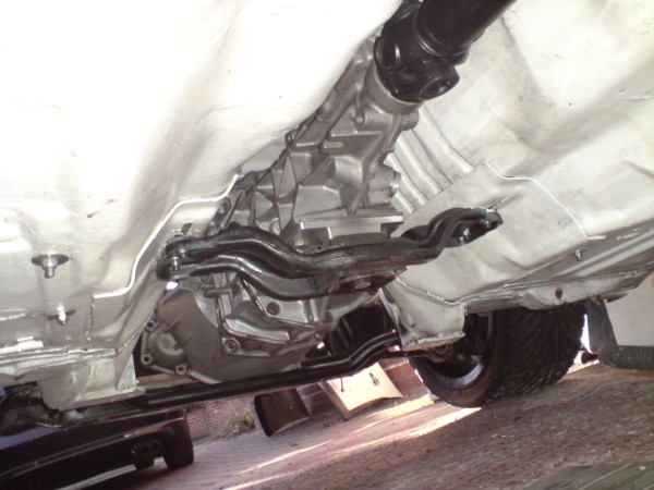

                  Then in with the T5 box that I picked up earlier.
                  The T5 slotted in nicely as you would expect and i have fitted the prop so that the box now sits roughly in the right place, ready for an engine to be fitted (bare block, YB head and 2wd exhaust manifold for mocking up purposes)

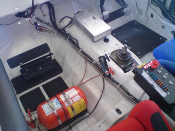

                  I have moved the battery tray to the passenger floor well to make room for the breather tank that I have, which will hopefully work. The battery just requires a bulkhead connection and a couple of foot more cable and its done.
                  I am re-using my S80pro ecu and loom with the Yb(no dizzy) and already have a crank sensor, trigger wheel and MAP sensor read to fit. If anyone else has some useful ancillaries let me know as it would be nice to get the engine bay finished fairly quickly so that I can concentrate on theengine build up.
