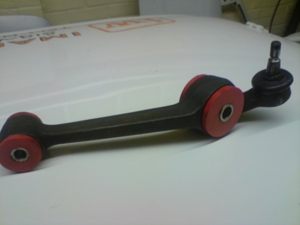

                  Can now get on with rebushing the suspension. Starting with the TCAs. After buying new poly race bushes I was suprised to find nylon bushes already fitted! Turns out though that these were just the cheap one that could be bought for road cars due to the high wear rate of the normal rubber ones.
                  Next to my new bushes the old ones looked pretty naff and the inners of the old ones didn't even have metal inserts (just drilled nylon) so were probably shagged.
                  Anway I got one side all fitted up and installed on the car.
                  Next job is the wheel bearings on the same corner (very shagged) and then I can move to the other side. I will then start stripping the rear beam and rear bearings

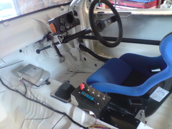

                    hey,
                    i going to redo my wiring on my car because of again an other engine the rs2000 16v engine and i want it to be a nice and easy install. I intressed in the fuse box, been looking in local race shop and didnt find anything. Been looking on demon tweeks and nothing. Could you share some info on the fuse box?
                    Thanks
                      Originally posted by Arieke
                      hey,
                      Thanks
                      The box is from maplin electronics and is essentially the same as the one used to house the gauges. The fuse holders, relay blocks and switches were all fom a local car electrical shop in London and we just cut all of the holes in the box to suit. I still have to label the fuses properly once I bring the label maker home..

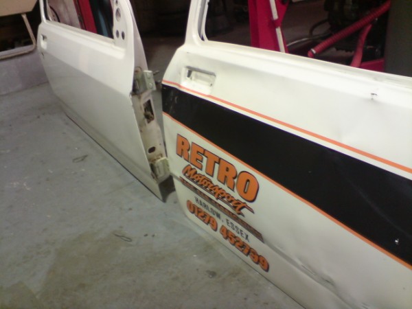

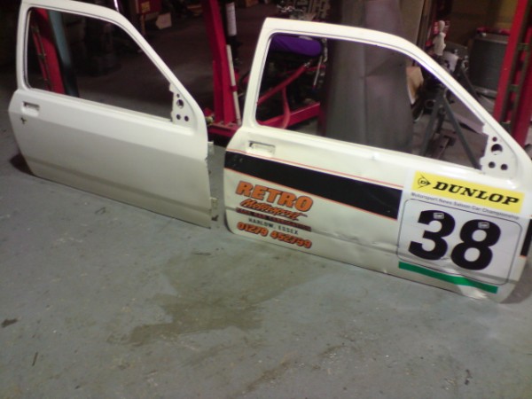

                        Got back into it this week though and changed all of my crappy pink bonnet pins for nice new black ones from Burtons, mainly cos the old ones used to get stuck all of the time. Also got stuck into sorting my crash damage out, starting with the drivers door that took the brunt of it.

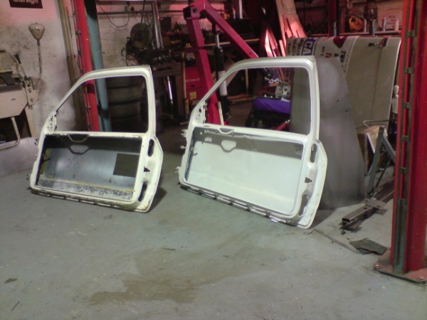

                        Went to Garys today and stripped down the standard door, drilled and swaged a few lightening holes and removed all of the inner panel. Gary then welded in the strengthening tube that incorporates the door handle.
                        It all came out well and should match the pasenger door nicely. Just need to get a drop of paint on it now and new decals

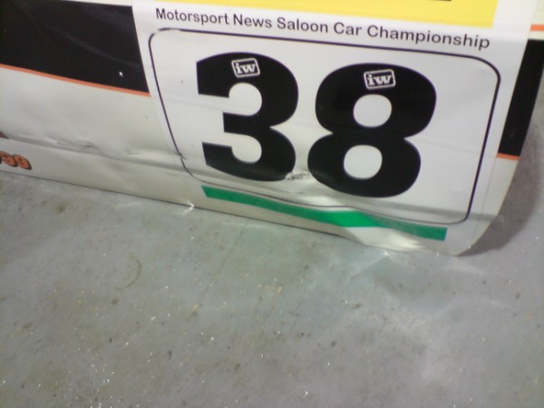

                        Some of the damage even though the door had been 'straightened out' quite a bit.

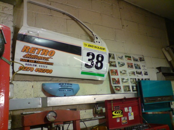

                        Gary now has some new art for his gallery. The blue heater bowl under it is off of my old car.
