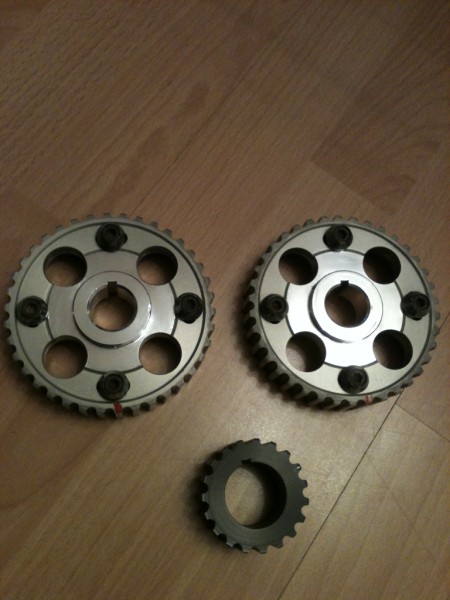

          There was one little car related update. Santa just brought me these;
          A pair of cosworth vernier pulleys and a billet cossie crank pulley as the std pinto one doesnt work with the newer style (rounded teeth) cam belt. I also have a std cossie/cvh cam pulley to use as the aux pulley. This will be fitted to the aux shaft that Graham modified before, which has no oil pump or dizzy drives.
