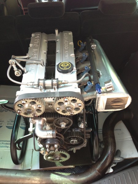

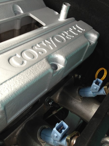

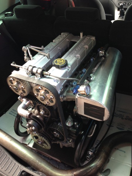

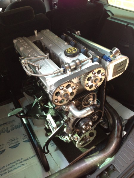

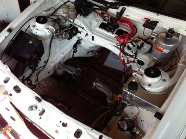

    After a couple of days of tinkering the YB now looks like this.
    Virtually everything is bolted in apart from the alternator and exhaust. Will bolt turbo on once its all in the car
    Now has all new breathers, G19 plenum, 'dizzyless' dizzy, turbo oil feed, new dipstick, alternator drop bracket, turbo damper etc..
    Next step is to drop it in and get the plumbing finished off

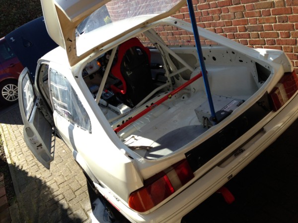

          got hold of another 3 door rear beam. The arms etc should be useful as spares but the beam itself is supposedly modified by graham hathaway with most of the holes moved for better geometry. Time will tell but i wont swap the beam until the diff comes out for a new ratio later in the year.
          that beam is my spec and modified for me on graham hatherways. I would swop it straight away the difference it make is quite a bit david it will help with wheel spin ,tramping when coming out of corners and the hadling is brilliant ,just a little tip its worth swopping
            Thanks Joe, well worth knowing.

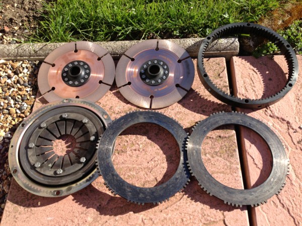

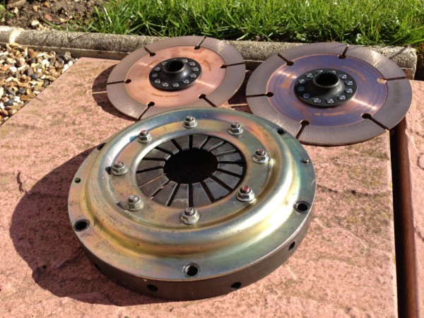

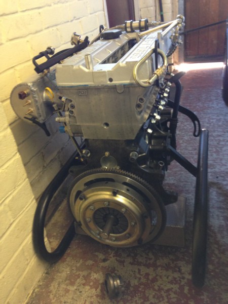

              More progress this week. After having had a twin plate AP clutch so kindly donated to the cause by Graham I bought a new pair of plates from burtons and assembled everything ready to go on.
              Everything went together nicely to with some new bolts and a type 9 input shaft I got everything fitted to the engine.
              I have a good race release bearing, new modified cable so hopefully thats the clutch sorted

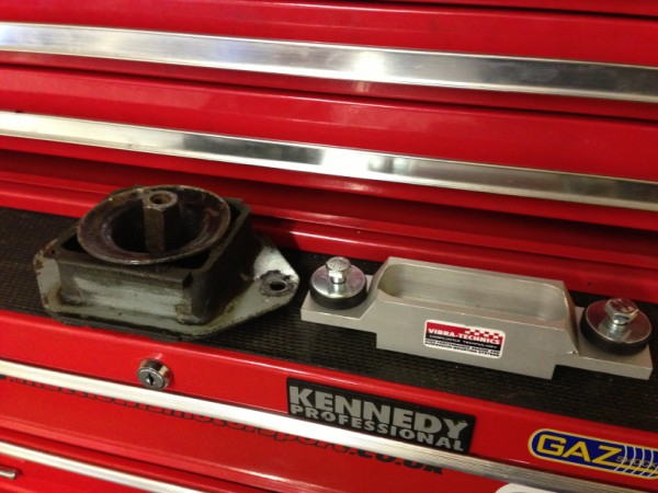

              Also replaced knackered gearbox mount with a vibra technics one. Hopefully gearbox is all ready too

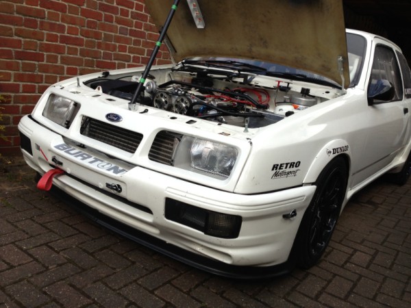

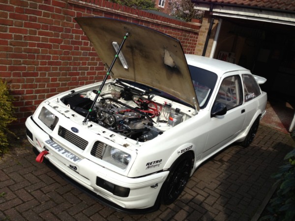

                Yesterday went from this...
                ...to this

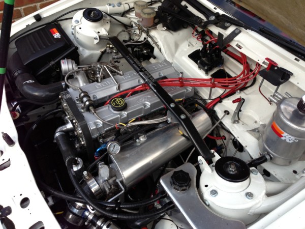

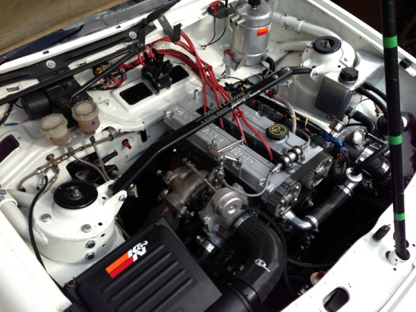

                  Some more pics from yesterdays effort, even gave the car a quick wash once it was all done
                  Still got to fit gearbox and starter, clutch cable and throttle cable (which I'm gonna have to modify or replace)
                    Quick recap of what went in yesterday along with the engine;
                    - Alternator and belt (as before but with drop bracket)
                    - Exhaust manifold, with all new aerotight nuts and new studs
                    - Turbo, nut and bolted with aerotights, damper fitted
                    - Inlet, throttle body and dump valve
                    - All coolant hoses and swirl pot
                    - All fuel hoses
                    - All boost hoses and air filter
                    - Most vacuum hoses
                    - New magnicore 8.5mm leads
                    - Strut brace
                    - Turbo oil feed and all oil pressure lines
                    - Oil cooler hoses
                    - Engine loom all plugged in
                    - Amal valve wired and piped in
                    Jobs to do next;
                    - Turbo drain pipe (forgot!)
                    - Fit map sensor
                    - Fit clutch cable
                    - Make throttle cable
                    - Fit gearbox
                    - Modify pinto high torque starter with new baseplate
                    - Buy spark plugs
                    - Start heat shielding, lots of heat shielding
                    - Breather plumbing
                    Busy couple of weeks then lol...

                      Certainly looks like you been busy and things are moving along well now , and look forward to the post when its all ready to fire up the new engine
                        Thanks Ian, yeah progress has been pretty good thanks to mocking everything up prior to getting the engine. As usual though the obvious stuff has gone in really quick and it will be the little details that cause holdups, but so far so good
