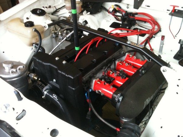

        However on a different topic I've been making my non-cheating 16v pinto a bit more comfy by fitting a cambelt cover..
        Along with the airfilter being refitted I'm hoping the cover will make the engine a bit safer should it see a gravel trap. Its easy for the gravel to break a cambelt so although this cover isn't exactly a tight fit it might at least give us a chance of keeping the kitty litter out, just incase I push a bit too hard fending off Graham
        That looks very smart!! I like it alot, very clean and wise. Looks like a factory touring cars bay.

                Started to do a few bits on the sierra again over the weekend so thought I'd post a couple of pics just to show it hasn't been too neglegted.
                Have fitted some new light covers as I no longer needed the air ducts (were fitted for going turbo) plus they tone down the very bright headlights a touch so as not to blind other drivers
                Have also fitted a perspex plate behind the centre grille which blocks most of it off as it is there mainly for an intercooler which I obviously won't need. I have left some open grille where it feeds a 75mm induction duct but most is now blanked.

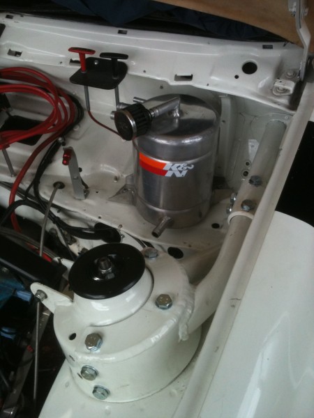

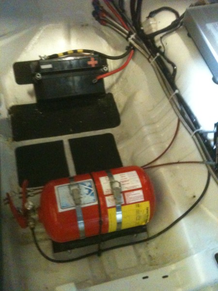

                    Got a couple more bits done this week including getting the catch tank into position which in turn meant moving the battery inside the car, onto the passenger footwell. The battery is all fitted and the Pipes made me up some new battery cables which now run neatly from the bulkhead down to the battery. Will try to get pics tomorrow.
                    The catch tank is an old cosworth race car breather tank which I have altered slightly to be just a catch tank. The return outlet will be blocked off and used as a drain to empty the tank, the inlets at the top will connect to the breathers from the engine and the dry sump tank. Gonna try to make a sight gauge too. This set up came from an N/A cossie sapphire race car so should work fine.

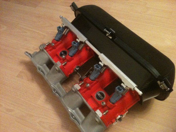

                    Also spent a while playing with the Jenveys as I had a pipercross backplate to fit a filter on a pinto and a carbon dished backplate from an mi16 lump. Neither are close to fitting the yb spacing so I cut up and reversed the ally plate and then trimmed it down to fit behind the carbon fibre which I had cut the guts out of. The result is for next to nothing I have made my filter fit the jenveys on the yb manifold and also made enough space to run 90mm trumpets in place of the 45s I could fit inside the filter before.
                    I also got a new jenvey fuel rail from Burtons and fitted up my vxr injectors.

                              This is the battery install, still a little tidying to finish.

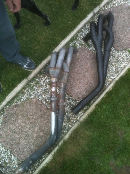

                              Also won a cheap ashley manifold, I know its not the best design in the world but as I say it was less than a quarter the price of a Tony Law and hopefully it will get the car done quicker. Shown below is the ashley 3 piece from the pinto which Gary modified and my YB one (black) Hopefully once I have a head to test it I can get a good fit using one or both manifolds for parts.
