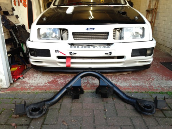

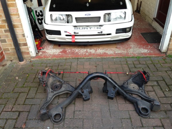

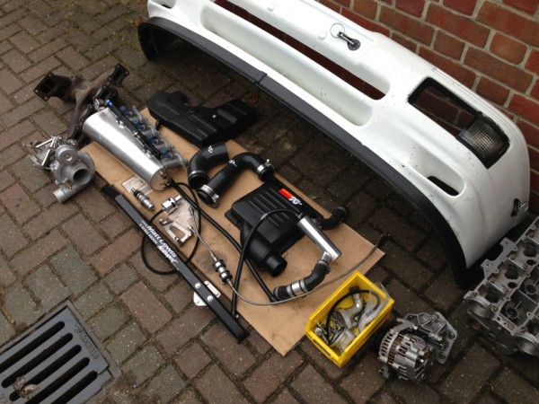

                  Got hold of another 3 door rear beam. The arms etc should be useful as spares but the beam itself is supposedly modified by Graham Hathaway with most of the holes moved for better geometry. Time will tell but I wont swap the beam until the diff comes out for a new ratio later in the year.

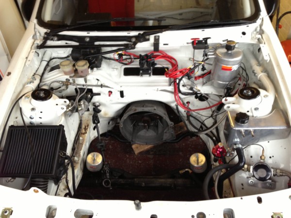

                  Have stripped out the engine bay ready for the new YB which shouldn't be too long now. Have got several new ancillaries for the engine and only really need to make a heat shield now and apply some heat matting to the bay.

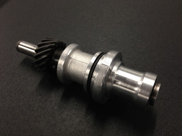

                    Made another oil pump drive from a dead distributor, this time a genuine marelli YB one which came out a bit better than the pinto one;

                    Cant wait to get the engine back, get all of the bits bolted on to it and slot it in ready for mapping

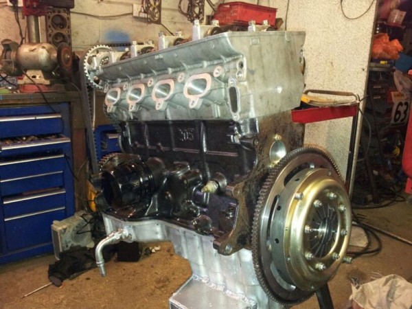

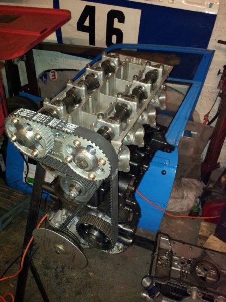

                              Some pics of the engine at grahams, almost done..
                              Complete with 'Doug' G19 sump, lightweight flywheel and twin plate clutch

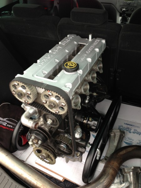

                                Collected in the week, ready to bolt some goodies on...
                                Massive thanks to Graham for getting it all done and to such a high standard. He's had a lot on his plate lately but he's really put some hours into Linford Jnr
