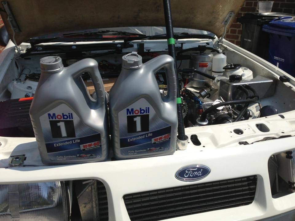

    I use Mobil 1 10 w 60 Motorsport oil in mine Dave as reccomend by Joe
    Thanks Ian, I was going to ask Joe.
      As recommended I got some mobile 1 Motorsport oil and put that in today.

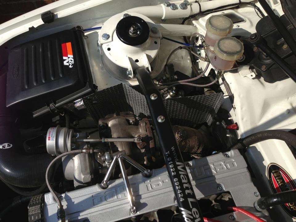

      Also filled up the coolant and had a little scare, water gushed out of the back of the head! Turned out to be a hole that needed blanking. Checked my 2wd head and that hole isn't there so I nicked one of the grub screw blanks from the oil way on the rear of it. Fitted nicely in the water way with some thread sealant and brimmed the water, and so far no leaks!!

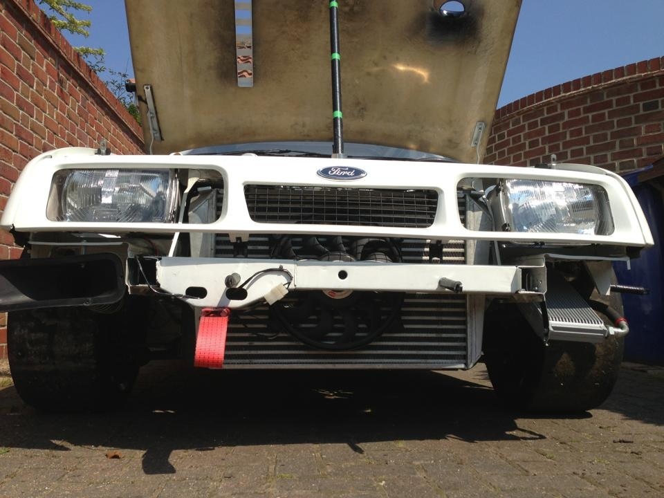

      Got my fan fitted nicely and wired in, just clears the front xmember perfectly.
      Also started making a heat shield from nimus ally sheet. The side is done and the top will be attached to the strut brace for ease of access
      Tomorrow will fit the starter and if it works I should be able to get up a bit of oil pressure without the ignition on. Next will be to connect the tps, get a rough map in there and see if it runs
