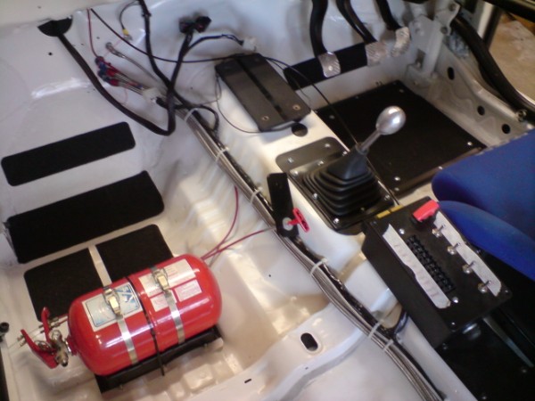

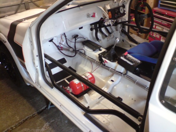

    Steady progress continues, we now have the extinguisher fitted along with its cables, just waiting for some new pipe to plumb it all in, which is pretty straight forward.
    Also fitted the drivers floor plate to raise the floor by about an inch. This is covered in grip tape and I've also stuck some of the tape to the passengers side to keep the floor tidy on that side for when we have a passengers seat on trackdays.
    Pedals are all fully operational now and final fine tuning of the throttle and clutch cables is complete. The brake pedal now has its clip and spacer fitted to the pushrod and brake pedal feels perfect

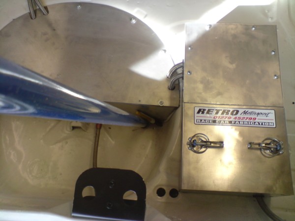

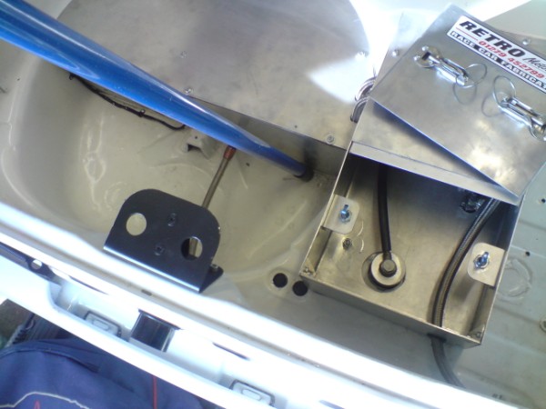

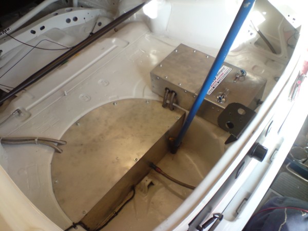

      Andys Dad John has made a box to cover the fuel lines and fuel filler in the boot. The push on fittings and filler neck are not allowed to be open inside the car so this box seals it all off nicely.
      We have now tested both the low and high pressure fuel systems and apart from one braided line doing a good impersonation of a spinkler system (duly found and replaced, thank god ) all of the fuel system operated well

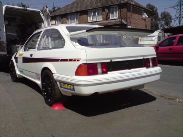

      The black bracket on the rear panel is to support the weight of the whaletail via a rod bolted to the bottom of the tailgate.

              Be good to have a see your car there although I may have to remove my whale tail so that i can see you getting smaller

                          A bit disappointed at the whale tail and lack of povo-spec grille though

                            I get out voted on these sort of things but I do like the look with both grilles. The whaletail is quick (ish) release so that we can test with and without it

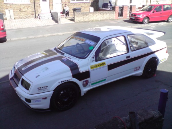

                              Well she had a bit of a road trip today, well to the pavement at least We got the doors back on, windows and sliders in and the final cut out pull fitted.
                                Windows went in a treat after a bit of trimming and we also went to Burtons and picked up a couple of silencers and a load of 2.5" pipe and bends. Hopefully enough to build a system.
                                We were going to recycle my old ashley 2 1/4 system from the zetec escort install but we couldn't get the bends we wanted apart from 2" or 2.5" but as it worked out the silencers we've bought look a better quality anyway and as they are new should last a while
