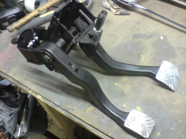

    Cheers Kev, don't worry too much for the moment though as not sure what we are doing now. We were looking at it yesterday and I think we're gonna make a bracket that bolts to the pedal and use an M6 bolt as a pin. Should be nice and strong that way

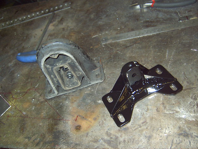

        With the new diff mount and the solid beam mounts the back end off the car should be miles better

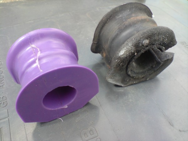

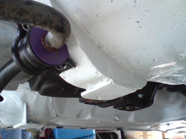

          To tighten up the front suspension I've added some poly anti-roll bar bushes to replace the old rubber ones;
          Fitted on the car, note I also fitted M10 capheads as the origional M10's only have a 13mm head and are easily rounded off.

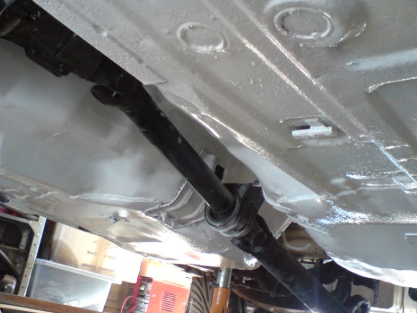

          As you can see most of the floor has a coat of paint on it now which should help it to last a bit longer

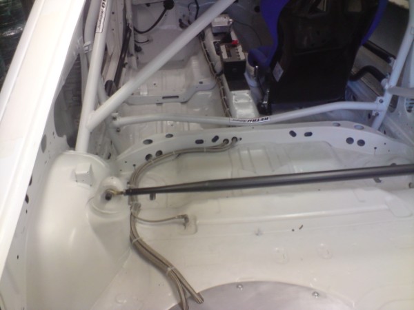

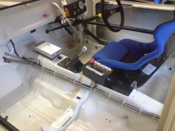

            Andy and Alex got the rest of the fuel and brake lines in along the tunnel yesterday and most of the fuel system is complete now. Just need to get a fuel regulator and make a cover for the exposed filler neck and pipes on the boot floor.

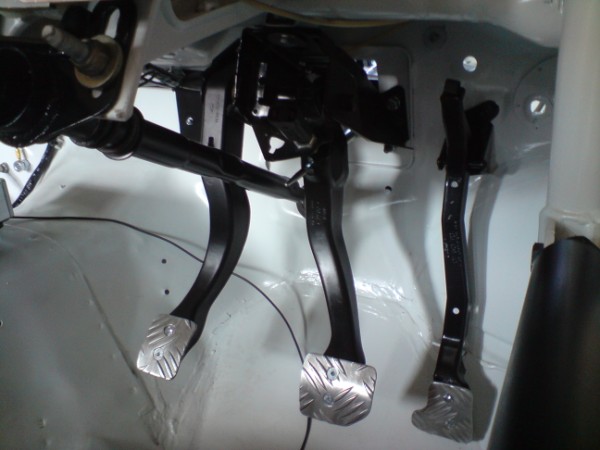

            It looks like John (Pipe) has sorted the clutch pedal too by making a bracket to come off the top that has a pin threaded on both ends for an M6 nut keeping it more secure than a std setup. Will get pics tomorrow.

              Fuel lines and brake line in place
              Sierra pedal box with modified escort clutch pedal. Distance between the pedals is still the same and the new cable holder can be seen at the top

                            We also slightly modded the prop mounting for a better fit and got it nicely painted.

                              Pedal box all fitted, just need to fit stops and springs to it now. We are also missing the square circlip that holds the brake pushrod to the pedal. I must have left it on the old servo setup which has long since gone
