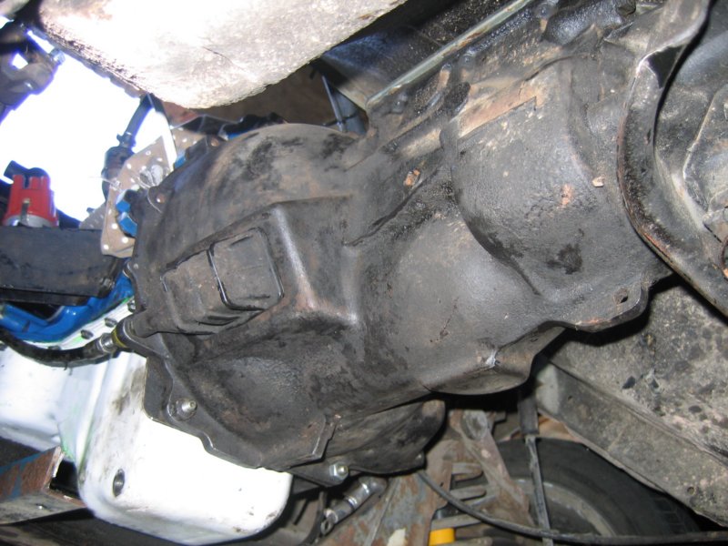

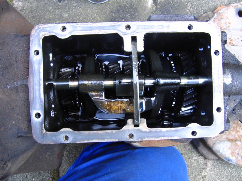

              A 4 speed gearbox from a 2 liter pinto primary shaft is 1 x 23 splines. So a type 9? in a car manuel its a Type B so ...
              Day 2

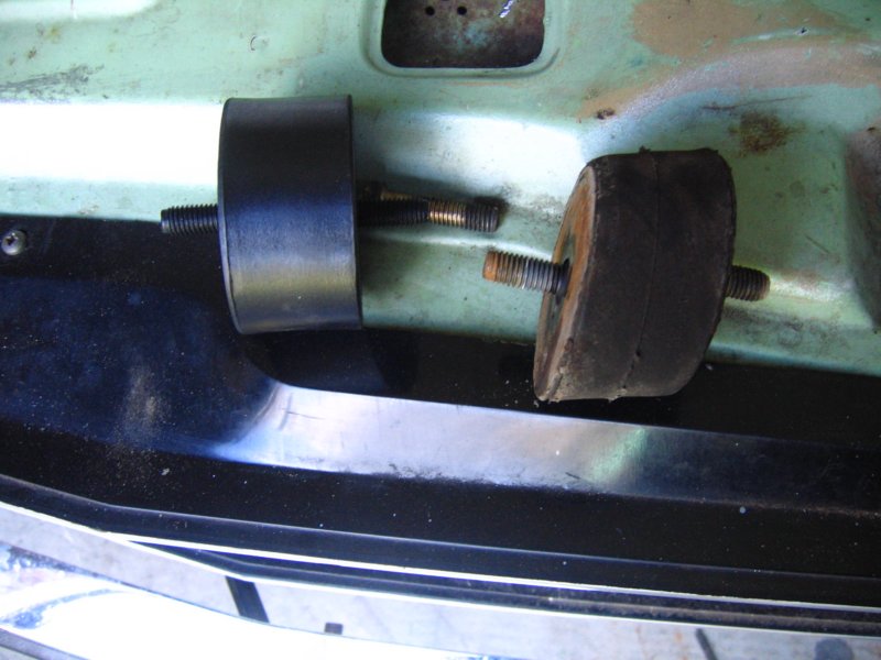

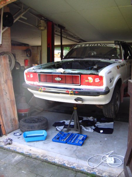

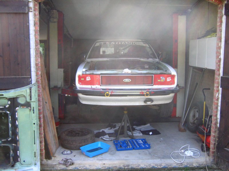

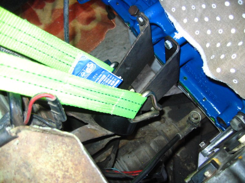

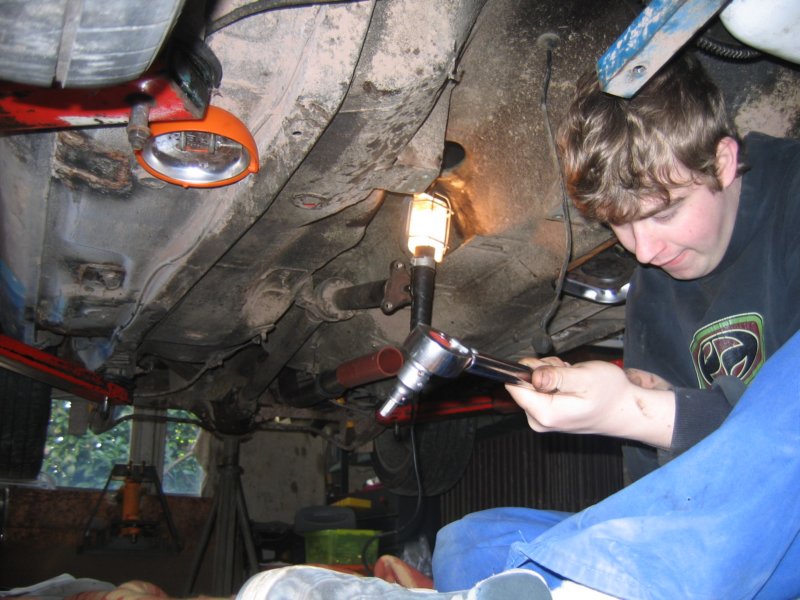

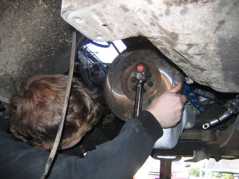

              I did some more work, installed new engine rubbers. A friend of mine helped out so i didnt have to install the gearbox alone. (its fairly heavy ) We mounted they flywheel, with cossy bolts, clutch and pressure plate. And gearbox went in. installed the propshaft and adjusted they gearbox so it works. So thats done,
              Here some pics
              New and old rubbers
              Me pulling bolts on strengt.
              Using my dads torque wrench.

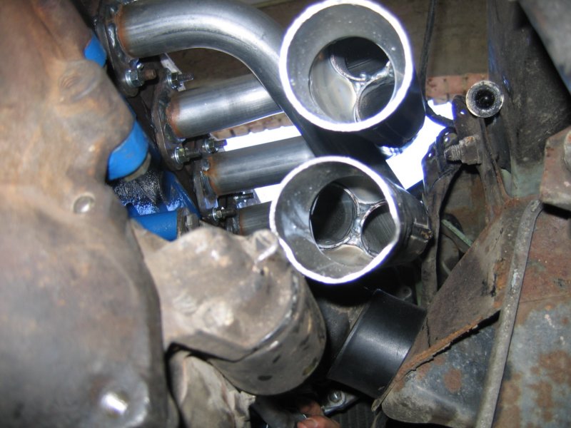

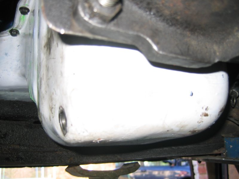

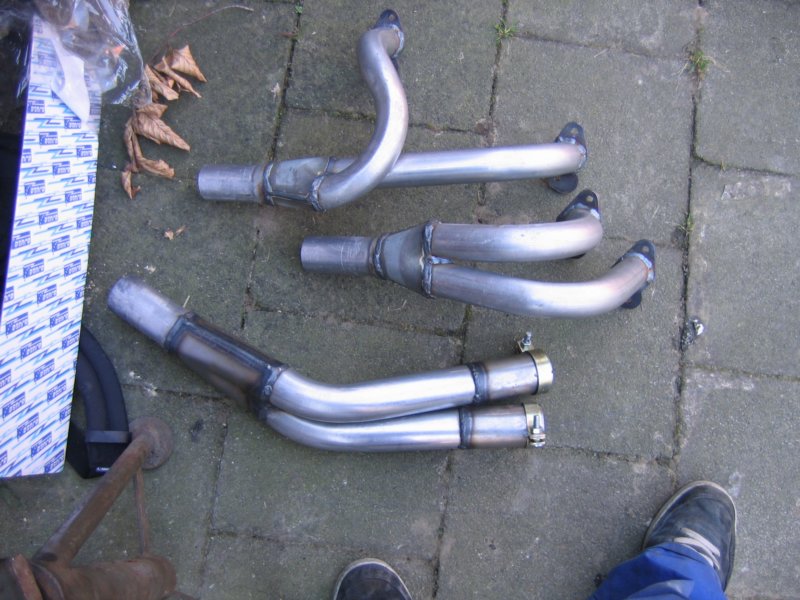

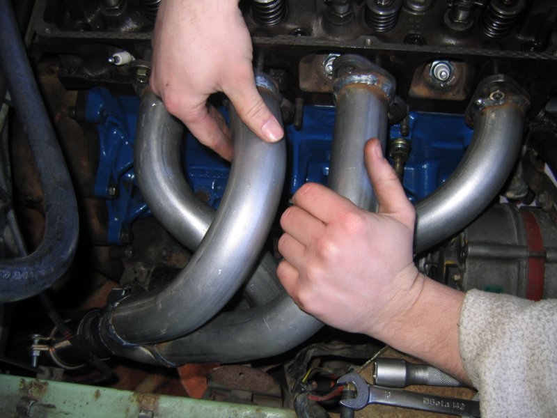

              I bouth a Big exhaust, Ashley exhaust manifold: MK2 escort 2.25" bore. The students told my that they will make it fit. But they didn't. They problem we had was ...
              First some pics
              Normally there should be a big wing sump but that went wrong so i'm stuck with my origenal sump.
              nice but ...
              So the exhaust doesn't fit. My day was a over, didn't touch they car for couple days, they we had a other go. Pics will follow.

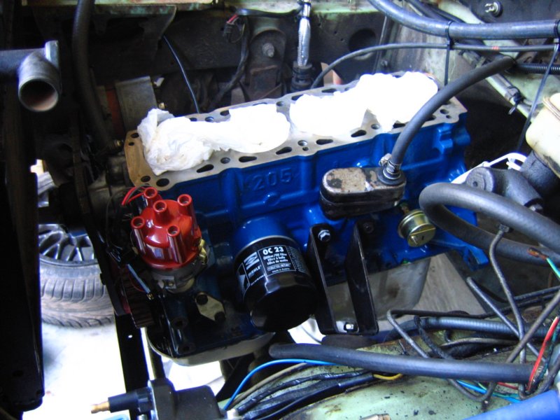

                Did you find where the oil came from
                I did, the fucking idiot who put the oil filter on, forgot to place the rubber between the filter and block. If i see that guy i bash him.
                How stupid can you be???
                It stopped leaking so that was the problem...
                But i cant get the engine to start on the starter motor. (standard starter motor) and i have a CR from 11.5 When i jused the starter with 24V. Then it does 1000 rpm (with no spark plugs) but when the spark plugs in, the engine does (300rpm) But I dont think thats enough to start the engine. I think i need to buy a edge starter engine from burton or so. But not sure ...

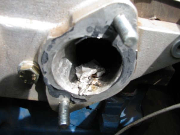

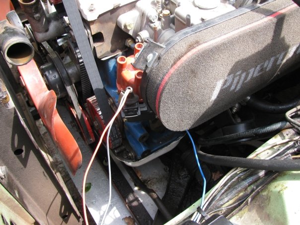

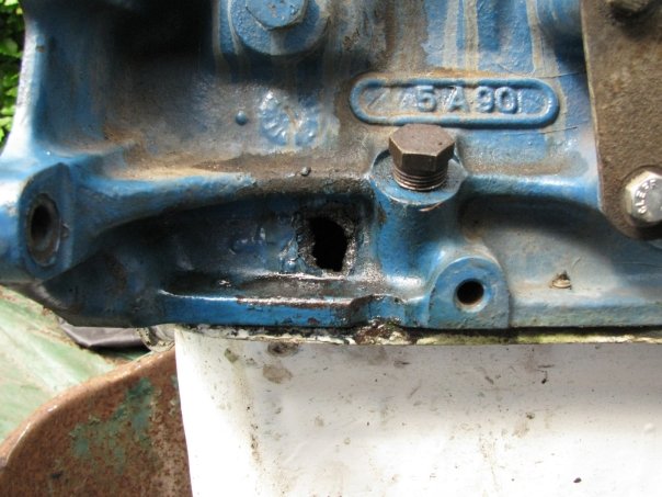

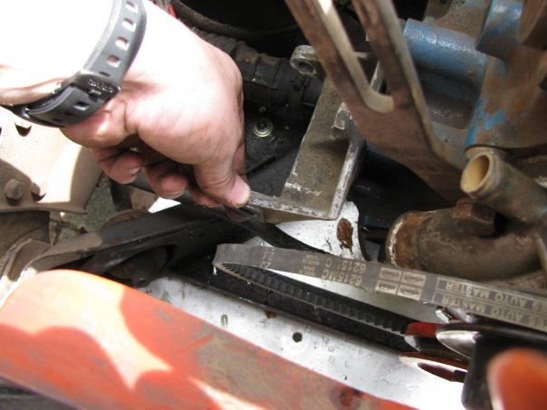

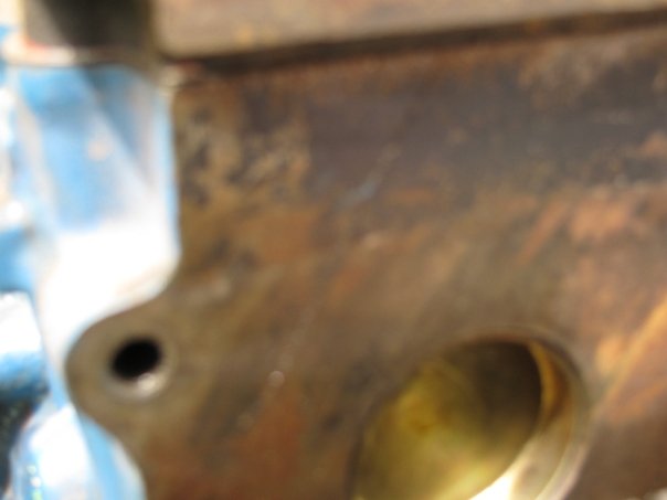

                      My f*cked up 2100 Pinto
                      Here is the update about my broken engine ....

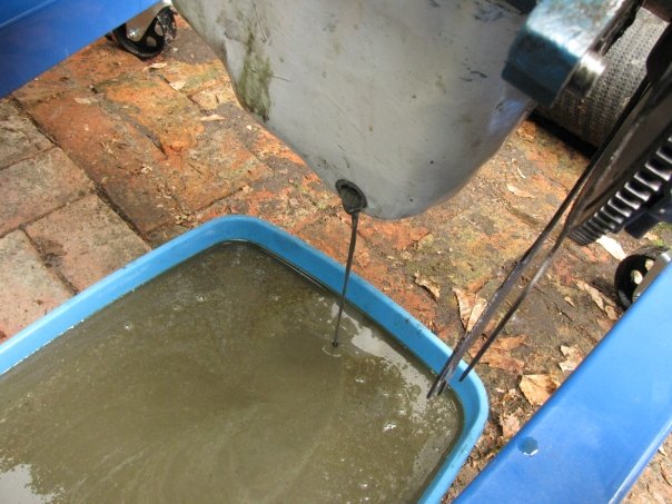

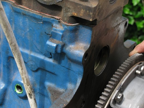

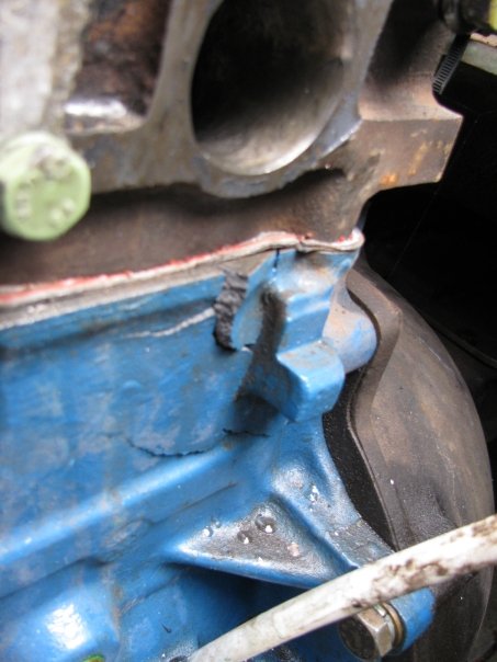

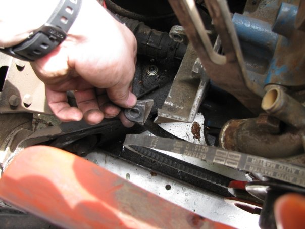

                      Somehow the alternator bracket broke off.
                      This look like pieces from a valve, not sure because, it could be from the piston, i had simelar crap in my air filter, luckelly my webers aren't damaged.

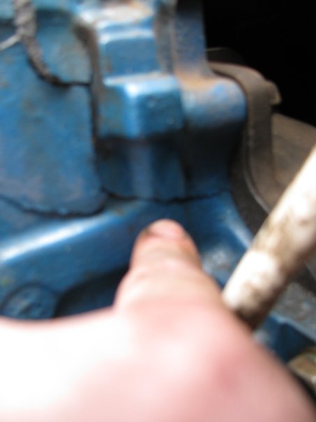

                      What a f*cking big crack
                      Whole that piece is kept at place with the head bolts, I think it will brake off when the head is off the block ...
                      This crap came all out of the sump, no water on the radiator, but i can see why.
                      I can tell, the fourth piston is totalled, the block also, I don't feel like taking it apart, when i do, i will post pics ...

                          Originally posted by SANTA
                          Thats a big crack ,I did that to my laser once not a good feeling at all.
                          hehe, I had alot of expensive stuff in my engine ... Hope some is still useable ...
                          • Group4_Mark2
                            • 1782
                            #28
                            That looks nasty. You should take it apart anyhow and try to find out what caused the problem so that hopefully it does not happen again.
