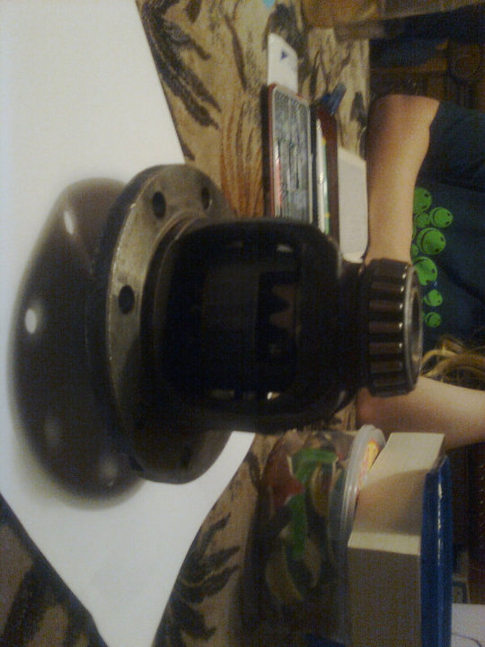

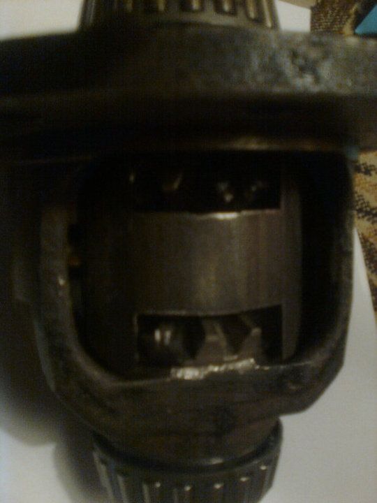

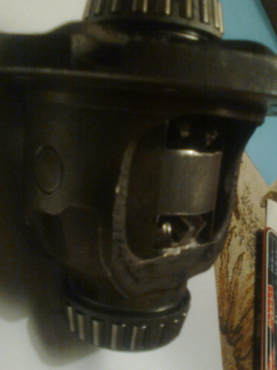

            So I got my new diff back, it is I think stronger then before. We made 2 flat sides on the satelite wheels en made a metal piece and placed it in the satelite housing. And the rod that holded the knackerd satelite wheels in place, we used it again to hold the metal piece in place.
            Pics:
            I had a go with it, Its been tested and it didnt break yet, I dont assume it will break. If something now breaks, it will be the half shaft or the whole housing.

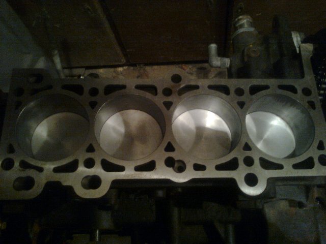

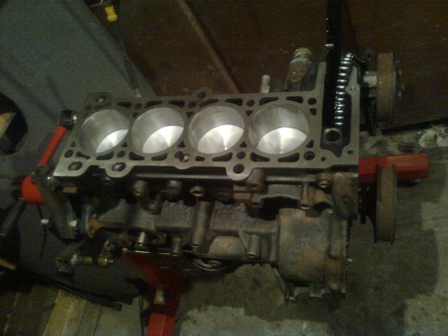

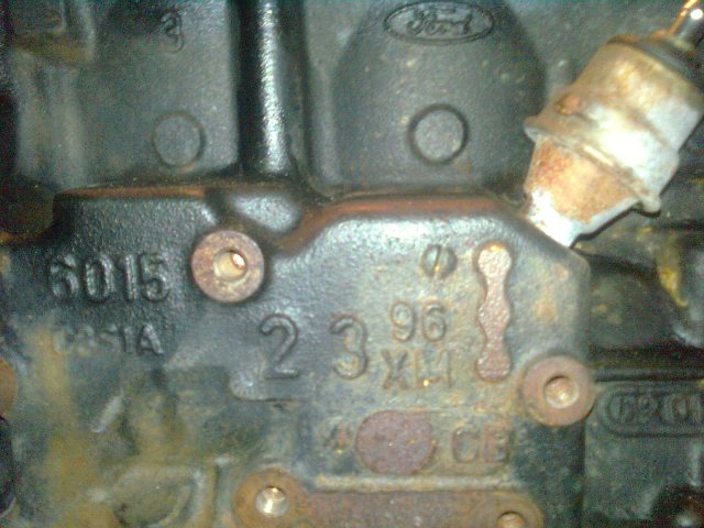

                            A scorpio 2300 block with sump from a 2.0 DOHC from a sierra because then i can remove the balencer shafts. less weight more revy
                            Using a Rs2000 head with RS2BP300H RALLY cams, (these are the latest cams you can use before getting rid of the hydrailic tappets) and adjustable camshaft sprockets. and a moddified pinto dizzy from H&H.
                            Took of 1.3mm from the pistons, because cr is to high if you use rs2000 head you get 11.8, what is nice you i had forged pistons and better con rods. But thats a bit to much for the standard pistons. the rs2000 had 10.3. I'm hoping for 10.6 - 10.7. But I don't know much cr they can take so trying to do a safe build.
                            Thats all for now i think.
