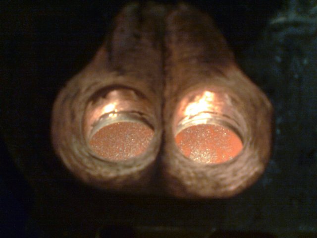

        I Did some porting work on a test cilinderhead. Not sure of its any good but, first time.
        Before
        After
        It does look like an improvement.
        Don't know if this actually does something, This should be the top from the port. My dad said it wont make a difference so, I don't know. Advice welcome

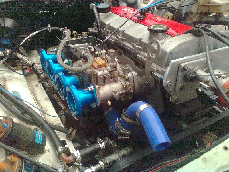

                        Here some pics:

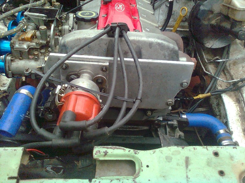

                        The aldon intake from the 2.3 new matched with the I4 RS2000

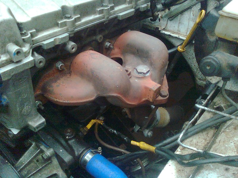

                        Distrubitor from the 2.3, This was a pinto dizzy modded by me, to fit on the engine. Is a HAL, from H&H. Maybe a side cap for the distrubitor would be nice thing.
                        The standard exhaust lump from the 2.3 engine. I had a 4-1 on the RS2000 engine with 1 box. But last year i changed it because the engine was to loud. I had 104DB and the limit was 98DB. So made a new exhaust line, with 2 boxes. ( actually didnt test noice lvl yet. I need somebody with a iphone for that) Borrowed the rolling road from a local Shop (LMBracing) and the RS2000 engine didnt lose hp or torque. (gained a bit of NM) . I will even use this exhaust when i fit the 2.3.

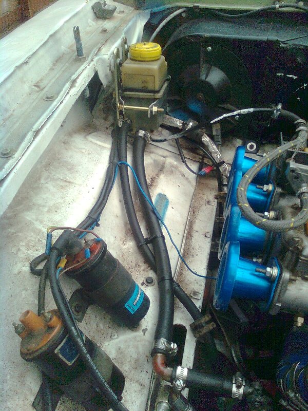

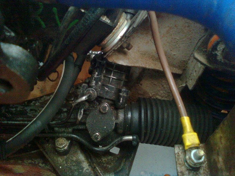

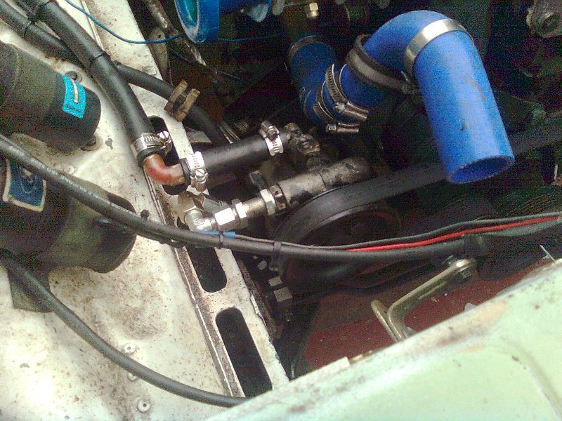

                        Because i didnt find any standard Ford Taunus with a PAS. So i had to make some thing up on my own.
                        The steeringrack is from a Taunus TC3 (Cortina MK5), the pomp is from a Ford sierra with the I4 8v lump (with a bigger restricion.) The pump has a resctiction hole from 3mm this is enlarged to 5.5mm. And the bracket that holds the PAS pump is home made. Recutted the origenal one and rewelded it. Hope it holds :-)

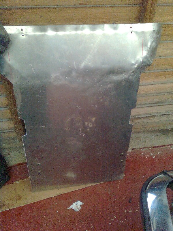

                        The new aluminium sump gard, the plastik one wasn't in good chape anymore.

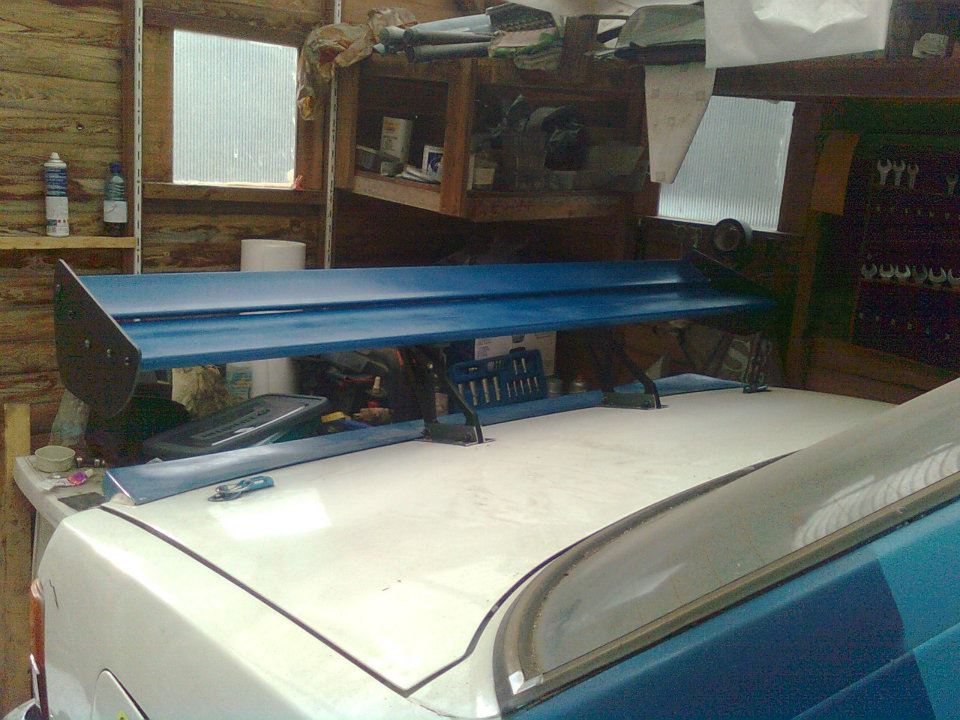

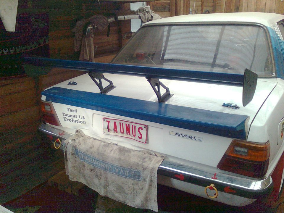

                        And a new Spoiler
                        A Double spoiler a escort mk2 one and a much bigger one.

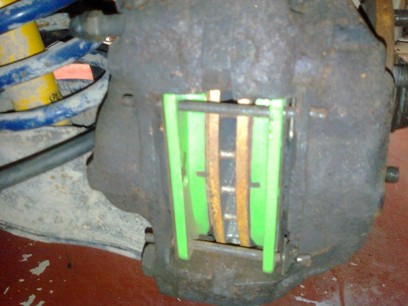

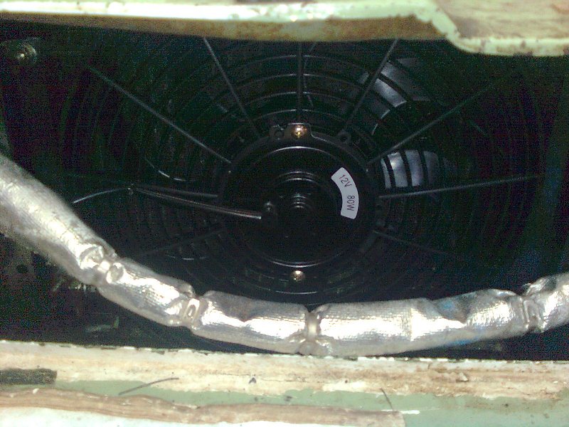

                            Because the engine sometimes overheated, I got a nice and decent fan. Now hope it does its job verry wel. It moves alot air, more then the one I had in it.

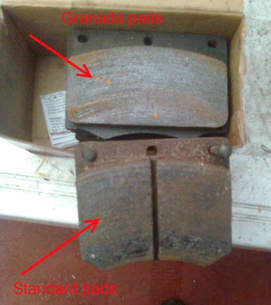

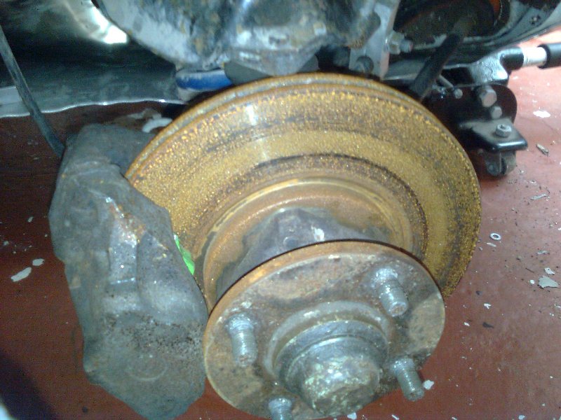

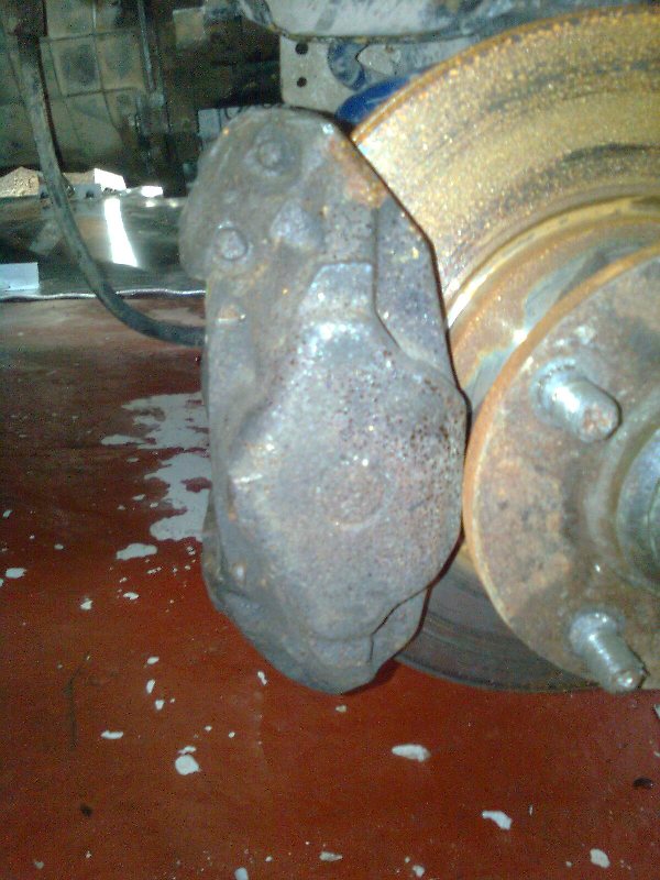

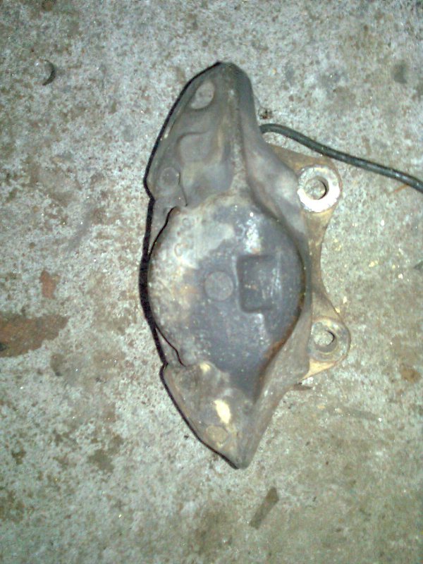

                            When I did My last race in 2010. The disks had a nice blue color, time to get some better brakes. I found in the classic ford mag a person who fitted brakes from the scorpio. But for some reason these didnt fit on my car. So these are collecting dust. Looked at HiSpec, they have a nice brakekit for my Taunus "Cortina 3/4/5- Capri 260/20mm Billet 4 Conversion" I can't get any bigger, because I sometimes use 13" up front. But srry to say a bit pricey for me. So tryed something else. Got the 2.8 capri vented disks. (the standard disk on the taunus were solid disks 240mm and capri disk is 245mm) And the 2.3 or 2.8 granada calipers. And yes, this worked! The spacer isn't right, they say 5mm spacer, but used a 7mm spacer to center the caliper. But thats not a problem. The nice thing about these is that they use the same size piston and have a bigger brake pad. (see pic) So I didn't need to change MasterCylinder. Got some EBC Greenstuff brakepads. And they look actually verry good. I hope the car will stop a bit faster :-)
                            This is the old Caliper
                            The 2.8 Granada Caliper
                            The pads. (The EBC are already installed)
                            Standard Size: 78 x 66mm
                            Granada Size: 98 x 68mm
                            Disk and Brake.
                            So Al I need to do is clean the car. See if the tempsensor is working and then hopefully keep it alive.
                            The first thing I will fo is a Drift day at zolder. on the 8th of february.
                            Anybody got some info on even better brakes, always allowed to let me know. Maybe i can get a 260mm disk on the calipers?
