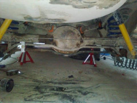

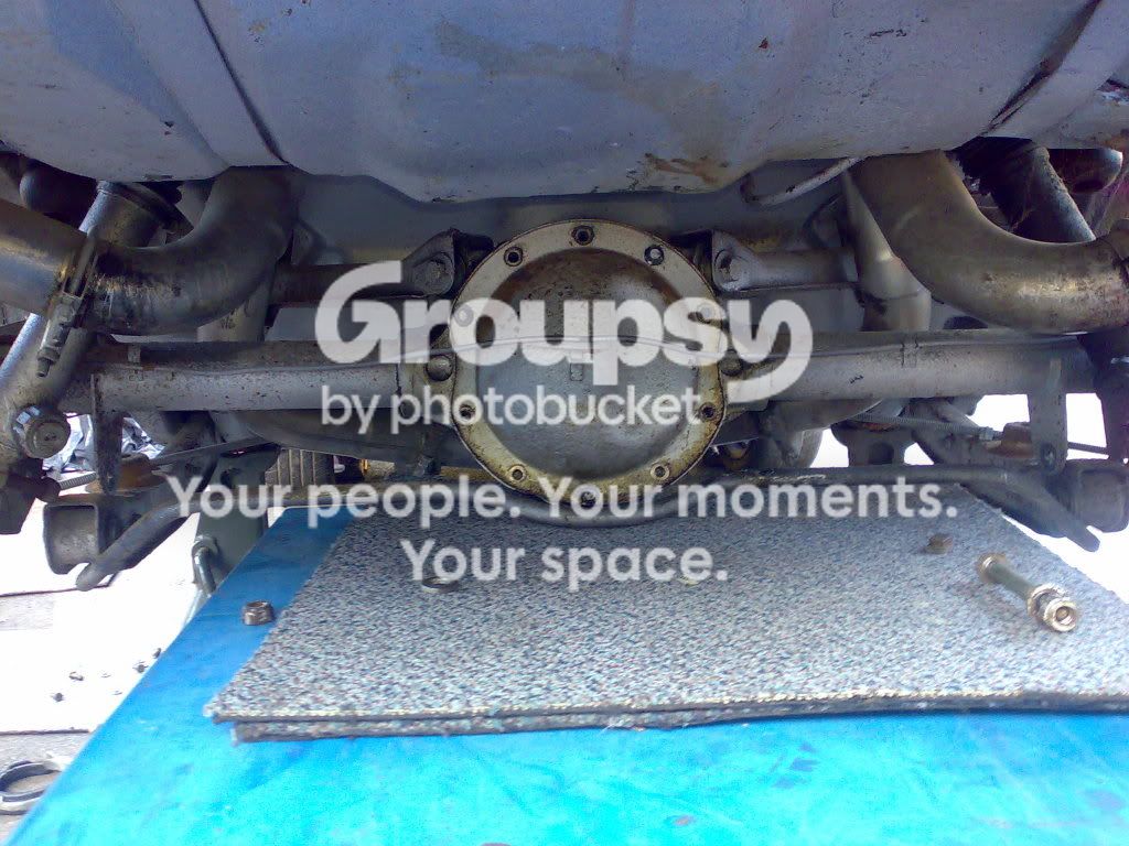

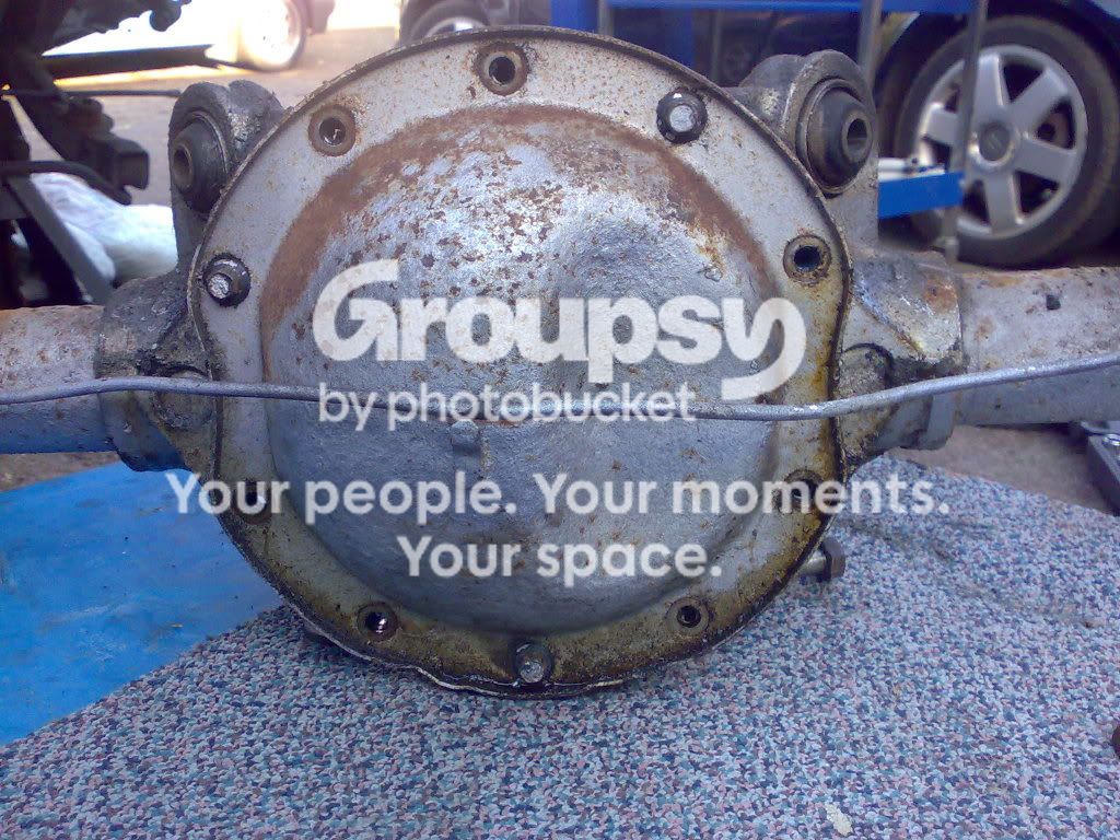

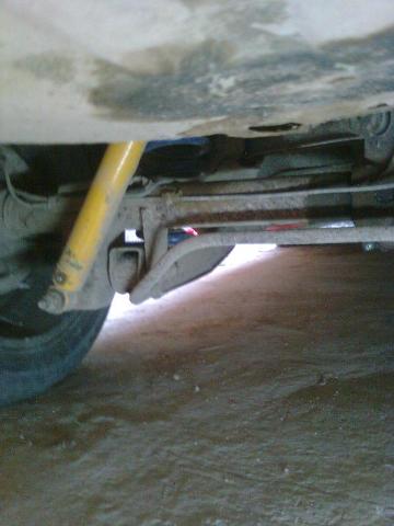

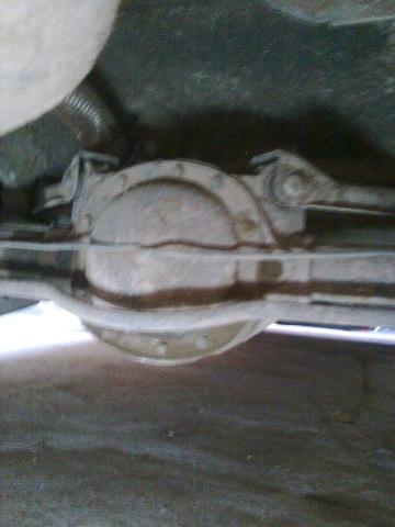

    Here are some pics of the rear axle.
    An other question, can anybody tell me what for a axle this is. Last time somebody that worked for years on ford said it was an atlas axle. I just cant believe him, i dont think that they ever put atlas axles in the Taunus. But from pictures i have seen that this looks like the baby atlas, And that they are not to bad. Anybody an idea?

      Koln axles were usually fitted to cortinas and taunuses I believe.
      Regarding your spring problem, if the rear springs are too hard you won't get weight transfer to the rear on acceleration and therefore you will have less grip. The axle bounce (tramp) is most likely due to the void bushes in the top locating arms allowing the axle to wind up, then rebound.

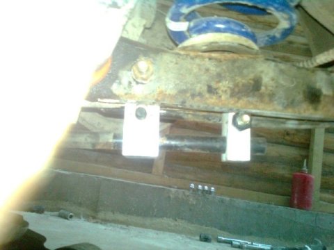

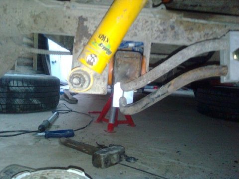

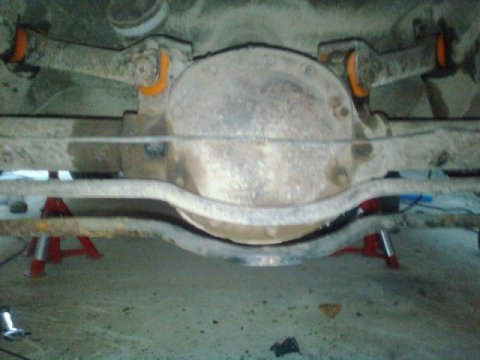

              #51

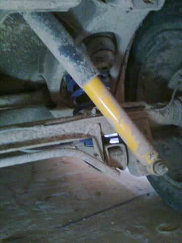

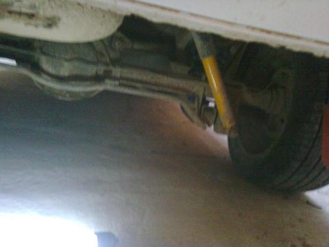

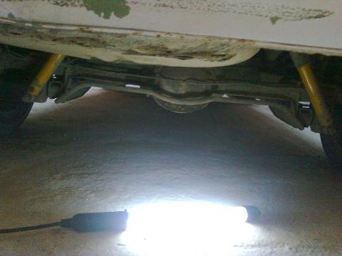

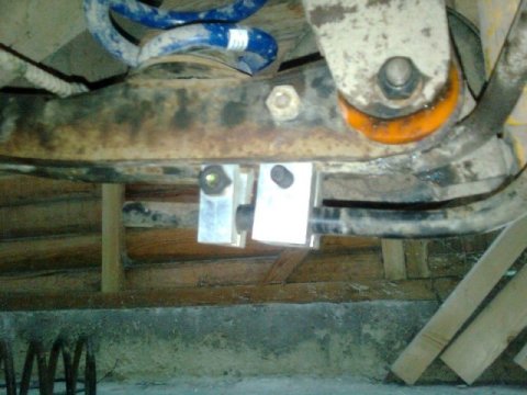

              So from the advice I got from here, I stuck new poly bushes all around the rear axle. Was a fun job drilling the old rubber bushes.
              And also I installed a second panhard rod ( i think dont know the english name) So it should be stiffer in the back and looks at the moment now.

                #52
                arieke, that looks like axle tramp is going on when you start.
                some tips when i was starting of that same line in the escort :p
                get the rear softer inbound, there is hardly any weight transfer to the back, the rear of the car doesnt drop down when you lift off. the rear seems too hard. look at the starts of the volvo's in rallycross, they almost hit the ground when starting of the line.
                try to fit anti tramp bars to prevent it happening : simple installation. there should be plenty of pics on the forum. Or install a 4 link system that you set up so the car drops when starting from the line.
                i had the bugger axle tramp when i still had leaves on the escort. when i installed a 4 link system with a Z-bar is was gone and dramatically improved the overall handling.
                  in the uk, cortinas had a variation on of the atlas axle, so they are atlas's but not quite the atlas we have in our capris
                    thats an anti roll bar.
                    a panard rod connects one end of the axle, the the chassis on the opposite side of the car ro stop the axle moving sideways

                      #55
                      u have a koln axle there, some cortinas here that had the atlas type axles, i believe they are mk3,4 and 5's 2l + and some towing packaged cars had them fitted, if u can find one u can fit capri slipper
                      To tell a heavy atlas type look at the bolt pattern on the diff plate if its symmetrical its a atlas type

                        #56
                        Yeh that's a Koln (or chocolate axle) IE get it warm and it melts
                        TBH with all that rear anti roll bar stiffnes your turn in will be very direct and cause more overstear
                        i use a hyundai rear ARB it's 20 mm and about as far as i like to go on the rear
                        Ii don't like to fully polybush the rear end, for 1 it will start to crack the mounts at the chassis end and it limits the axle movement and makes for a very very hard and skippy ride especialy on bumpy corners, personly i'd be softenong the rear and using rubber bushes at the axle end of the arms, if you want better axle locatuion you need to go back to rubber and add a panhard rod (if you can find an 81 to 89 hyundai stellar they have a cortina rear end thats 5 linked with slightly alterd bushes and a way way better than the standard taunus set up
