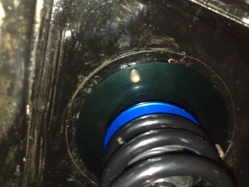

      Originally posted by Adam B
      hey mate, whats the score on the rear top mounts?
      I'm fitting mine tonight or tomorrow, if they fit ok I can get some more made. I will pm you for details.

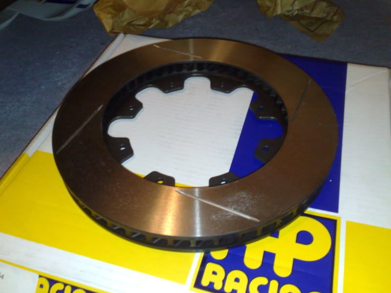

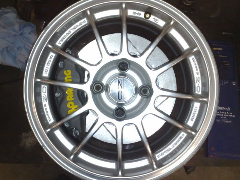

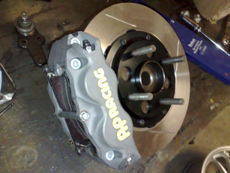

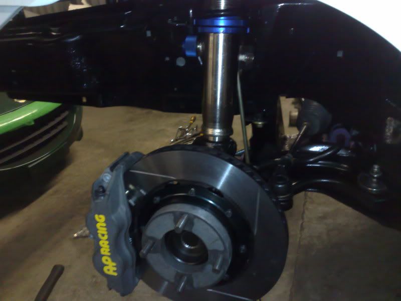

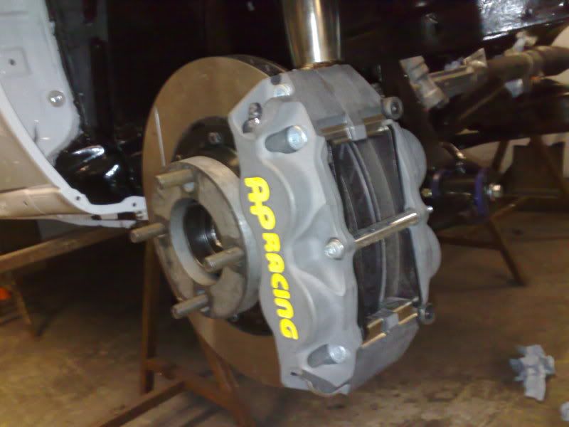

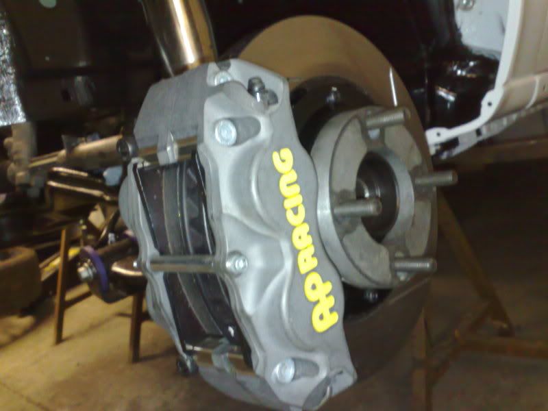

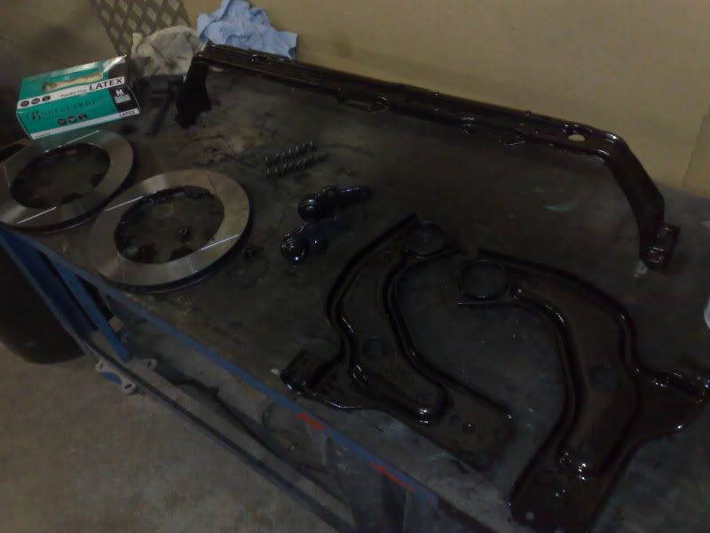

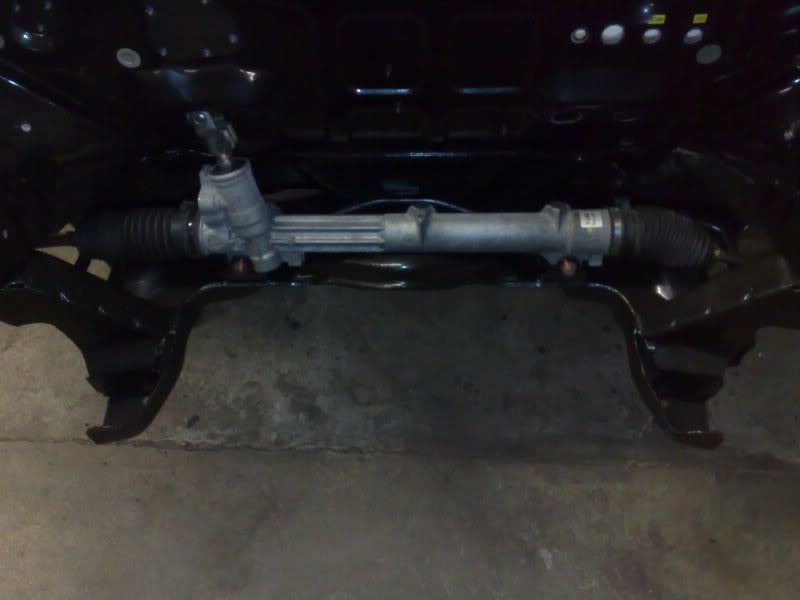

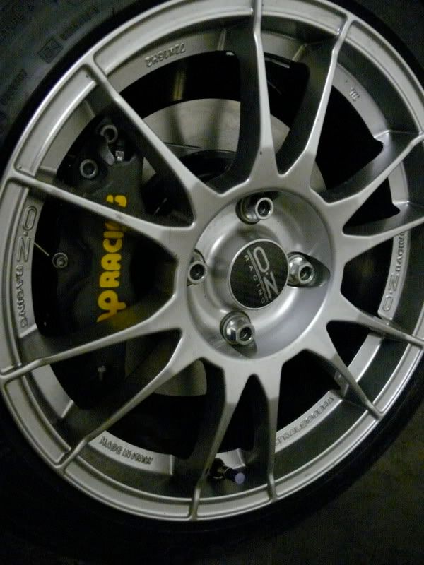

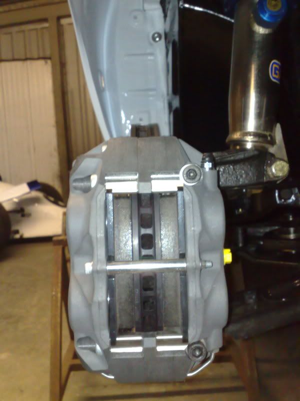

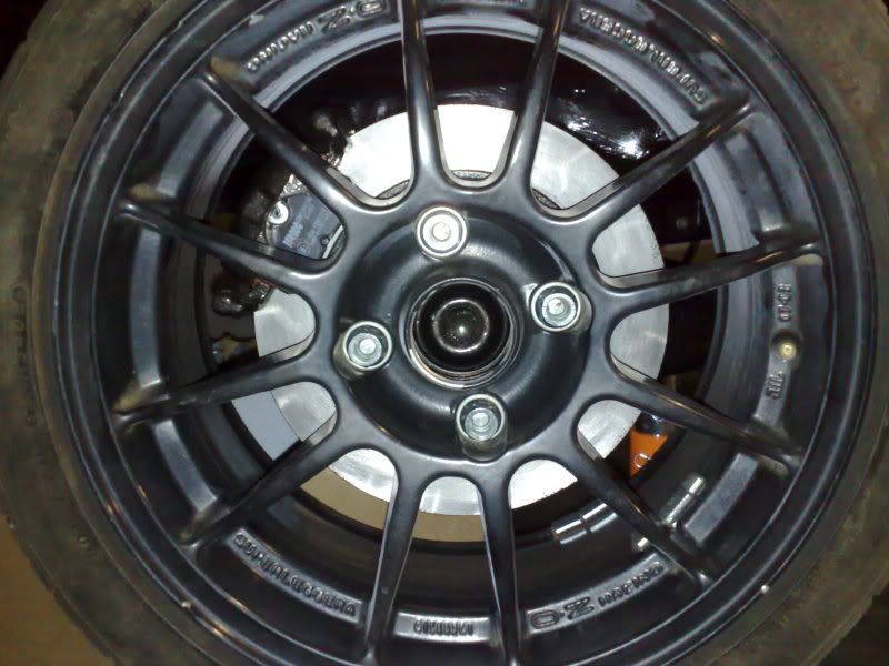

        I will let the pictures do the talking . . .
        • team_zi
          • 1637
          Should be able to do a stoppie now with those brakes on the front. Mahoosive.
          How much weight have you added, through the larger disks and bells and all the other stuff?
          • jason33
            • Jul 2009
            • 174

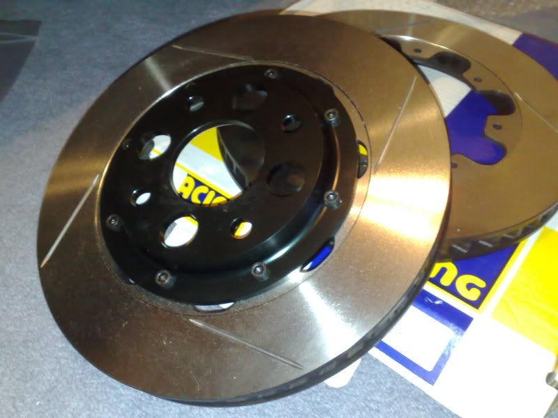

            The rotor and bell combo is 1kg lighter per side than the single piece disc I had last year, even though I have increaced the disc diameter by 10mm and is 4mm wider. The calipers are slightly heavier, about 300g, but should be a massive improvement over the hi-specs.

                  and i'd really recommend some proper hub-centric spacers
                  My Project...
                  • jason33
                    • Jul 2009
                    • 174
                    I've designed some to be made, just lacking a bit of money! lol
                    Certainly gets annoying after two years having to manually centre them every time you put a wheel on!

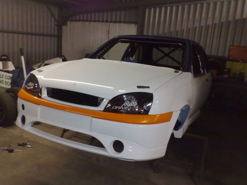

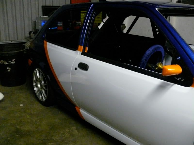

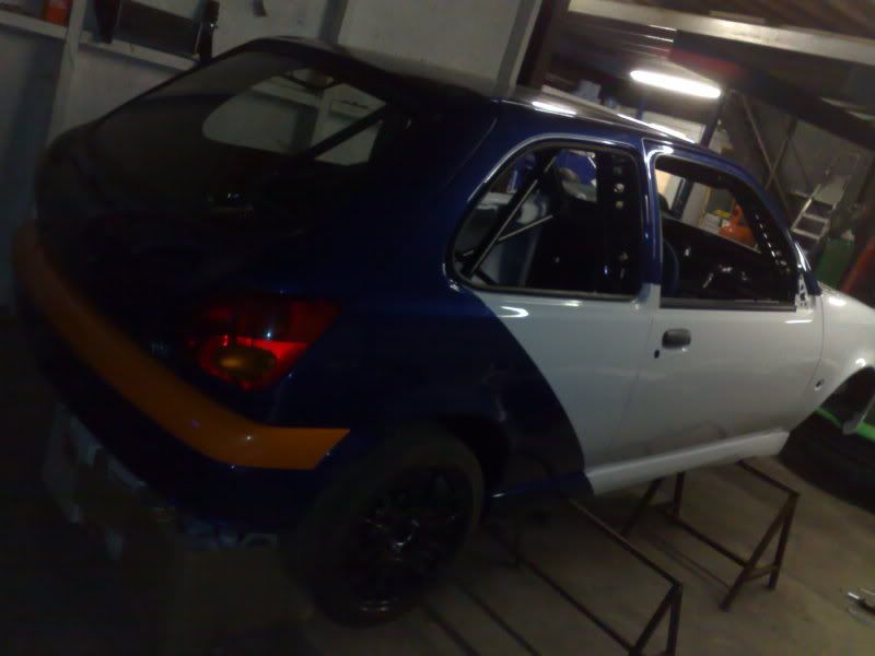

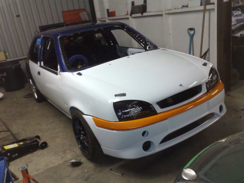

                          As of 15/02/10
                          Skirts fitted, mirrors fitted, front arches flaired to fit the 16's (if gearing requires them), rear topmounts fitted.
