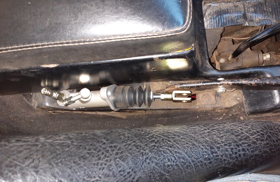

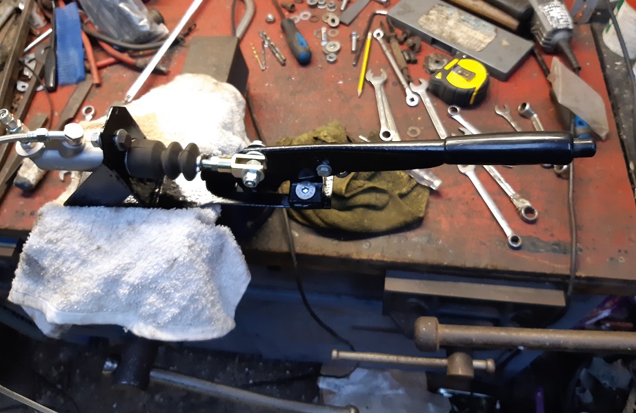

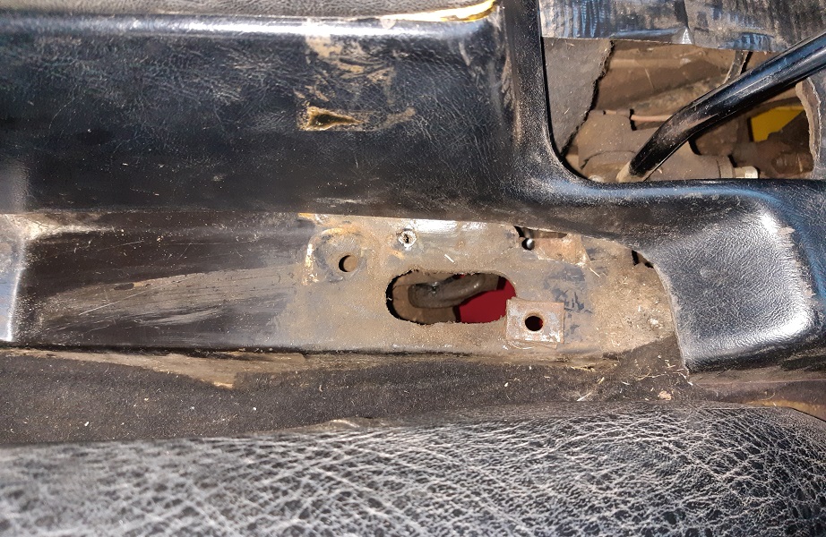

        To meet the new regs, the hydraulic cylinder needs to be actuated by the standard handbrake as that is how it would have been done in the 70's, and the cables still attached underneath

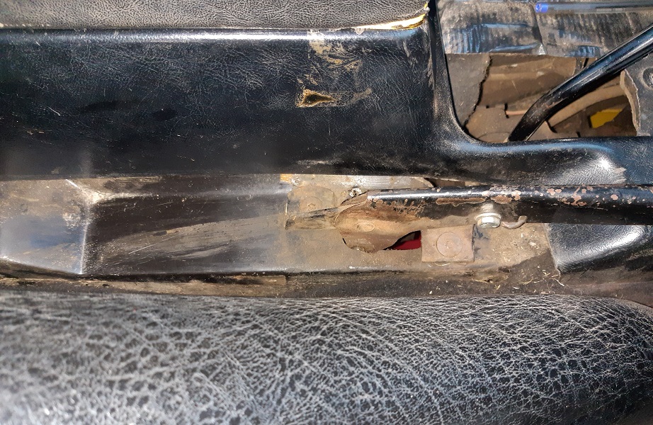

        Brackets are available but I wanted one to connect the handbarke and hydraulic cylinder together, for extra strength on the fibreglass tunnel, despite the existing reinforcement plate under the handbrake. Being a SE5a, the tunnel has a recessed section behind the handbrake that looked just the right size for my purpose
        With the cylinder offset, it should just fit beside the centre console
        I bought the smallest cylinder I could find, a 0.5" bore from Rally Design, along with 1m of Aeroquip and some unions - total cost was £68

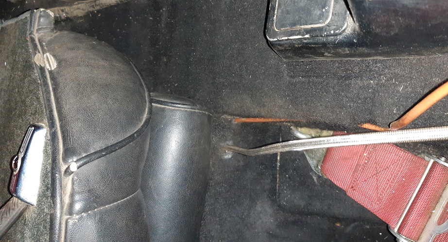

        I worked out that rather than cutting the pipe to the rear axle, I could disconnect it at the flexi pipe joint and bend it up through the rear footwell to join to the cylinder
        Then the new Aeroquip pipe goes from the cylinder to the rear flexi. This also means it is easy to remove the cylinder from the system if there are any problems with the set up

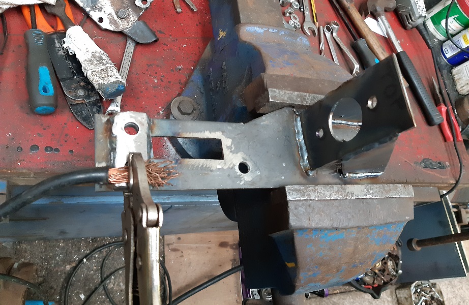

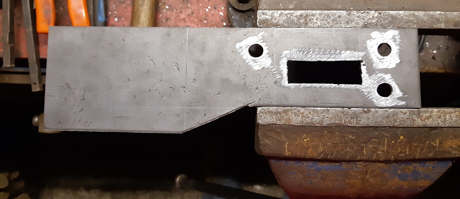

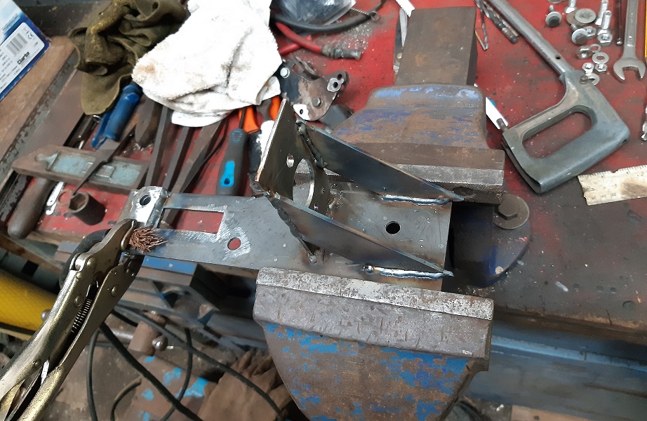

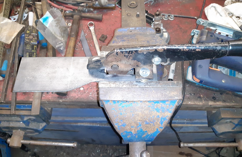

        Making a start on the bracket - to offset the cylinder it needs to overhang the tunnel at the back

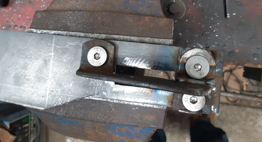

        I also added another tab at the front of the handbrake bracket for extra strength
        Bracket taking shape - hole at the back will also bolt through the transmission tunnel

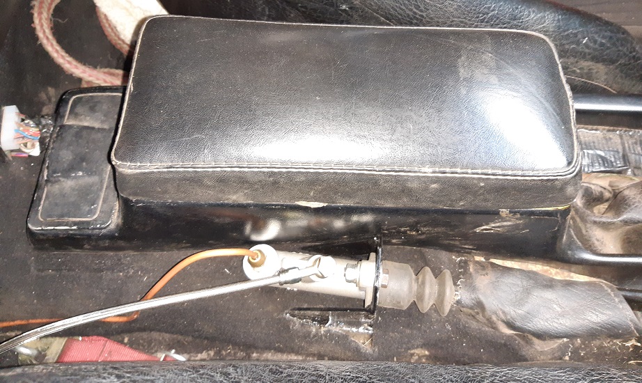

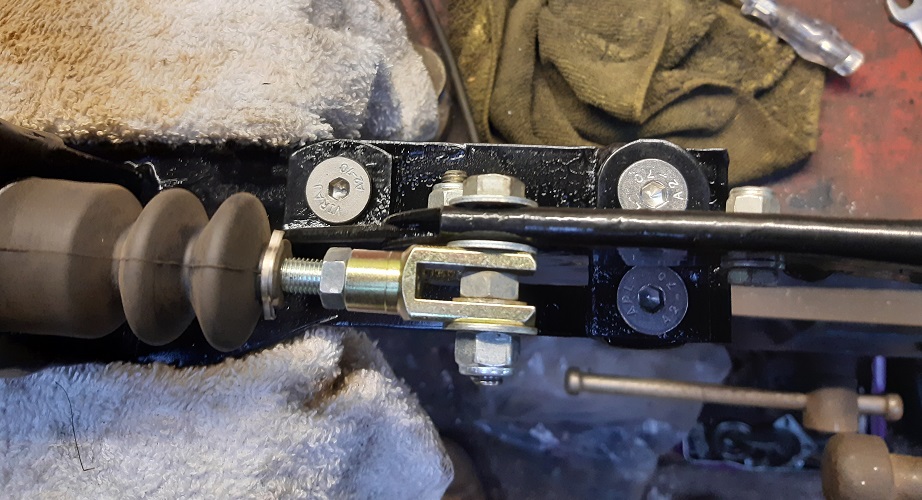

        After tidying up and painting everything
        Detail of the offset
        All installed and plumbed in
        The back of the centre console is about 1/2" out of line but this won't cause any problems, and I think I can get it lined up slightly better anyway
        No idea if the handbrake works but I will try it out as soon as we're allowed out to play

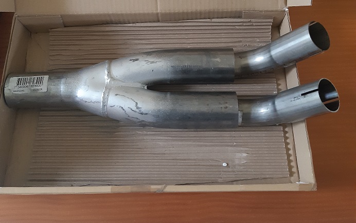

                            My next outing with the Scimitar was using it as Course Car on the Cotswold Historic which I organise as part of Tavern Motor Club. This year it was on Saturday 2nd July so I had just 2 weeks to sort out the exhaust. I didn't worry about replacing the shock absorber just yet but I ordered 2 new ones from Spax.

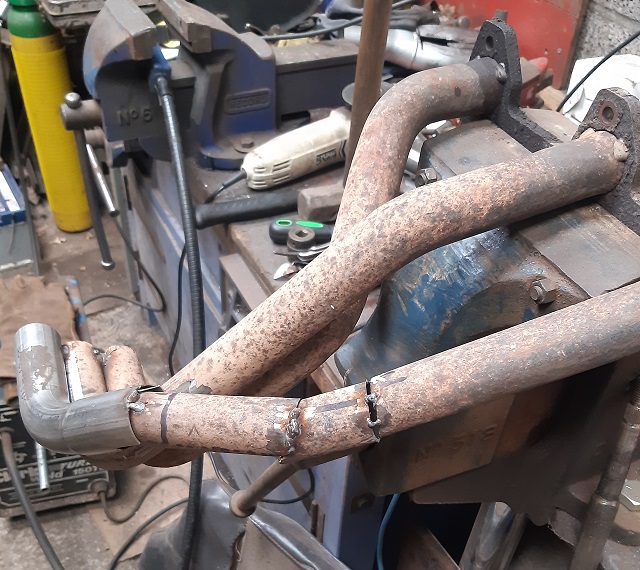

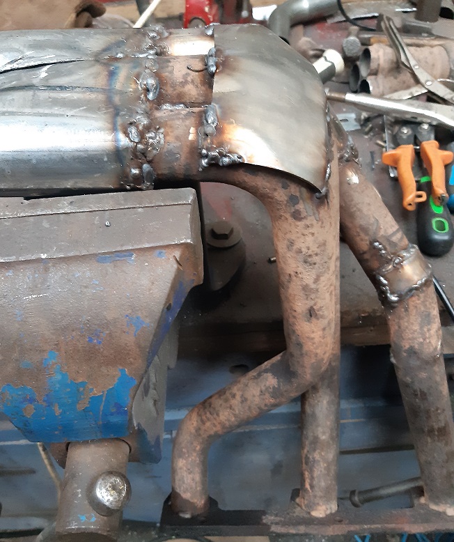

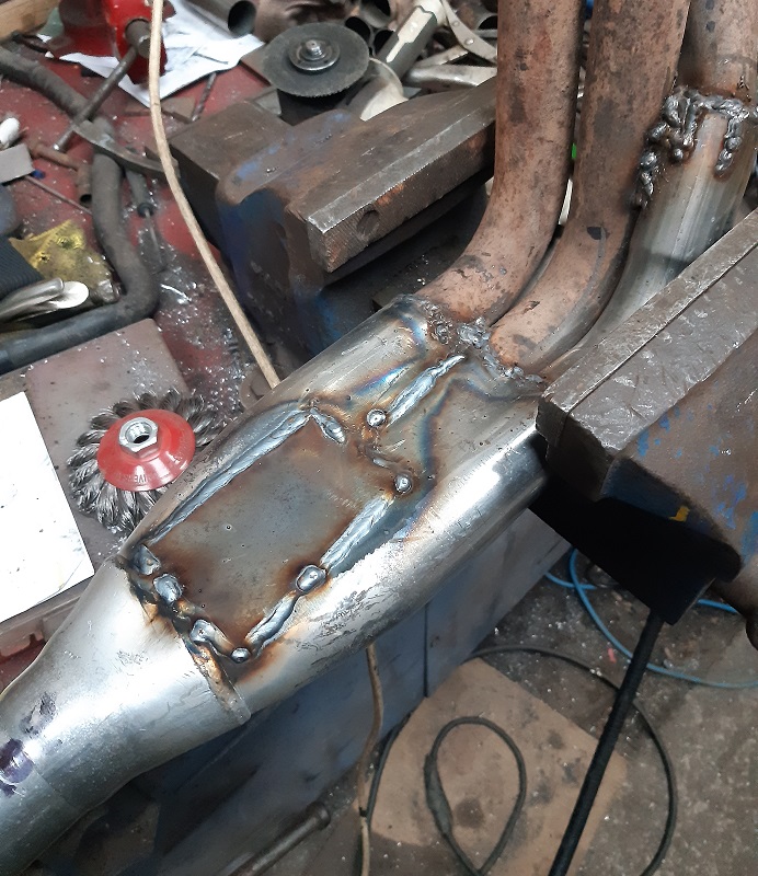

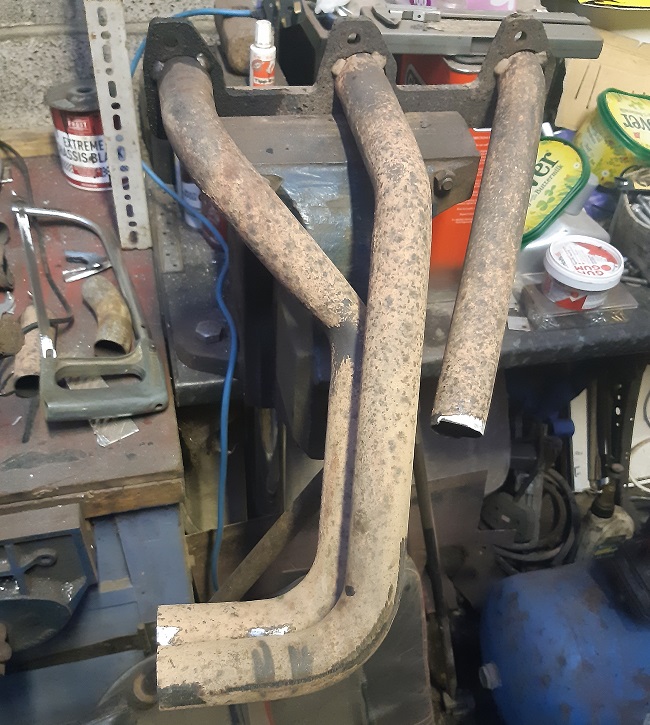

                            A few years ago, I had replaced both exhausts from the manifolds back with a home made system using Jetex universal parts of 2" diameter, so I went to Merlin Motorsport to see what I could use to help modify the manifolds. I could not find anywhere to buy 3-1 flat collectors but discovered a 2-1 Y piece with 2 x 2" inputs was the same width as 3 x 1.1/2" pipes laid side by side, so I ordered a couple of those and some 60 degree bends.

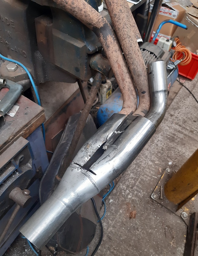

                            While I waited for these bits to arrive, I spent a few evenings gently working on the manifold bolts to make sure nothing was going to snap off
                            5 bolts came out of the driver's side quite easily and the 6th was at the back but it is the one bolt where it is possible to get some oil behind the bolt. After a few soakings, that came loose as well. On the passenger side, only 4 bolts came loose easily and the other 2 were being very reluctant, so I decided to leave them and do that side another time (as it is only slightly dented).
                            Once the manifold was off, I mounted it in the large vice and chopped off the collector and the bent pieces of pipe.
                            The middle of the Y piece was cut out and I started to mock it up.
                            All tacked into place - I refitted the manifold a few times while doing this to make sure nothing fouled the steering column or the chassis.
                            More welding and added a skid plate made from another piece of SS pipe which I flattened in the press.
                            All welded up and plated over the holes in the Y piece on top and underneath.
                            Back on the car with the rest of the system fitted - the chassis is now the lowest part of the car which was the point of the exercise

                              Mate - you can't weld rust! If you clean / wire wheel the metal first, the welds on the old will come out as good as the new one's. Fair do's for 'make do & mend' mentality!
                                Re: GavinR's Scimitar Historic Rally Car
                                Don't worry, I've been welding rust for years
                                It is strong and functional
