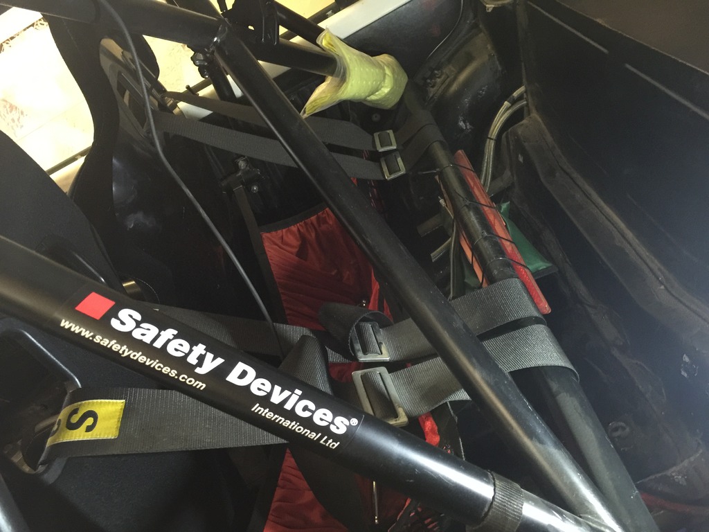

    Yours is Jon because the harness bar is high up
    The cage I want has the harness bar at the bottom of the cross like lukes
    Panic over then! Lol.

      Managed to get any pictures yet Luke?

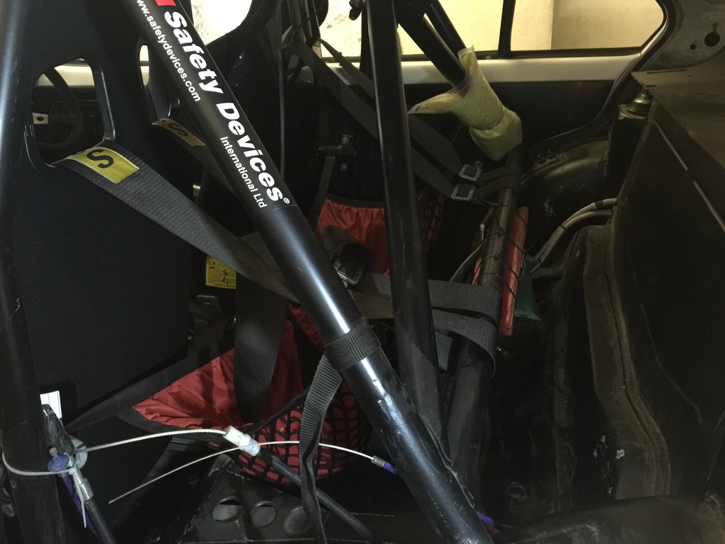

              Angle doesn't look to steep
              It has to be within 20 degree of horizontal apparently

                Someone was telling me that the ruling says it is recommended 20°. Not read the rules myself and we all now how reliable secondhand information is.

                    Just done a little research, all the answers are here
                    As you said the recommendation is 20 degrees, mine looks more than that, but they will accept up to 45 degrees which would make mine ok.
