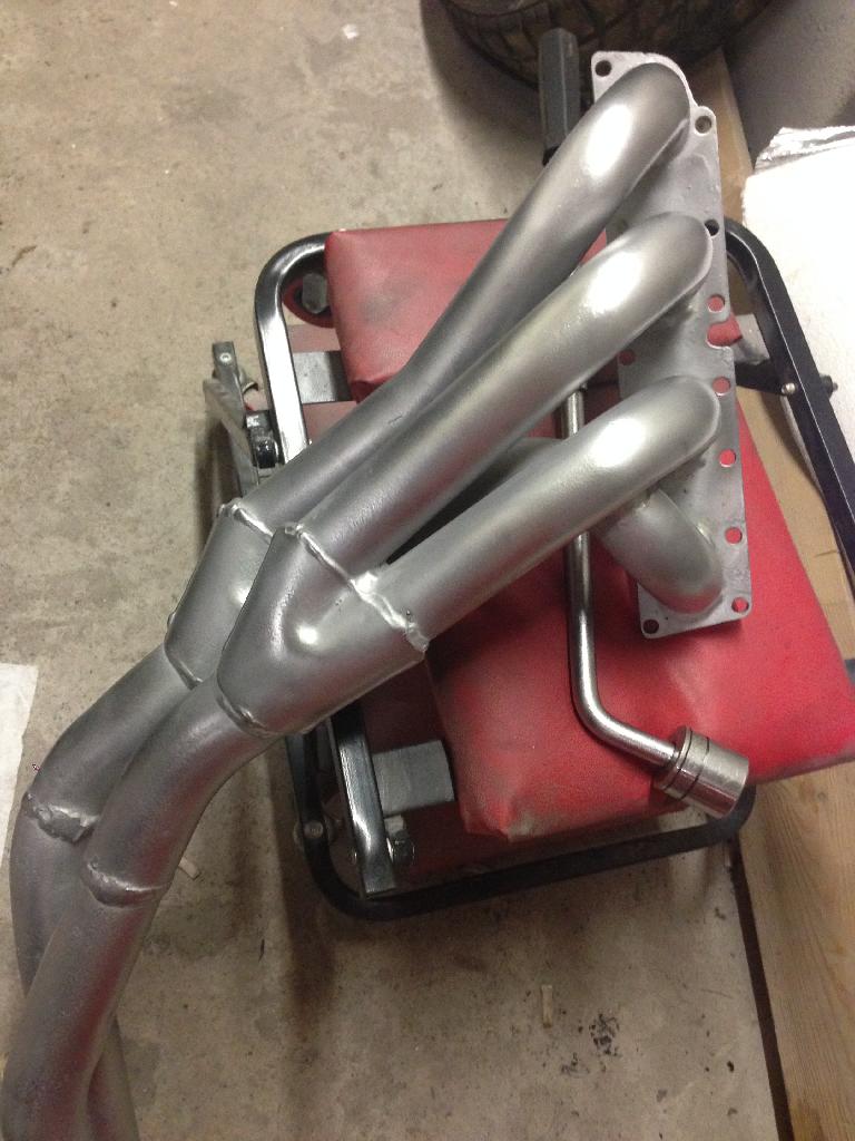

Repaired exhaust manifold
Painted exhaust manifold (heat resistant coating)
What heat resistant stuff did you use ?Hexham and District MotorclubComment

I had the manifold painted by a friend who works painting aircraft parts, not sure exactly what it is but if its good enough to fly its good enough for the more door.

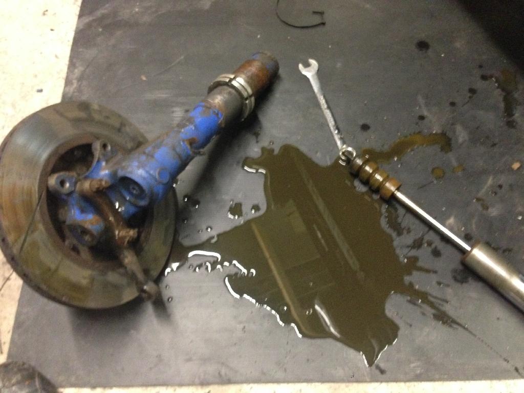

I had a bit if spare time last weekend so I fitted up the tension strut kit and took the car to melvyn evans to get it set up. While going through the car they spotted that there was hardly any front suspension travel which lead me to stripping down the front legs when I got home. When I got the inserts out I found the legs were full of water, thus stoping the insert from compressing and stopping suspension travel.
I think this was the main contributor to my recent understeer problems and probably played a part in the damaged engine mount. I've ordered new bushes, seals, teflon grease and coilover covers to prevent water entering the leg in future. I'll probably end up changing the tca's while is apart as the ball joints are on their way.

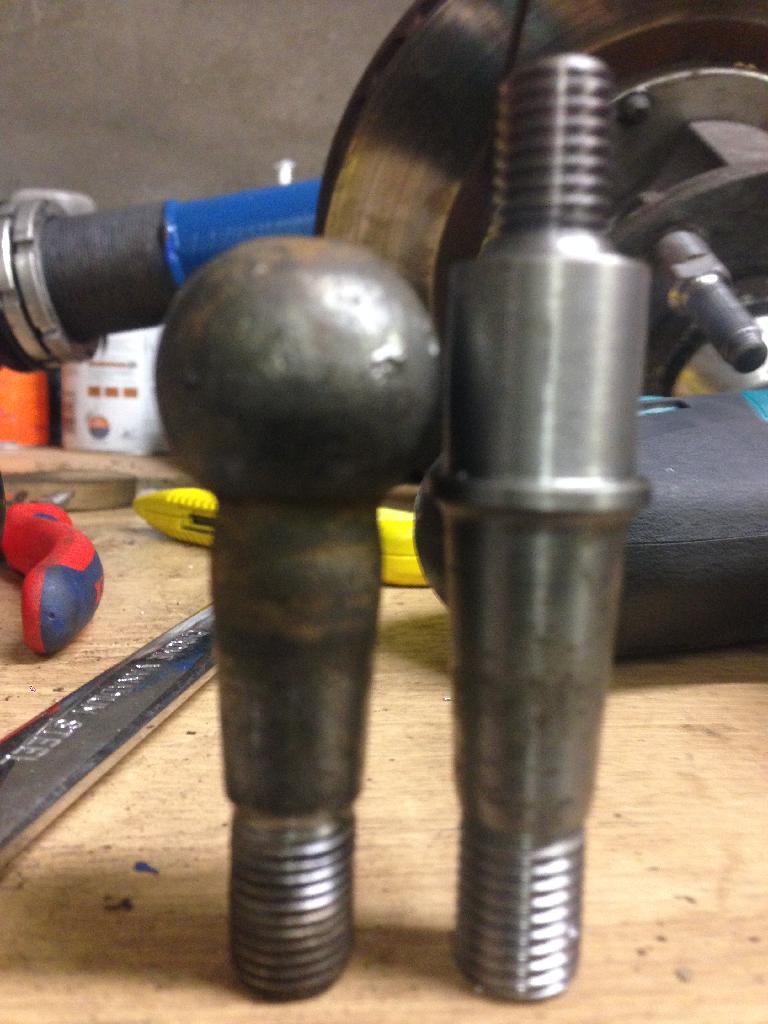

I had to make some nuts out of my old tca adjusters to fit the new top mounts
New tca's with spherical bearing ball joints
