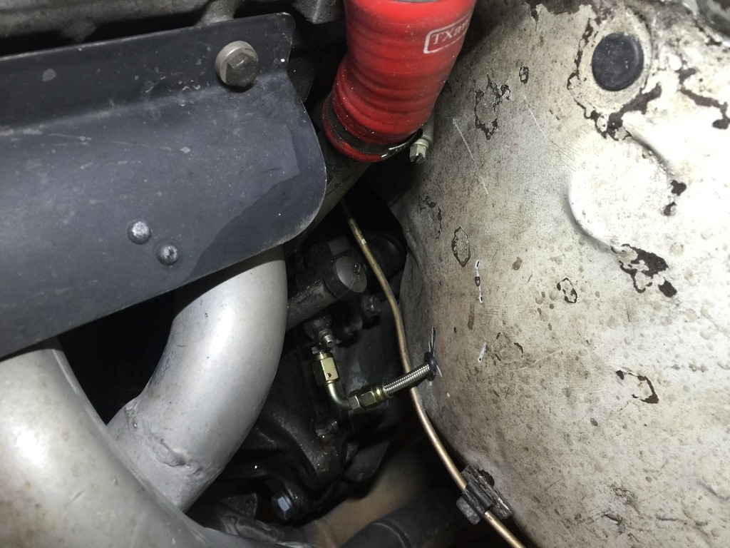

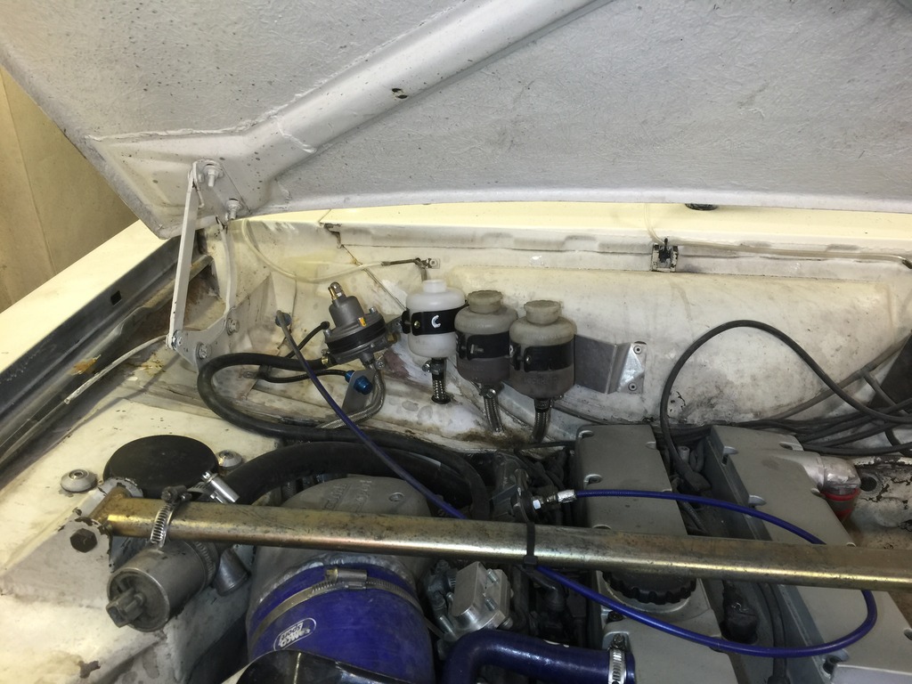

        Another step closer, pedal box is in and hydraulic clutch pipped up.
        Last thing to sort now is the propshaft, it's 45" from my atlas to the gearbox which I belive is about an inch to short to use the rx8 Carbon prop. I'm waiting on some measurements from John to confirm. Looks like I'm going to have to get my original prop shortened.

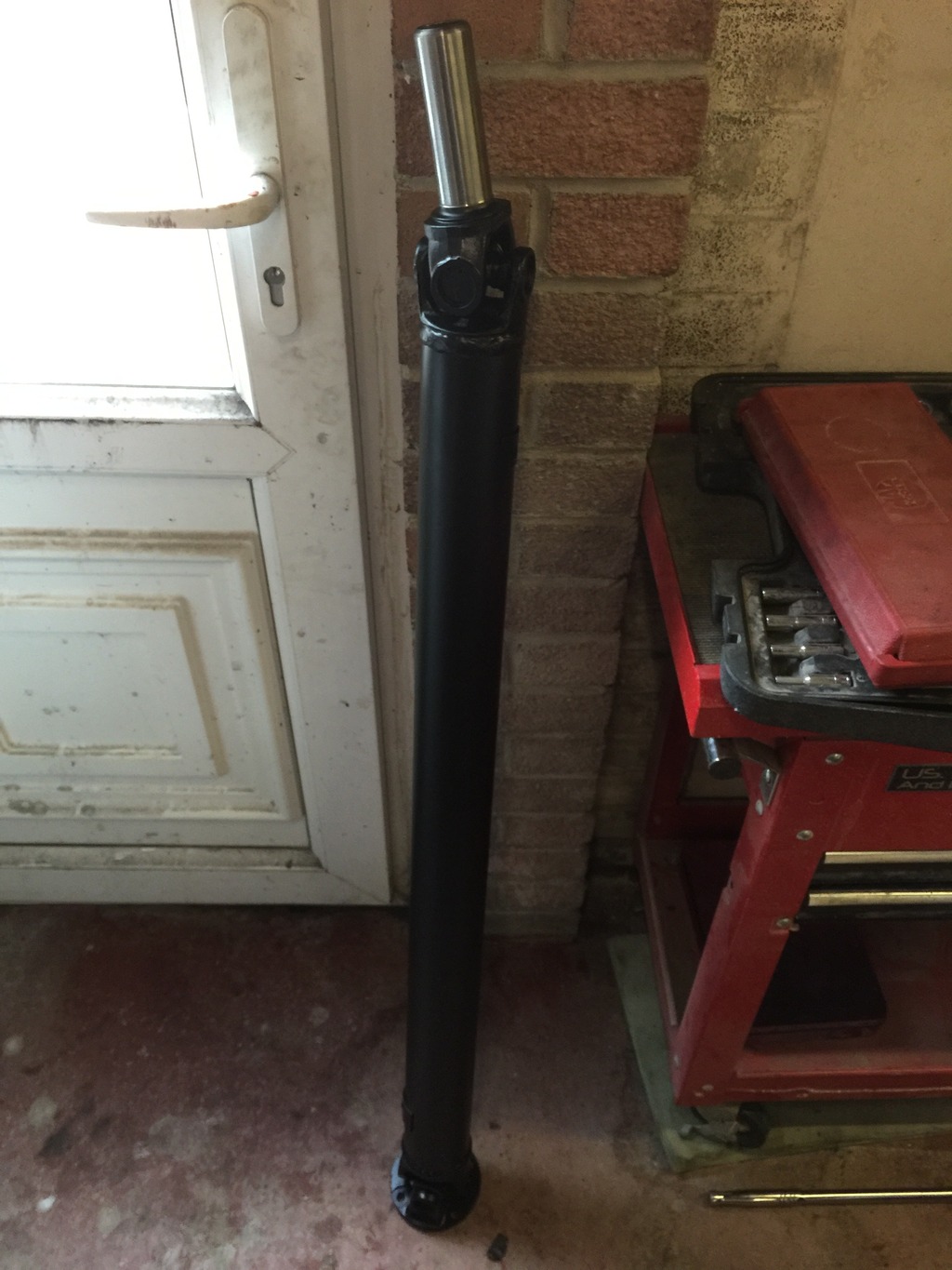

                  Had the prop back from bar propshafts in neath, shortened with an rx8 end fitted, very speedy service at a good price.
                  A little bit of tinkering left, then to fill the box with fresh oil and give it a go.

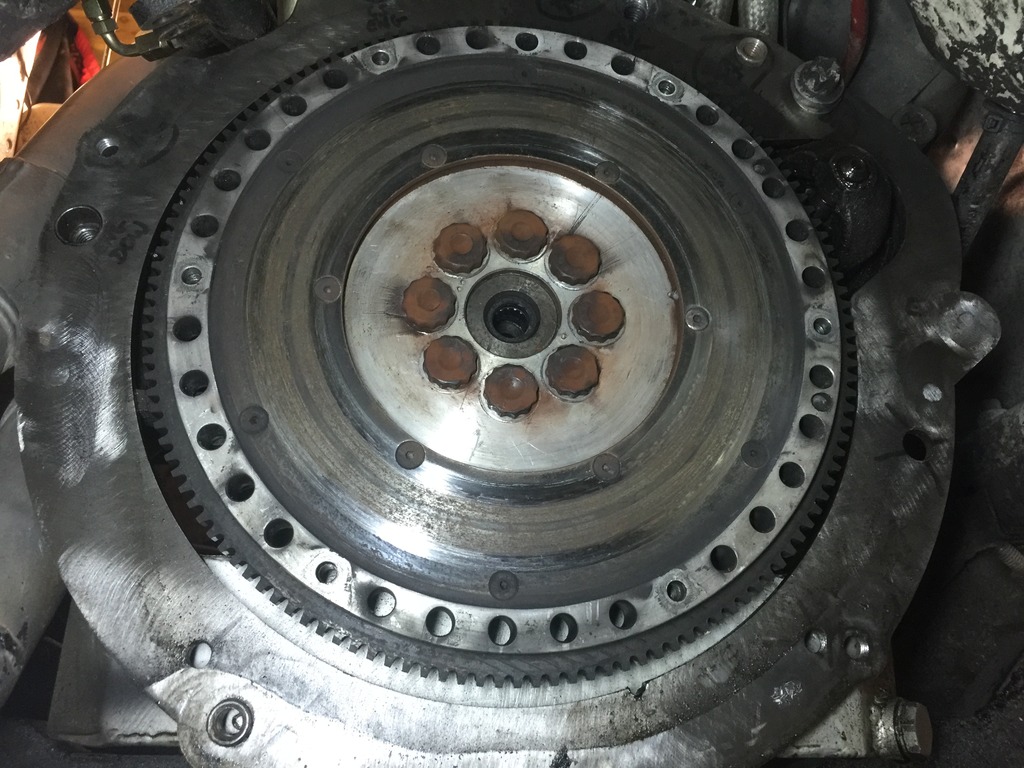

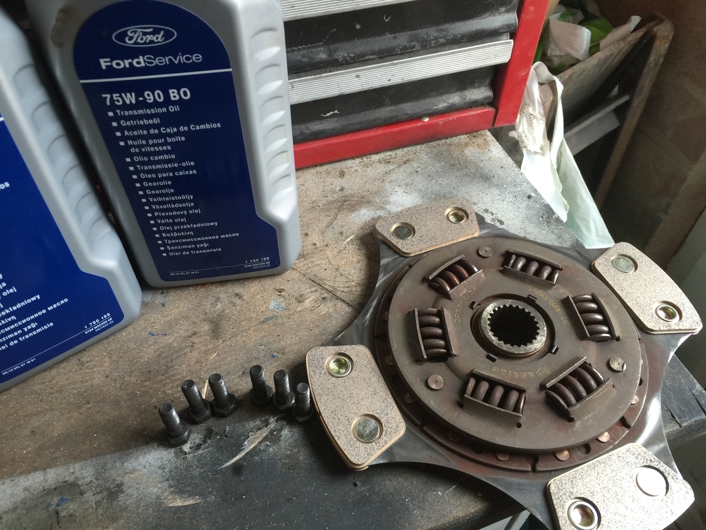

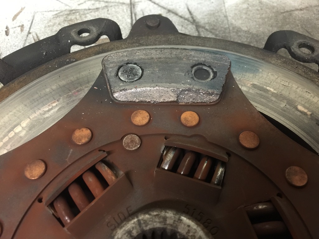

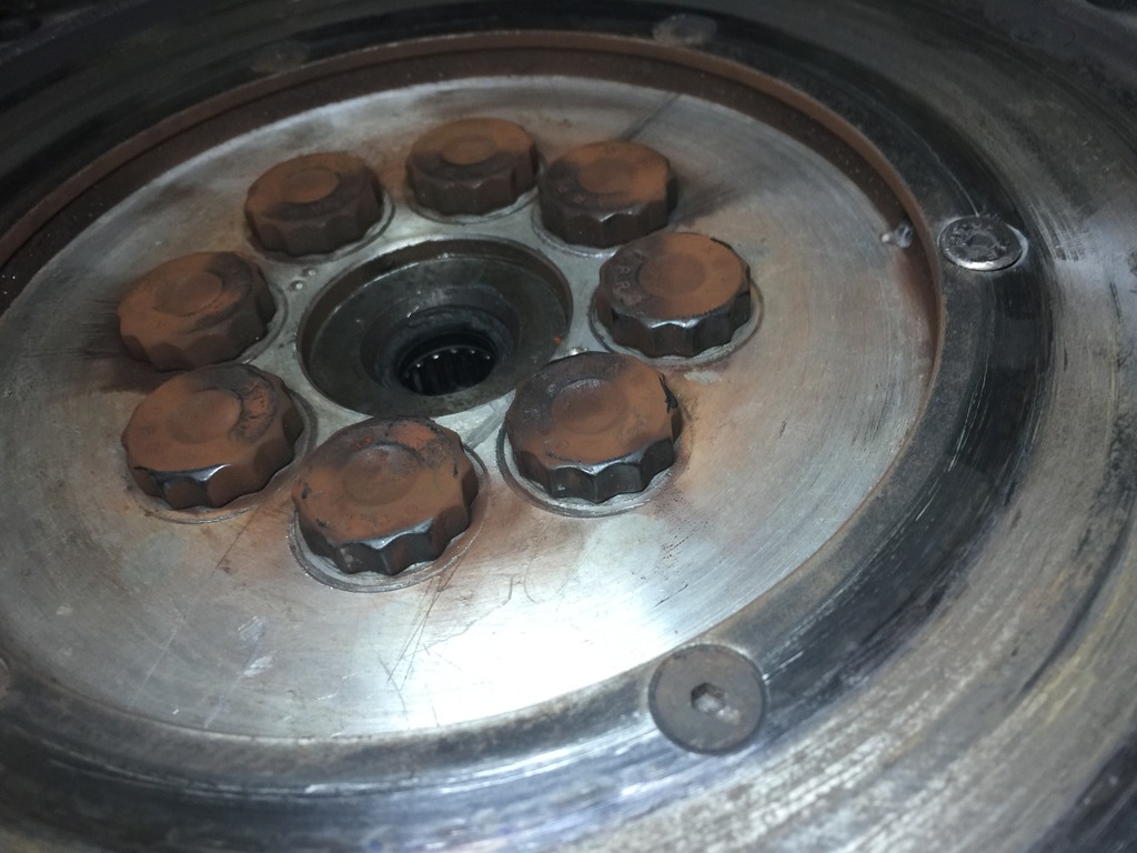

                          When I changed the box I fitted a new ally two piece flywheel, however, after a few runs over the local mountains to test the new box, one of the bolts on steel plate tried to make a break for it and ruined my clutch in the process. I had the clutch re lined and put it back together today ready for the weekend.
