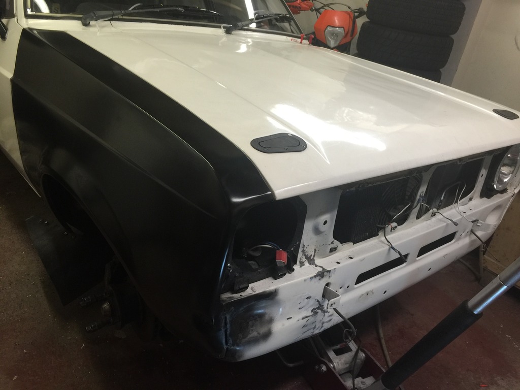

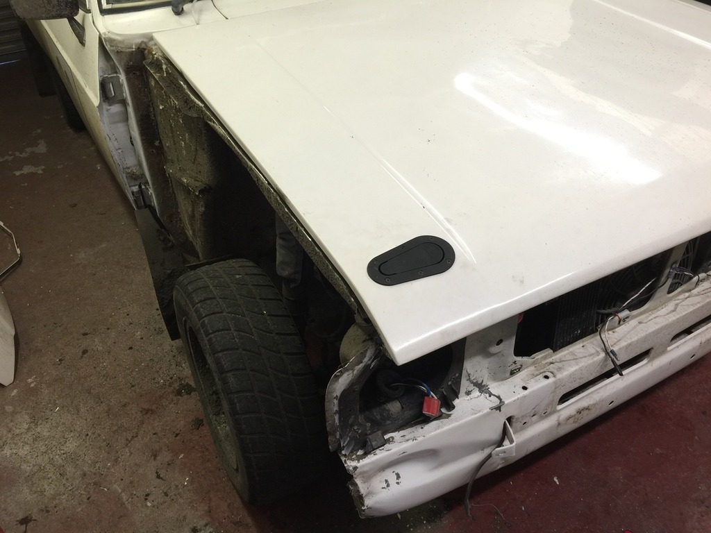

        Repairs have started
          I was waiting for the update. She's looking good and You'll be a pro at wing changing soon.
          Did the wing offer up straight away?

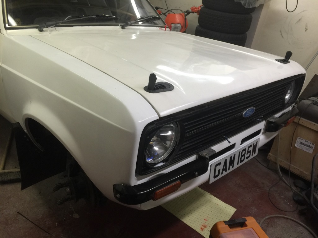

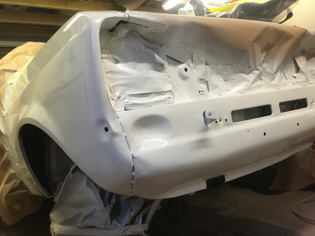

              She's painted, and entry has gone in for another rally down Pembrey - rally cwm gwendreath.
              I replaced a leaky core plug and found a big air leak on the inlet manifold so I had to replace the gasket. It's running spot on now, can't wait to get out and give it a run.

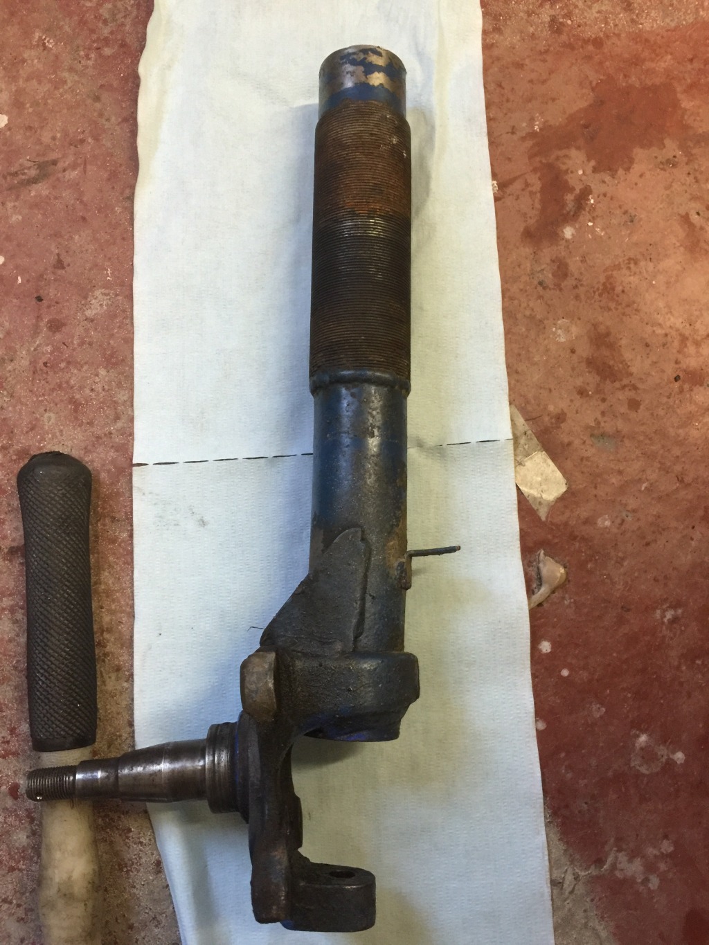

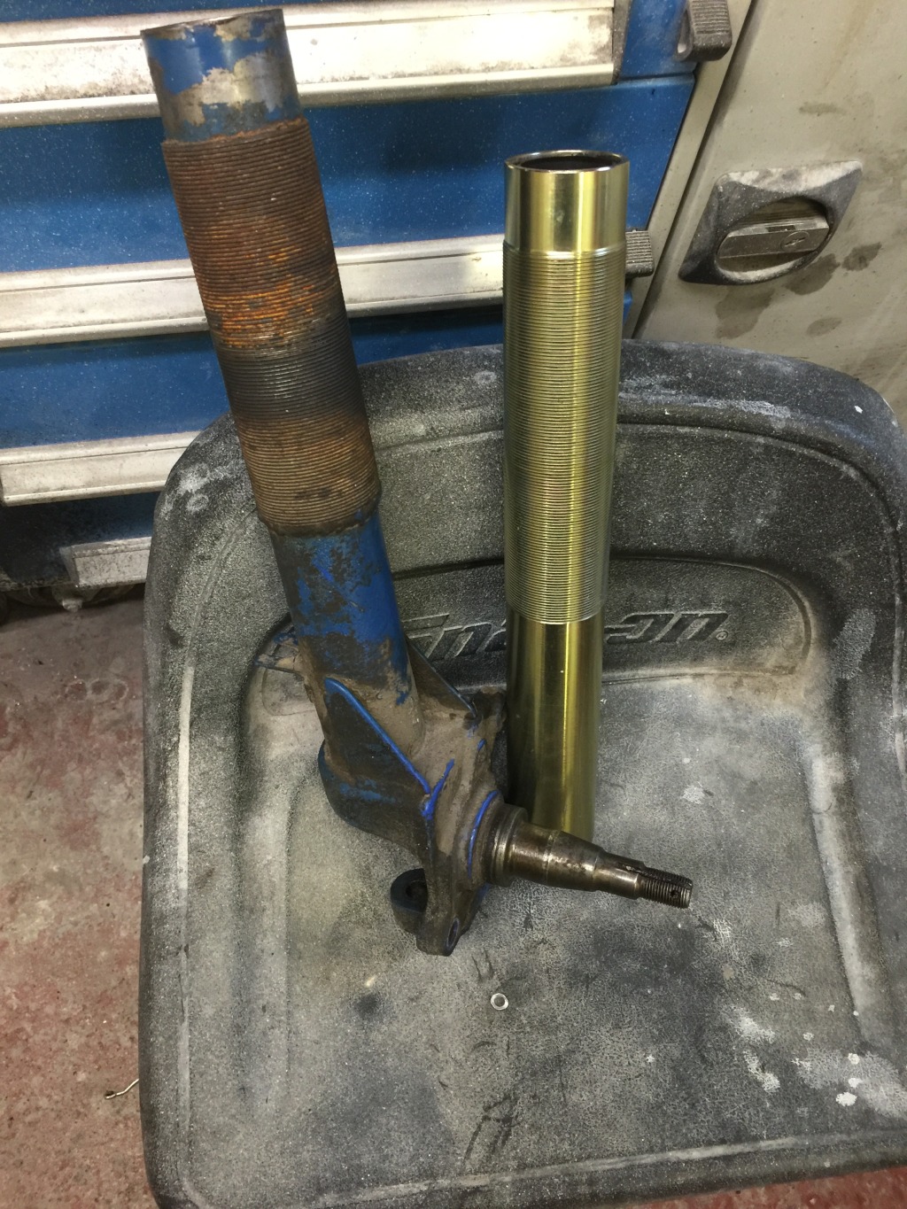

              On the modification front I decided to fit some new 300 70 long Tarmac inserts. Reason being, I could never identify what rating my inserts were as they weren't stamped with numbers, and at the last rally my understeer reared its head again, the inserts were the only Unknown.

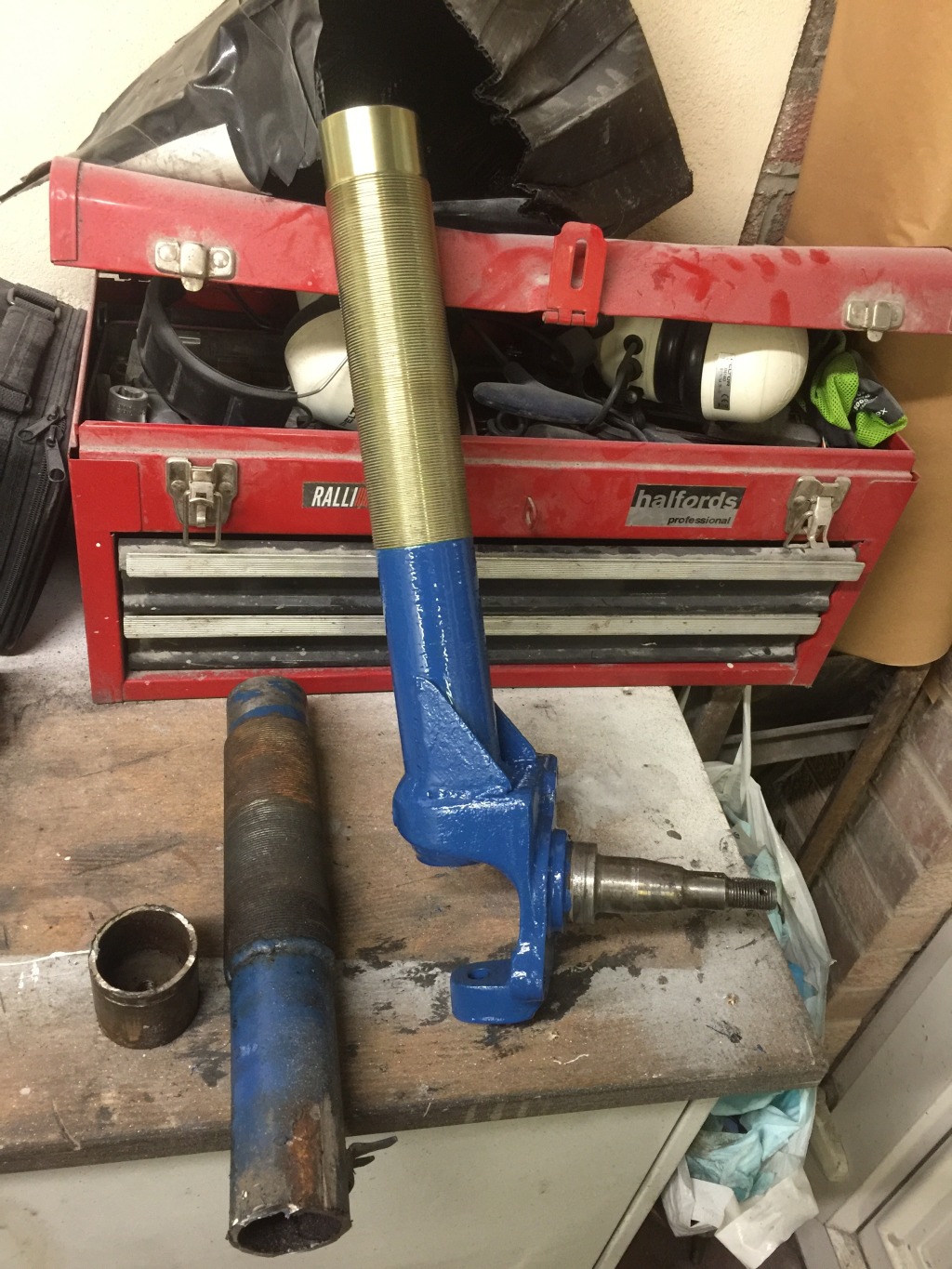

              When I tried to fit the new inserts into the m10 threaded hole at the bottom of the leg I couldn't get it to line up, upon closer inspection I found that the tube of the leg was bent so I had to replace that too. I found it odd that the bent tube was on the passenger side (which I didn't hit down pembrey) so who knows how long it has been bent. I also suspect that the insert was jamming in the leg due to the bend and could be the cause of my understeer. I'm waiting on a new spring seat so I can go out and try it.

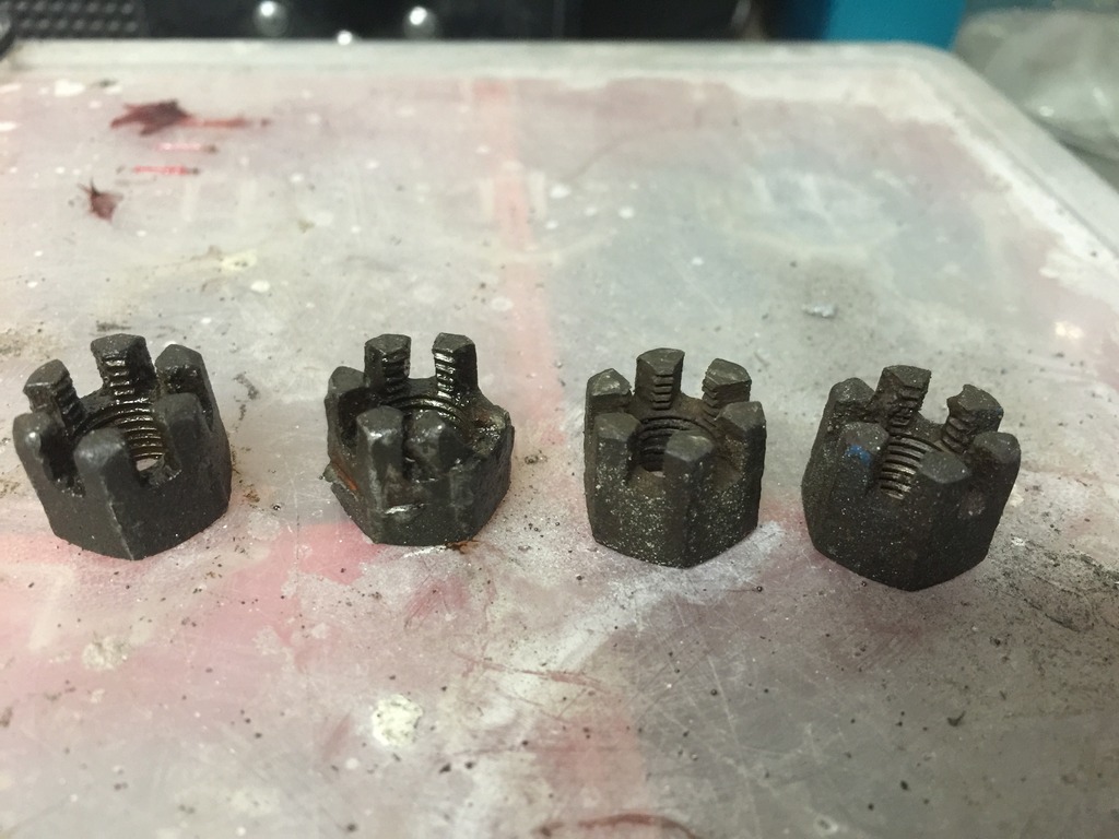

                Last thing was to swap the castle nuts on the steering arms for nylocs, as the split pins had siezed when i needed to change the steering arm quickly at the last rally.

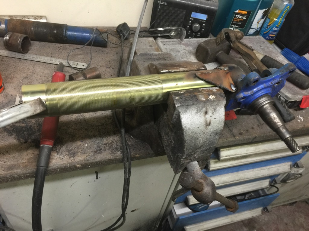

                  where did you get the new tubes? they look like a nice job! did you just cut the old one off at the hub and but weld the new one on? will it be strong enough?
                    I got the tube from Peter Lloyd rallying, but I am told they get them in from rally design. They come with the bushes and seals already fitted which was handy.
                    I ground the welds off the original tube, then cut it shorter and smashed it out of the hub with a drift, tapped the new one in and welded either side of the hub. Should be strong enough as the original was only welded on the one side.

                      ah cool thats what i was wondering, nice job!

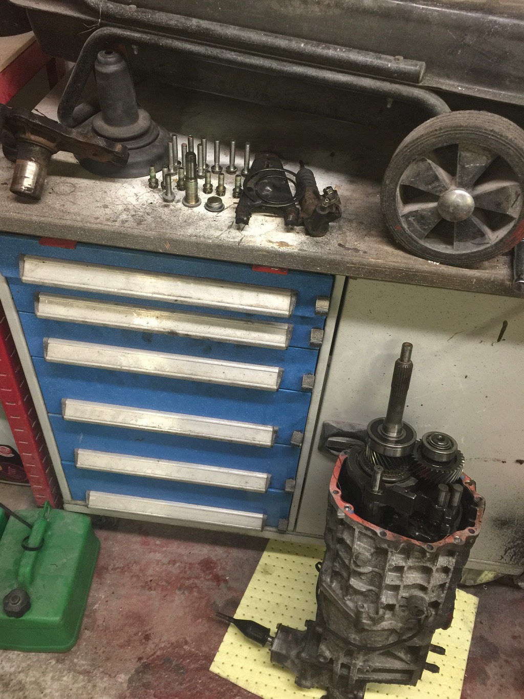

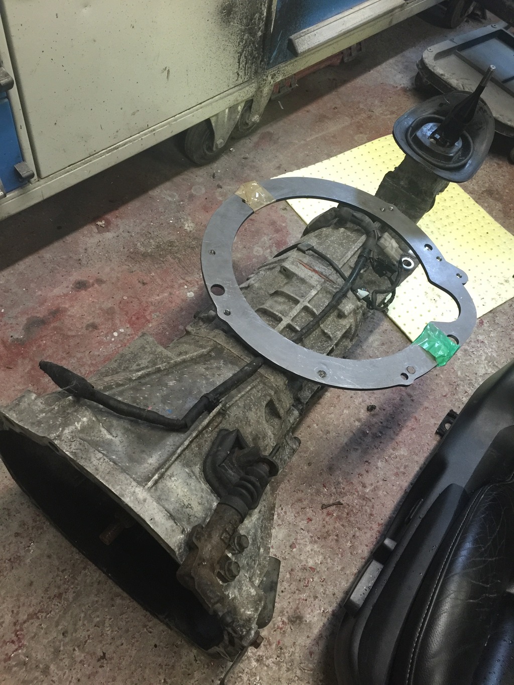

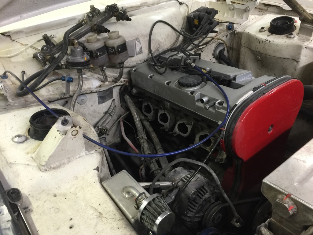

                          Meaning as the box broke it gave me an excuse to try this
                          Which I expect will keep me busy for a while.

                            Phase 1

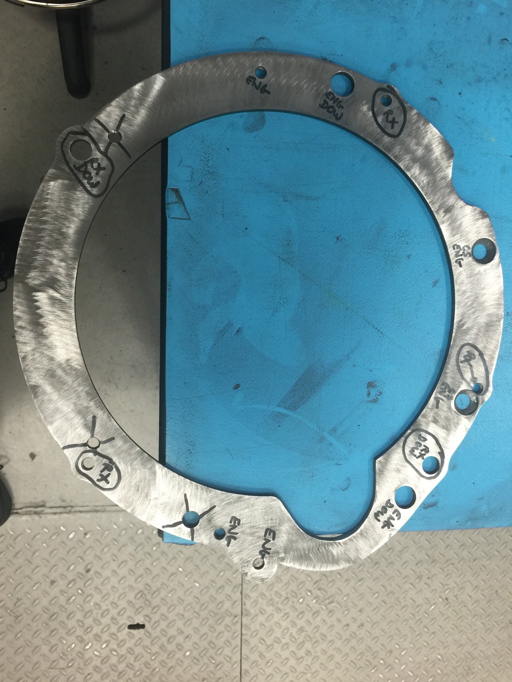

                            Plate has been test fitted and holes marked up
                            Rather than make a spigot extender I've taken the bell housing off the gearbox and sent it off for machining. 15.5mm to be removed from the the bellhousing flange and dowel holes re drilled.

                              does the xe require a longer input shaft compared to pinto etc ?
                                Yes, it needs to be extended by over 20mm
