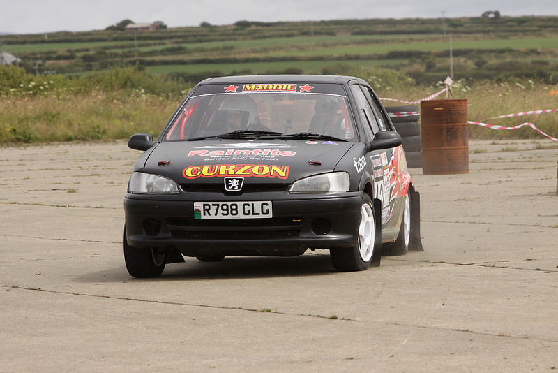

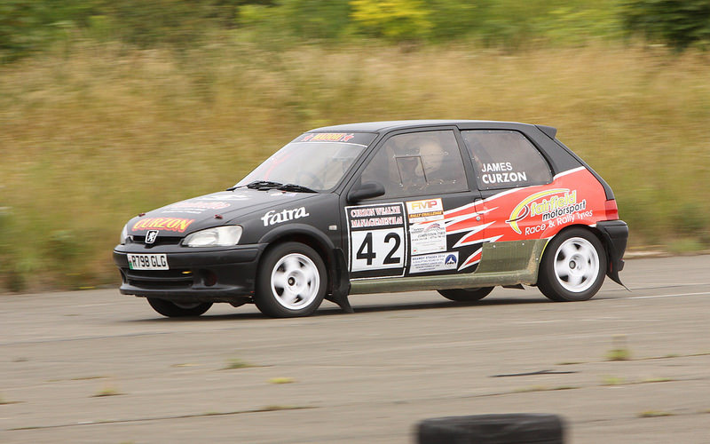

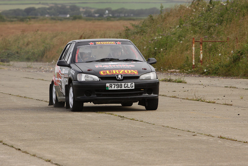

                    Sounds like you had an eventful day, you was going well when I saw you gutted for you on the retirement.
                    Pity you're missing the Flatters but best to get the car right in the long run.
