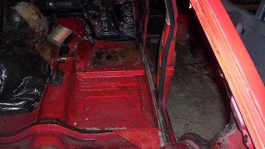

            Tonight I removed the interior and hopefully it will fit in my 4 door Mk1 without too much trouble, along with the door cards which might be more awkward

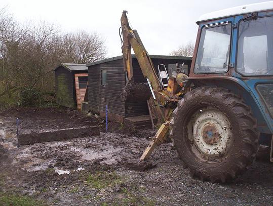

              #126

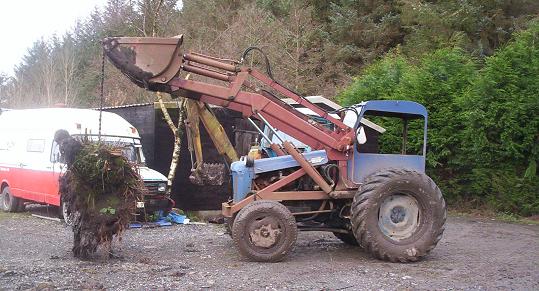

              Spent the morning digging up a tree stump that was in the way of a new bit of drive I need to lay for the garage - it was a bit heavy so I had to use the large shovel to move it
              Then it was back to the 4 door this afternoon - engine, gearbox and front suspension ready to be dragged out but it was dark by then so that's a job for next weekend
              Interior is all out now - might have to cut some of the floorpans out as they're nice and shiny

                Tidy digger you have there Gavin. :cool/:

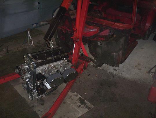

                    I'd phoned Ron at HT last weekend to see if he'd started rebuilding the cossie - he'd not only started it, he'd finished it and it was ready for collection
                    So I picked it up yesterday morning, no major problems found, although one rear head bolt was completely loose
                    Back in the workshop tonight, looking nice and shiny

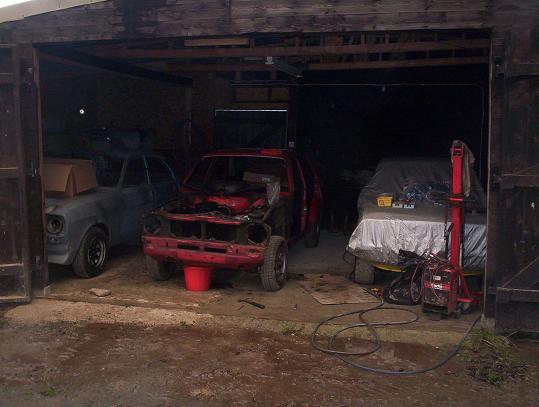

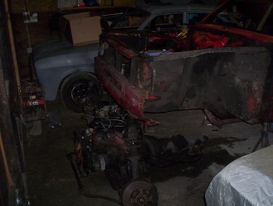

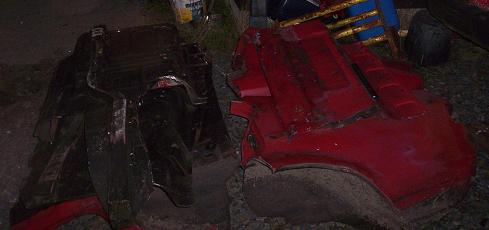

                              Made a bit more progress this weekend - finished chopping up the 4 door so now I've got space to work on Fly
                              Saved a few panels

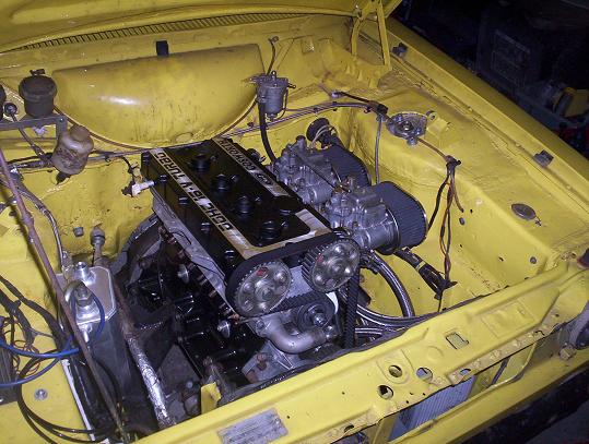

                              And fitted the engine and box back in Fly, just got to put all the ancilliaries on and go for a test drive - I thought I'd better make sure the gearbox works before sorting out the boot floor, etc
                              I've also bought inner and outer sills to fit for the MOT this year - I was going to do this before Goodwood on 2nd Feb, but the MOT runs out on 2nd Feb as well so there's no need
                              Should be running next weekend with a bit of luck
