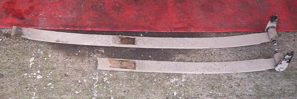

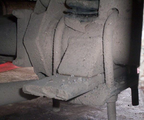

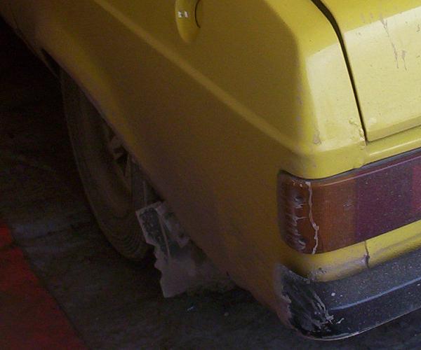

        At home today, looking a bit lopsided...
        Tyre rubbed the inner arch all the way home but only the edge of the tyre so I can use it again
        Something missing, probably lying near a large pothole on Salisbury Plain...
        Both sides off, and I've dug out some standard RS2000 springs from the workshop to turn into slippers then she can go back together

          Bloody hell thats a big hit gav
          Hexham and District Motorclub
            #350
            I've hit bigger holes before on whites, not sure what speed we were doing, but I've never broken a spring before, normally they flatten out over the years and then I replace them
              • 2437
              #351
              Thats what i was thinking ive only seen them flatten and tgen crack
              Never snap like that

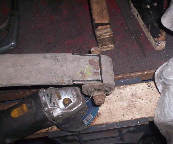

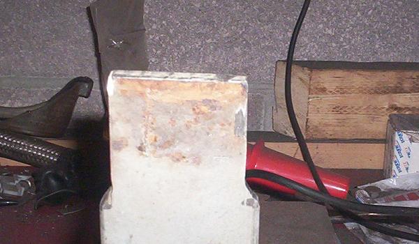

                First task was to convert the standard springs into slippers
                All marked out, angle grinder ready to go
                One slipper spring

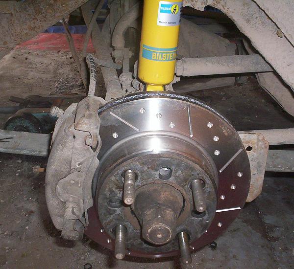

                And fitted to Fly along with new discs and shocks - the side that snapped there was a little oil on the shock absorber shaft so that might have contributed to the problem, and the discs were going rusty round the edges so the pads weren't gripping everywhere
