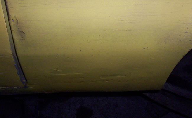

    On the last event I'd scraped the front wing on a wall, and reversed into another one turning round in a hurry

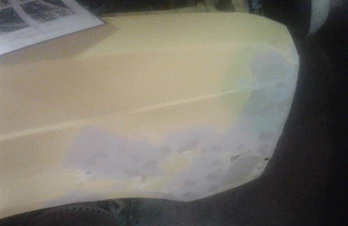

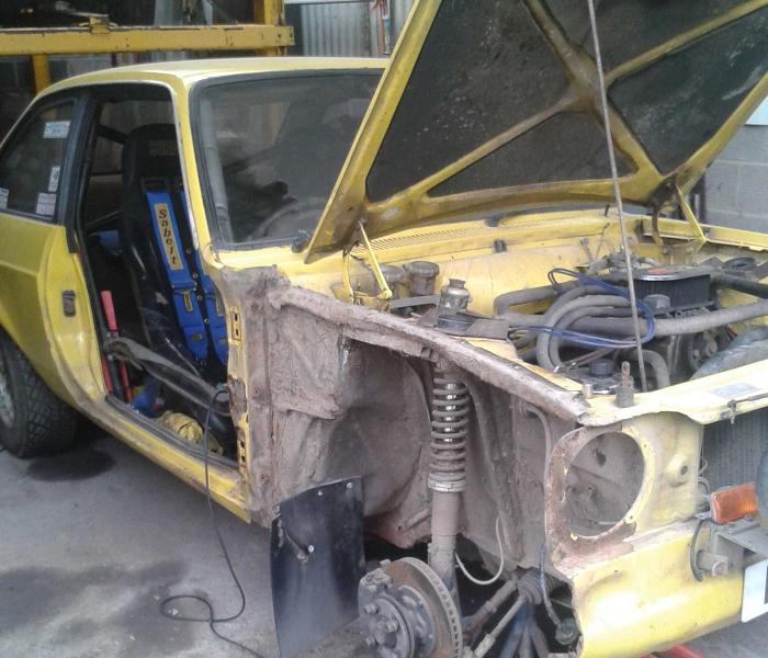

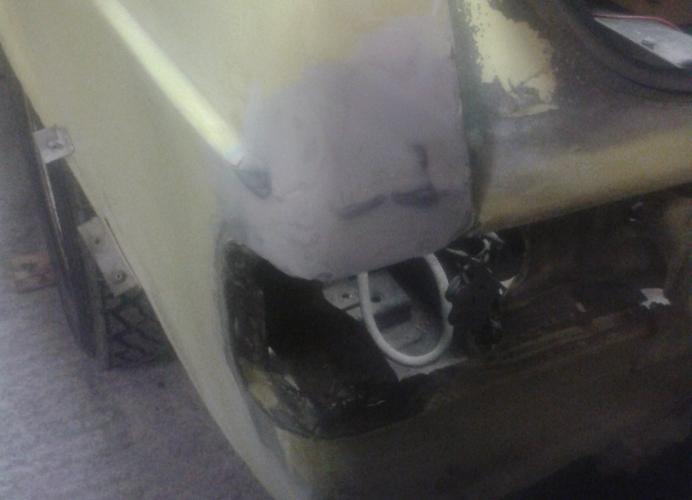

    While straightening the wing I found a crack in the door pillar so took the door and wing off to repair it
    Filled the front wing
    And rear quarter
    I've also changed the head gasket, water pump and I've got some more upgrades planned but that'll have to wait until the spring

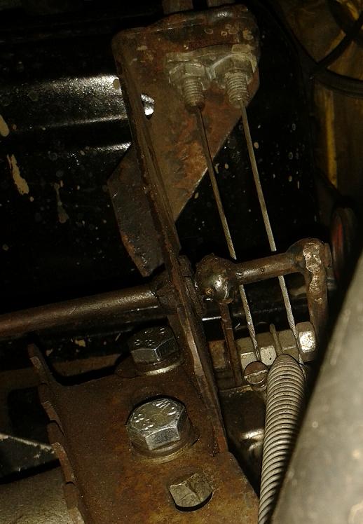

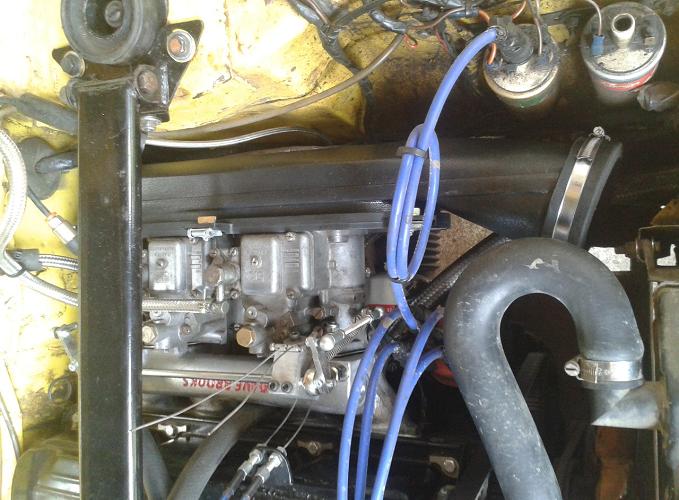

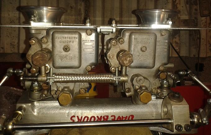

                Hi gavin
                Notice you have twin cables running on the twin choke
                Can you show a close up picture of how yours are attached the carb linkage?
                Hexham and District Motorclub
                  #473

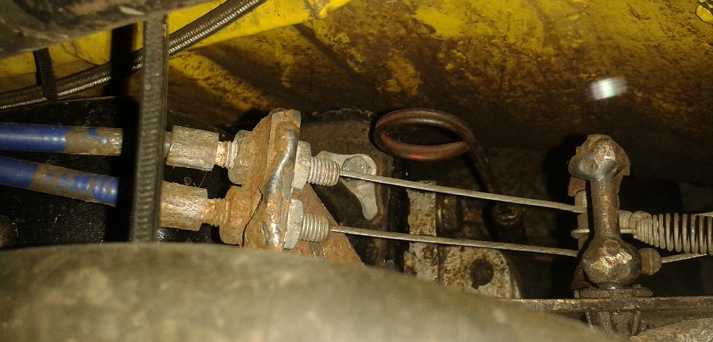

                  That's a coincidence, someone asked the same last weekend
                  I modified it a while ago by cutting the ball joint off and drilling a 6mm hole through the end of the arm.
                  Then I welded another arm on the end of the rod with another 6mm hole in it.
                  To clamp the cables, I drilled 2 x 2mm holes in an M6 screw so the throttle cables could pass through and clamped them with nuts on the M6 screw. There's also solderless nipples on the ends of the cables just to make sure they don't go anywhere!
                  The throttle cable adjustment screws / guides go through the original square hole in the bracket which has a bit of 3mm plate welded over it and 2 holes drilled for them.
                  A bit fiddly to tighten up so I did it with the bracket unbolted then bolted it to the manifold afterwards.
                  Difficult to get a decent picture, but I hope you get the idea
                  The head of the screw is on the right, hidden behind the hose, and the bit of slotted angle is only there for the extra throttle spring.
                  Thanks

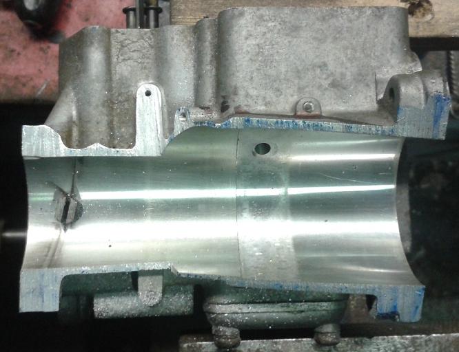

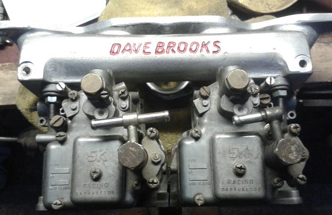

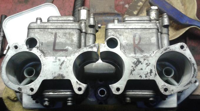

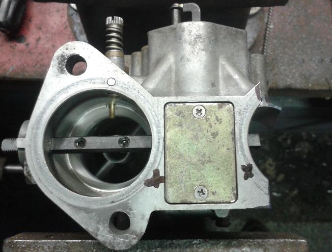

                          I'd been after another set of splits for a while now having sold the previous set about 10 years ago, but couldn't find many available or at a sensible price, so I came up with a plan to use the pair of 48 SK carbs which had been on DVY for many years.
                          I bought a new bare manifold from Dave Brooks and also borrowed a pair of Astra 8v splits so I could copy the linkage and work out how the carbs were cut up
                          After a lot of research and measuring, I got to work with the hacksaw
                          Bolted to the manifold with a few mm between them - I filed the edges down a bit more after this to get a bit more clearance

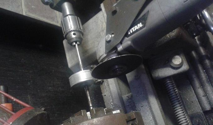

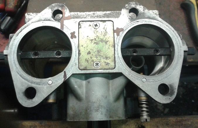

                          Machining the last of the linkage parts with the angle grinder and the lathe...
                          I bought some smaller trumpets...
                          ... to fit nicely under the Pipercross Air Box which has a sponge filter in the neck, so very quiet

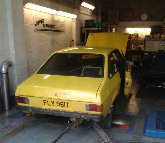

                          And a quick Rolling road Session at JPR Tuning in Yate
                          The top end power was very similar to the DGAS, but I've gained quite a lot of torque

                            cool, my guess would be the superior induction shape helped in the midrange but ultimately the total airflow potential available to each cylinder is reduced

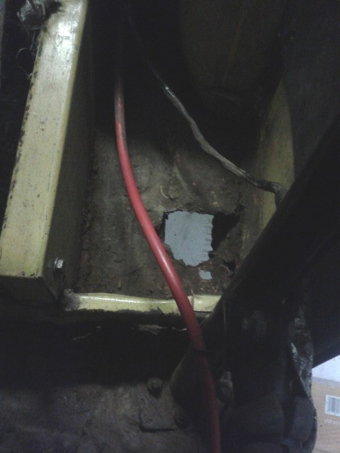

                                I had a busy few weeks leading up to the event getting Fly ready - rebuilt the gearbox as 2nd gear was sticking, fitted a new starter, clutch, clutch release bearing and cable. This last job caused me a lot of problems, the new cable came from Rally Design but the outer casing was so weak, it was clamping the inner cable as soon as there was pressure on it, so the clutch pedal was stuck solid
                                After bending the clutch pedal, and a spare one, taking the gearbox in and out a few times, I fitted a QH clutch cable and everything was fine.
                                Other than that, I had to weld up holes under the rear seat, cracks in the 4 link box, the rear seat cross member had rusted away from the floor, the rear chassis needed a big patch and the outer sill had rusted through so some filler dropped out while I was bashing everything around!
                                Big hole and cracks - repaired with a section from a 4 door
                                Dodgy filler work and a couple of coats of paint
                                Other jobs included repairing the linkage on the splits, changing a throttle cable, welding up a rusty strut top and fitting a new dip/main beam stalk (brand new made in Turkey)

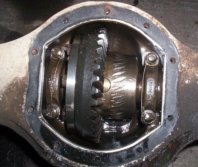

                                We stopped and had a look, but there was nothing obvious apart from a strong smell of axle oil. I didn't think it would last the next 40 miles, so we headed slowly back to Wellington where we had left the trailer and went home
                                So an enjoyable event, but surprised to be let down by the axle. I was worried the tube had come loose again, so got it out on Sunday night.
                                Investigations show the pinion bearings are badly worn (hence the initial rumble) and the vibration was enough to make the pinion nut come loose (despite having tons of thread lock on it from the last time it was rebuilt, not by me). The nut was so loose, when there was no load, the pinion was moving back until it hit the LSD casing, making some interesting teeth marks!
                                I've ordered a set of bearings and will fit these as well as smoothing the teeth marks on the casing. The pinion itself looks fine as the teeth are a lot harder than the LSD casing...
