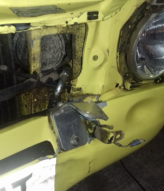

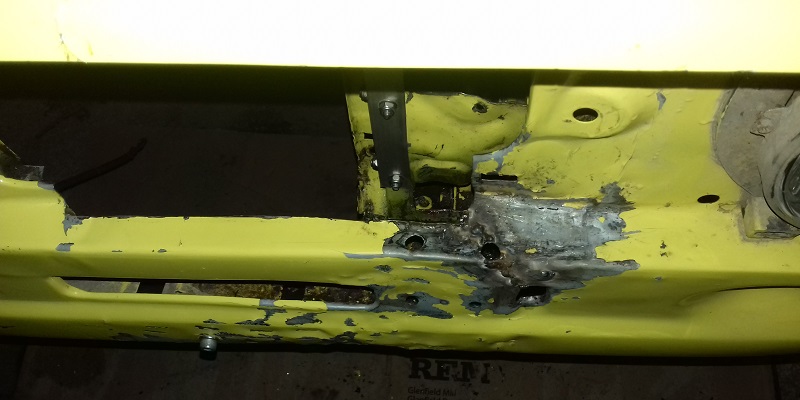

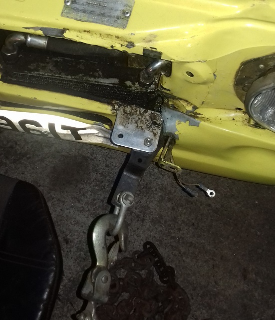

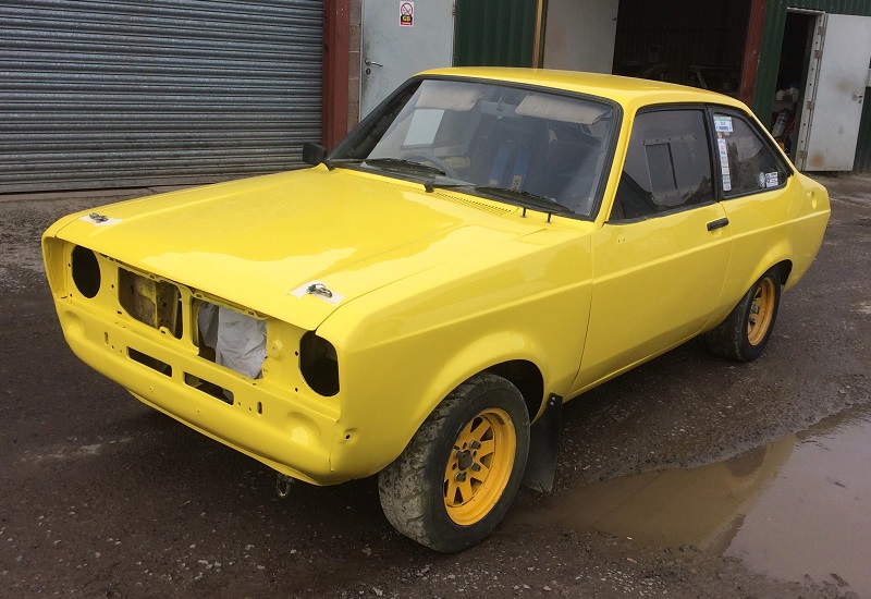

                I've been getting on with the repairs...
                How she looked after stripping some bits out of the way
                Started by winching the spotlight mount out, but this split the front panel...
                After removing the engine and box I managed to jack it out from the inside, and welded up the split so it shouldn't need much filler
                With the engine out, I've fitted new bearings just to be safe, removed the sandwich plate and put the engine back in
                I've also straightened or repaired everything else at the front (spotlight, mount, grill, bumper, etc), had the radiator recored and the ally tank repaired

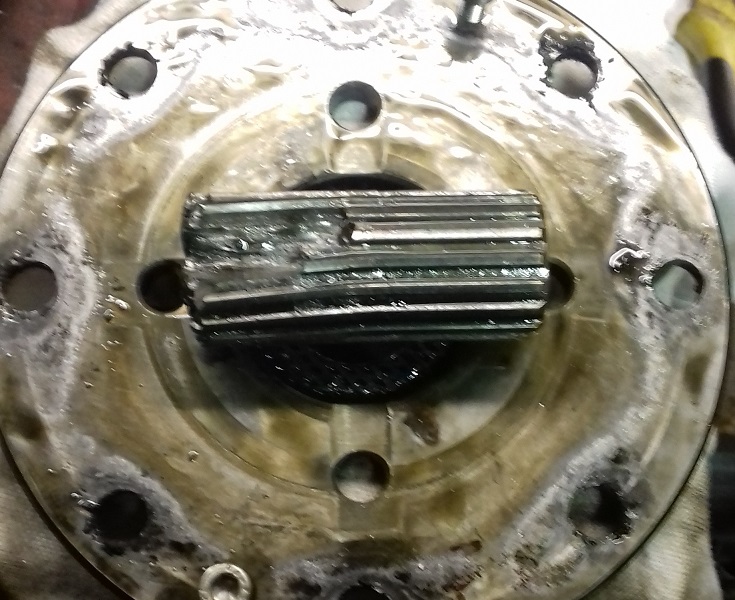

                      Coming down a narrow yellow I hit an unexpected yump quite quickly and we took off and landed with a loud bang from the rear end and the car was all over the place. Hoping it was just a link bar bolt had snapped, we stopped to check but everything was still attached.
                      It soon became clear that I'd snapped a shaft - the yump was so unexpected I didn't manage to lift off before we landed and I assume the shock of landing was enough to snap the shaft - they've been in there for over 15 years, but should be unbreakable with the power I've got.
                      We carried on slowly for a bit with one wheel drive but it was clear we would have to retire so cut route across to a control to find a marshal. We lost all drive going up a hill but I discovered I could drive very slowly in reverse, so managed to turn round and reverse up to the control at a junction - we were off route so didn't get in the way of anyway else. There was no marshal at this control so we parked up and walked 1/2 mile to the next control and found Tom Jefferis and his son marshalling. Tom competes on the Exmoor and very kindly leant us his car so we could drive back to where the trailer was parked, collect it and return his car, before loading up Fly and heading home.
                      Yesterday I gave Fly a good clean and removed the shafts in the workshop - the passenger shaft had snapped just where the splines meet the main shaft.
                      At least it wasn't the diff or CWP, but I'll strip the axle and put new friction plates in the diff as I'm sure driving with only one shaft won't have done it any good!

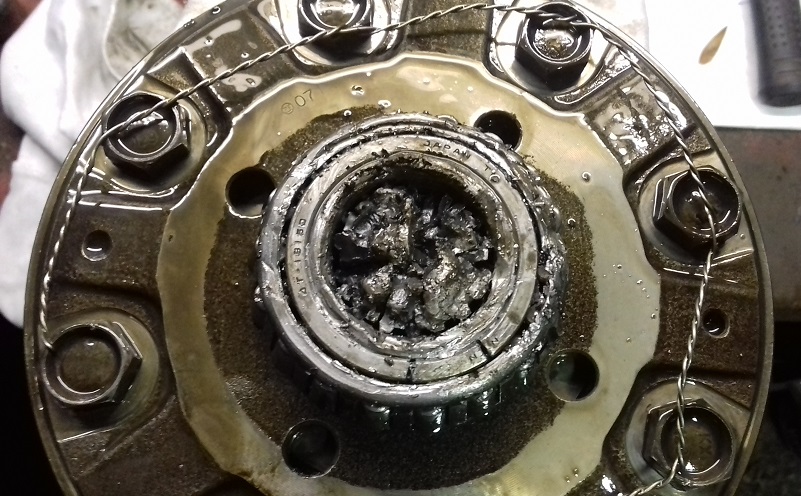

                            Stripped the axle today so I could work out which parts I need to replace
                            Before I removed the diff, I taped a very strong magnet to a spare shaft and removed a lot of broken pieces of shaft and metal swarf from the axle casing, but couldn't get the last piece of the shaft out
                            Luckily the shaft had snapped almost flush with the end of the diff so it came out of the casing with a bit of leverage
                            The side bearing was completely trashed - it takes a lot of force to split the inner race, so I think I will replace the diff end plate as well as the bearing to be safe
                            Like most shafts which break, the splines had started to twist - whether this happened as part of the breakage or it had been going for a while doesn't really matter...
