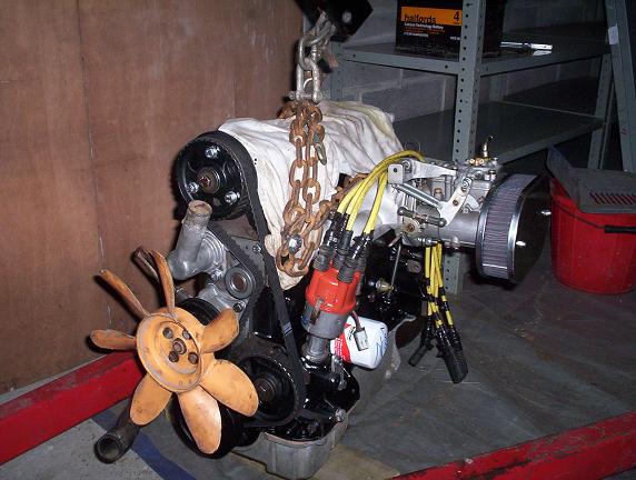

    After a busy week I had a quick trip to HT this morning (320 mile round trip in 5 hours) and collected the Pinto from Ron
    All nice and shiny, not much to mention but she's got new pistons along with the usual bearings, gaskets, seals, etc and the flywheel's been skimmed so the clutch should last longer

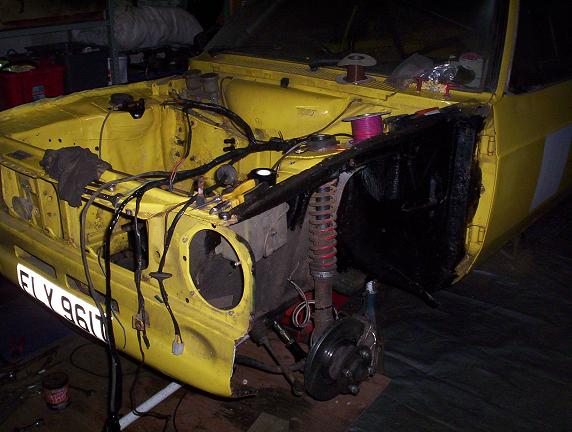

    I've got the front struts on now, new discs and back to the Princess 4 pots to make wheel fitting easier, new adjustable TCA's and polybushes from Rally Design, and refitted the RBTM's instead of the ally one's I'd been using, and bolted on the mounts for the strut brace, hope it fits with the single 45. The wiring is all put back to Pinto spec now and I've put in a couple of extra earths for the headlights
    Plan for tomorrow is to put the wiring back where it should be then drop the engine in

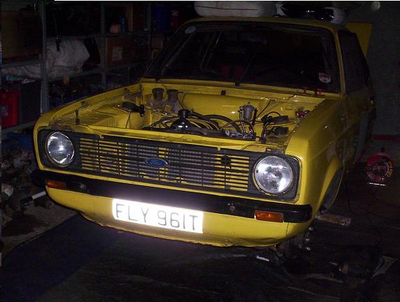

      Got quite a lot done today

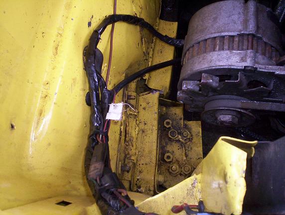

      Routed the wiring round the engine bay
      Engine in, carbs a bit tight against the inner wing but not touching
      Followed by the gearbox, rad, coils and even the front wings

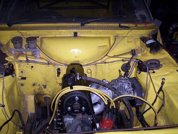

            After a few more late nights this week, the plan for today was to get the engine running
            It didn't go well when the water pump sprung a leak followed by a heater hose leaking, but I fixed them, took the dizzy out and turned the oil pump with a 1/4" ratchet to get oil pressure, put it back in in the same place, went to start her up but there were no signs of life - turning over quickly but not firing at all
            Checked for fuel, checked for spark, all ok, swung the dizzy a bit both ways but still nothing apart from popping back through the carb
            So went back to basics, set the engine to TDC, checked the rotor arm and found it was pointing to no 3 not no 1. Swung the dizzy by 90 degrees and she started first time
            I think when HT had rebuilt the engine they had put the plug leads on different plugs to what I expected, then when I collected the engine we took all the leads off to lie the engine down in the boot. And I put the leads back on differently

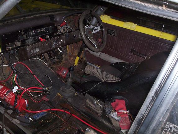

            Interior needs a bit of tidying up and finishing off

                      Fly's not quite ready yet but I got the wiring finished tonight

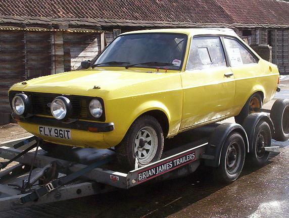

                          The first section was cancelled before the start so we started section 2 at 1am. Got to the first TC about 2 minutes late, Fly not running well (think a plug lead had come loose - she was fine through scrutineering), next section was up on the hills above Ffarmers, heavy snow started falling, coming down so fast we couldn't see the tyre tracks of the car a minute ahead

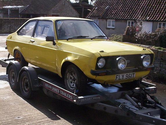

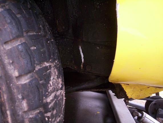

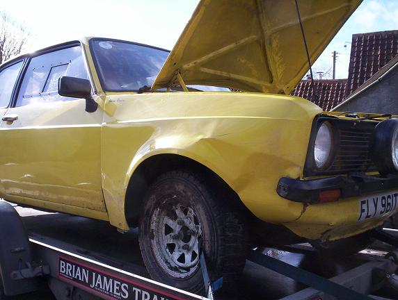

                          Past the first speccie point, about a mile later, gently downhill into a not as map 60 left, debris everywhere and gouges out of the bank, tried to slow down but we were just passengers, snow on top of sheet ice just doesn't work, bounced off the bank followed by squealing from the front tyre, carried on to a farm entrance and got out to assess the damage, along with 2 other bent cars
                          Wing bent, front wheel pushed back into the arch and rubbing, anti-roll bar bracket bent, even in a straight line the tyre was rubbing so we wouldn't have got much further
                          Looked at the map, we were 1/2 mile from the trailer so headed there and loaded up, in total we had done 8 miles from leaving the start venue to the trailer, waited for Guy to finish marshalling and then headed home, nearly jack-knifed the trailer twice on the way back, once on a straight, some places didn't have any snow, others had about 3 inches
                          Looking good from this angle
                          Bugger
                          Bugger
                          Suspicious underseal missing from inner wing
                          Double bugger
                          I'll have a good look later in the week, not sure yet whether to try to straighten and patch the chassis leg or go for compression struts

                                So I started stripping Fly tonight, removed wheels, bumper, grill, sumpguard to have a good look at exactly what was bent
                                The steering rack's ok and the column hasn't twisted - the only extra bent bit is the rosejoint where the TCA joins the WCXM, but the TCA itself and the adjuster is dead straight
                                I had a look through my spares and found enough bits to make a complete set of compression struts, but unfortunately not enough rosejoints but I should be able to get one in the morning
                                Tomorrow night I hope to have the brackets welded on and most of her back together
                                And I've fitted a new set of plug leads just to be sure
