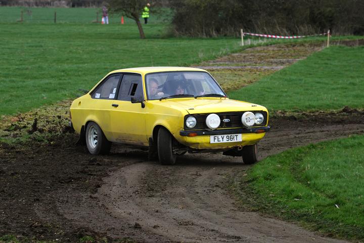

              1st Test, hairpin left, aim for photographer on the exit
              Somewhere in the second half on a muddy junction

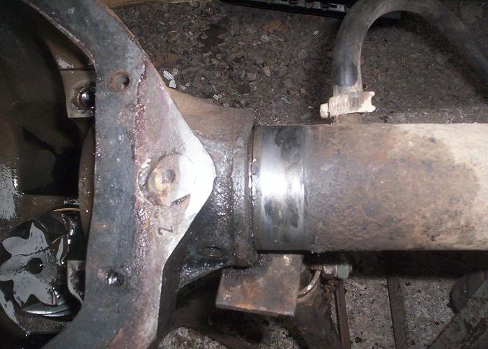

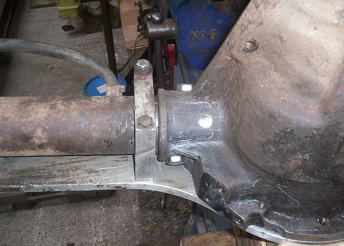

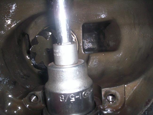

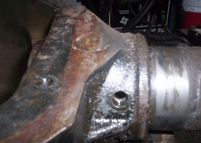

                    To cut a long story short, I put Fly's axle on Dvy for Ireland this year and we were losing a lot of oil, so when I went to swap the axles back I investigated the oil leak and found one of the axle tubes was loose in the housing
                    I'm rallying next weekend so don't have time to retube the axle so I've welded it all back together...
                    Removed the diff for better access to investigate the problem - you can see where it gets thinner to go into the casing
                    Missing pin and everything covered in oil

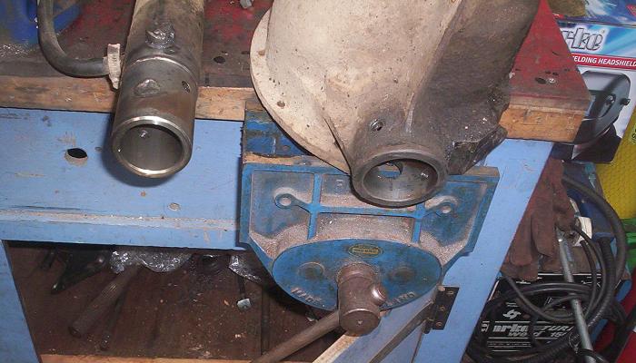

                    Balanced the pigs head in the vice and used a big socket and some extension bars to knock the tube out, it didn't take much effort

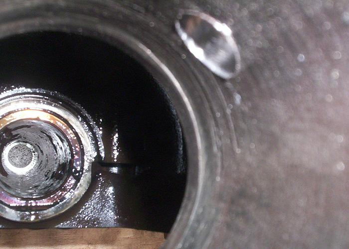

                    Tube removed, the plug weld didn't have much penetration and the main part of the plug came out of the casing easily

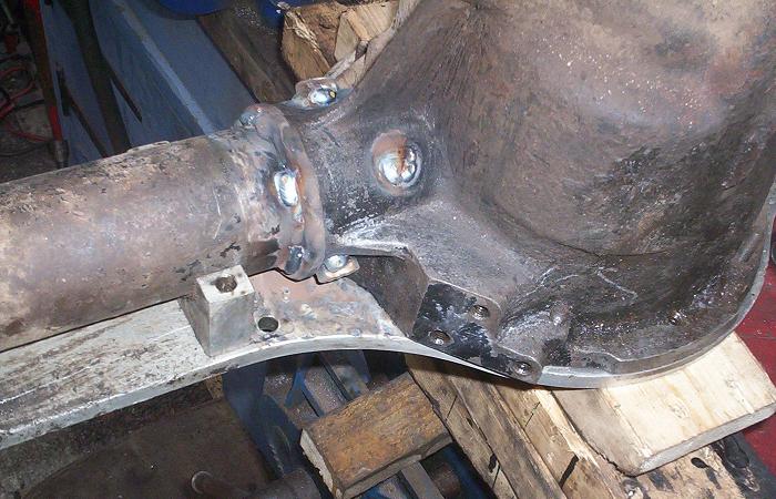

                    Retapped the pins to M10 and drilled 2 extra 13mm holes for more plug welds
                    The casing is worn at the end of the tube, but only on one side

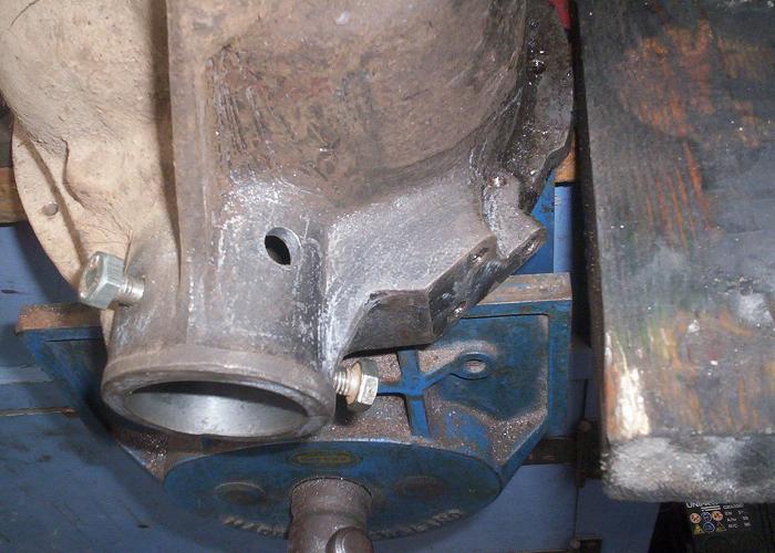

                    Cleaned everything up, knocked the tube back in and clamped it in place with the ally brace. The 2 pins are in the original holes maintaining the orientation of the axle mounts
                    Part way through welding, did the bolts up tight and welded them to the casing so they won't come out. I also welded the end of the tube to the casing inside the diff and made 3 plug welds
                    Tonight the axle's complete and ready to be refitted
