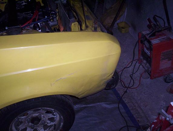

        Got Fly all done for the Gymkhana and even managed to spend a couple of hours pushing the wing back into shape, doesn't look too bad now

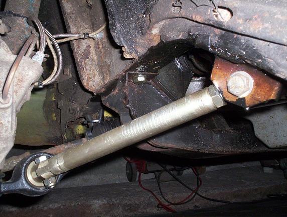

        Shiny compression strut and mount
        Didn't manage to straighten the chassis that much, when I have more time I'll chop out the bent bit, push it out and weld it up, it's quite crumbly underneath which might have contributed to how much it bent

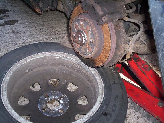

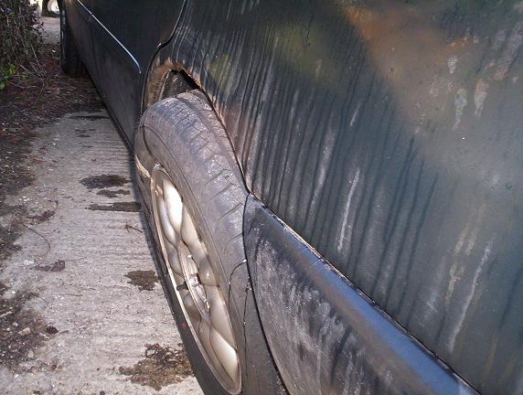

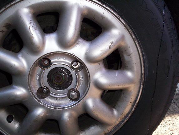

          After the Gymkhana, I dropped Derek off and headed round the M25 and home, or that was the plan, it just turned out to take a lot longer than I expected
          Going along the M25 in heavy traffic in the trusty Scorpio estate towing Fly, everything was going well until I felt a slight vibration coming from the back, so I pulled up on the hard shoulder and checked all the tyres were up. Couldn't find anything wrong so I carried on but decided to go into the next services to have a good look - it was only 10 miles away
          So I drove on a bit more and the vibration got a bit worse but I carried on as the services was getting ever closer and I was only doing 60, I'd gone past the 100m board for the junction when all of a sudden the rear of the Scorpio shot sideways, luckily towards the hard shoulder so I pulled up very quickly and got out to have a look, and this is what I found
          It was dark and I was on the hard shoulder so didn't look too hard and assumed the rear wheel bearing had collapsed, so I phoned the AA and eventually a recovery truck arrived and took me to the services. As this was a non-AA truck they couldn't take me home so I was offloaded and sat in the services waiting for the next truck to arrive. Getting slightly bored and with better lighting I decided to have a look at what had happened and it looked a bit odd as the disc and caliper were in the right place, it was just the wheel that was stuck at a funny angle. I still couldn't figure out what had happened until I took the wheel centre off and found this
          3 broken studs and the 4th nut just hanging on, I don't want to think about what might have happened if it had come off completely
          Then I realised what had caused it - I'd had 4 new tyres fitted by a well known tyre place the previous Thursday and 300 miles later the wheel nearly falls off - I won't say which tyre place it was but I'm amazed by what they did
          After a few more AA trucks I eventually arrived home at 4am on Monday
          After a few hours sleep I got up and went to work in Fly (the van had failed its MOT on a couple of patches of welding and I hadn't had time to fix it)
          Tuesday I took the pics you see above and armed with 3 wheel nuts with half a stud in each, a receipt for the tyres and a set of the pics I went back to the tyre place to sort them out
          When I put the first nut on the counter, the manager was amazed and said he'd never seen that before in all his years of fitting tyres, so when I added the 2nd and 3rd nuts, the pics and the receipt he knew he was in trouble. He checked with the 's out in the tyre bay who swore blind they always use a torque wrench but it was pretty obvious what had happened (I check the torque of the other wheels, all done up to 110lb ft instead of 65lb ft, the first vibration must have been when the first one snapped, then this put extra pressure on the others so the vibration got worse when the next one snapped, etc)
          Still not admitting liability, the manager phoned up the local Ford dealer who had 3 studs and nuts in stock so one of the lads was despatched to get these. That night I fitted them so the Scoprio was drivable and Thursday took it back to the tyre place who changed the other 13 studs and nuts - they said this wasn't necessary but I insisted on it. I think it cost them £120 in parts alone and I saw all the old ones so I know they did every single one
          Don't think I'll be going there when I need some more tyres

            Good for you doing that Gav, sometimes people don't do that often enough!! Glad it didn't end in a more dangerous way too!
              • 2437
              Re: GavinRs Mk2 Rally Car FLY
              bloddy hell thats lucky i just had two tyres fitted to mine
              just been out and checked them glad your ok and fly is back flying

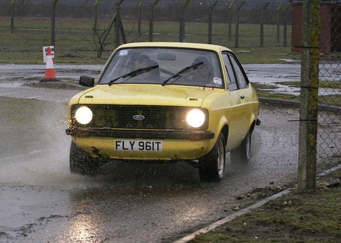

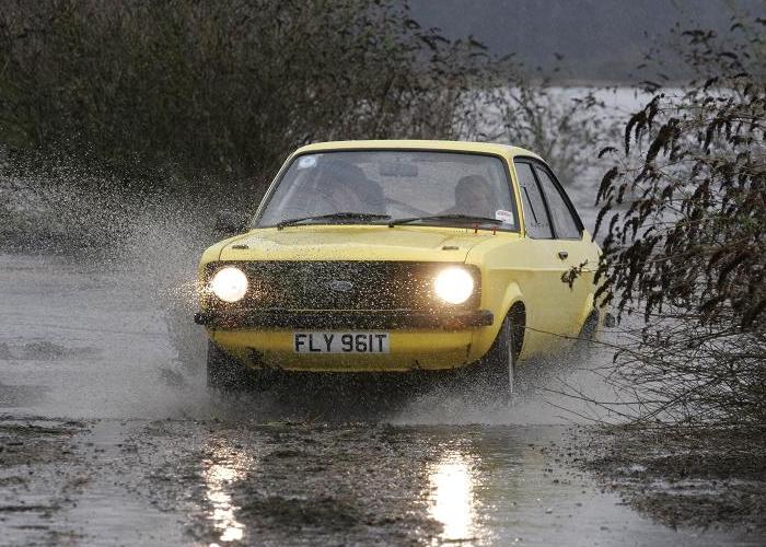

                A couple of pics from Woodbridge in Feb
                Myself on about the only narrow bit there was
                Derek enjoying one of the sections through the buddleia bushes

                  Looks like you need an out board motor there Gav

                    jesus christ i cant believe that how tight must they have done them up cant believe that
                    just glad it wasnt any worse for you!
