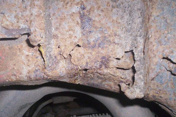

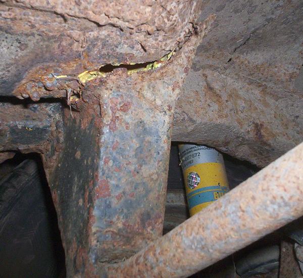

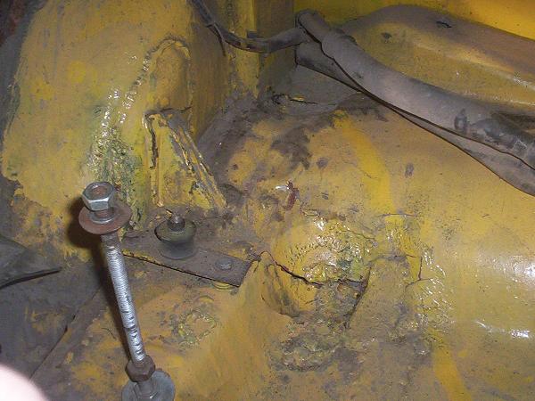

    After removing the tank, large cracks in the boot floor
    Even worse underneath, Panhard Rod mount not connected to much

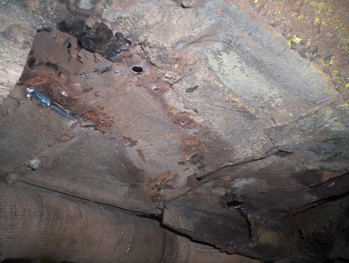

    The drivers side chassis rail has collapsed inwards and the bottom of the turret rusted away - years of being pounded by the bump stop has taken its toll

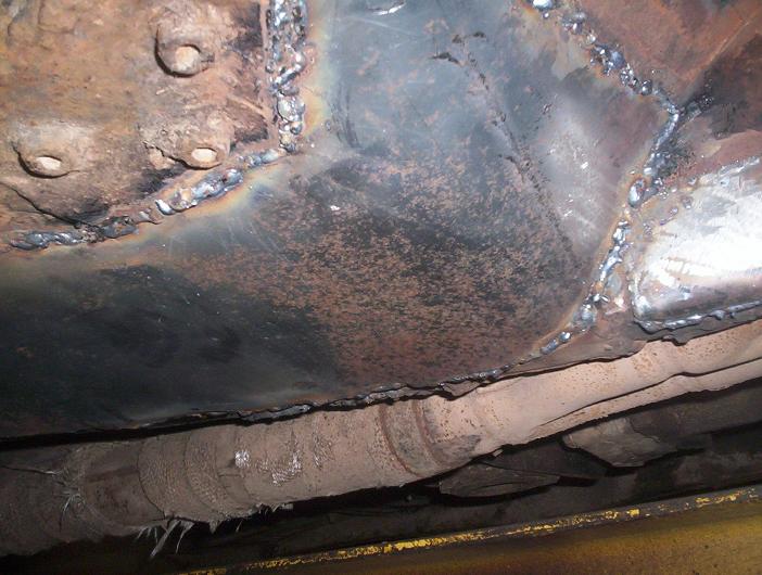

    After putting the Panhard Rod mount back to where it should be and welding it to the boot floor, I cut out some of the chassis rail and inserted some thick box section with a notch in the bottom for extra clearance. The passenger side isn't as bad but I'll notch it at a later date

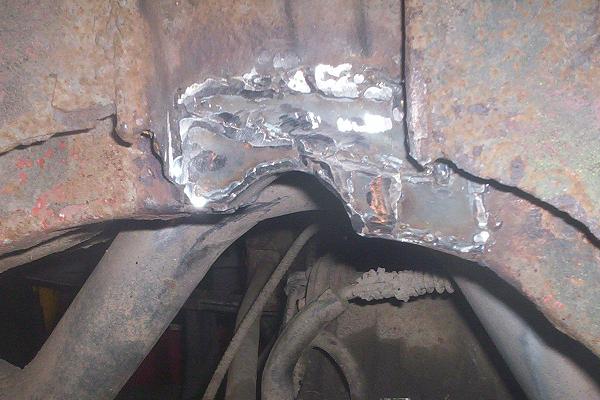

    A few years ago I was gently rear-ended and although it straightened out pretty well, it had left some cracks round the rear light and these were going rusty. After a bit more straightening I cleaned them up
    Welded the cracks and put plates behind the bigger holes
    Ground the welds down, some primer and 4 coats of paint, looks a lot better than when I started. I also welded thick washers on for the main battery earth

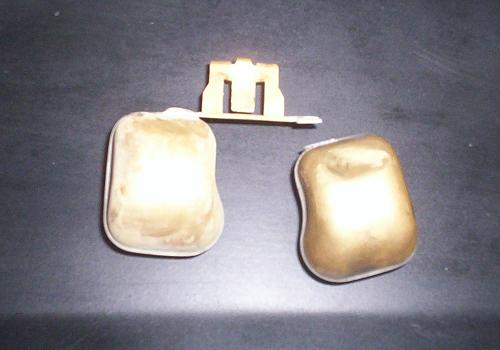

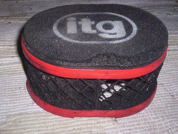

    Assuming this was the problem, I removed it, threw it in the boot, Fly fired up and we were a couple of minutes late into the next control. Something still wasn't right, cruising along a B road on the next section she was still missing a bit and when we got to the next control she cut out again and we only just got her going as our time came up. The next section was down some twisty lanes and even though everything was just about ok flat out, every time I slowed for a corner she would cut out and either stall or slowly spring back to life. George and I agreed we couldn't carry on like this and as we were only 5 miles from the van and trailer we decided to call it a night before we completely broke down in the middle of nowhere!
    Even trying to do these 5 miles was a challenge, so I pulled up again and had a better look at everything. To my surprise I found the top half of the carb was loose, 2 of the screws were missing and the other 4 were only held in by the filter base plate. I got a few tools out and tried to screw it down, but there was something in the way so I took the top right off, found the accelerator jet almost unscrewed and a float floating in the float chamber
    So I chucked that in the boot as well and screwed everything down tight. George turned on the pumps while I watched but the single float wasn't strong enough to close the needle valve so neat petrol was flooding into the engine, no wonder it wouldn't idle! Anyway after a few minutes she started without the pumps on and we got back to the trailer and home without any further incidents. I assume the float had come off over one of the bumps on the first sectioon and the resulting misfire and petrol going everywhere had allowed the rest of the carb to come loose...

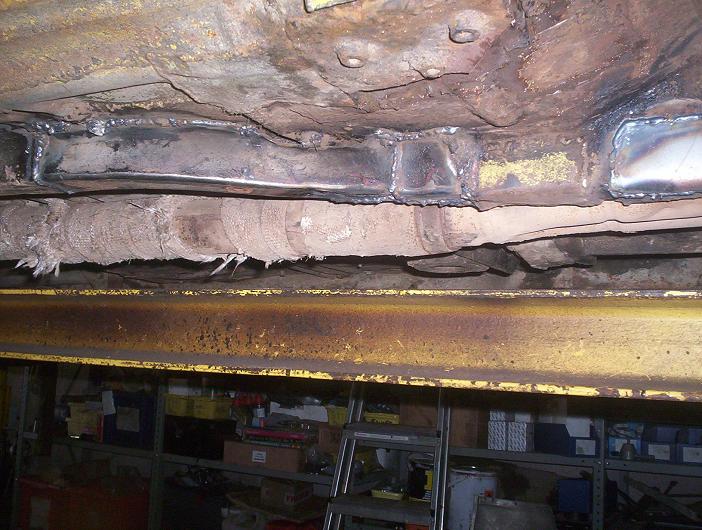

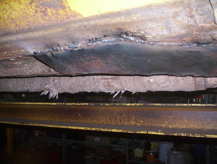

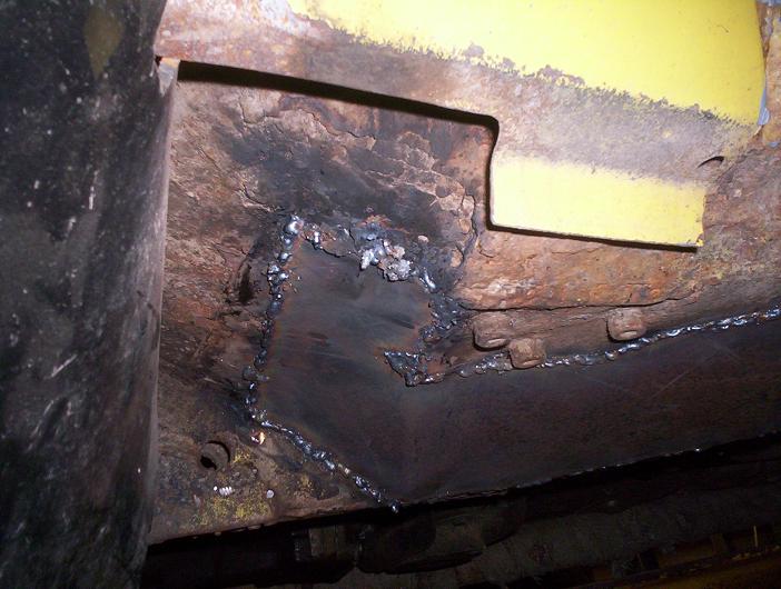

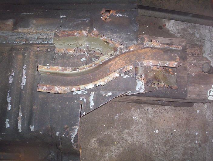

                The drivers chassis under the footwell had been squashed a few times on road rallies and doing a few forest events over the past few years had made it even worse
                So I cut the bent section out
                Cut a replacement section from a 4 door floorpan
                Welded it in and plated some other rot
                Then fashioned a skid plate from 2mm sheet

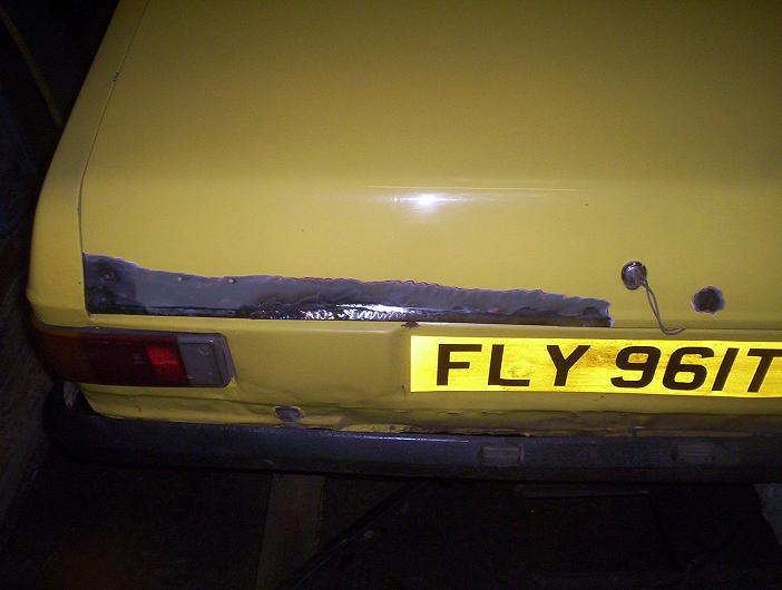

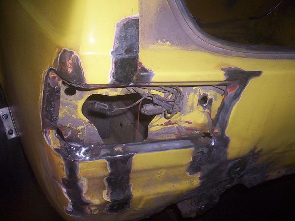

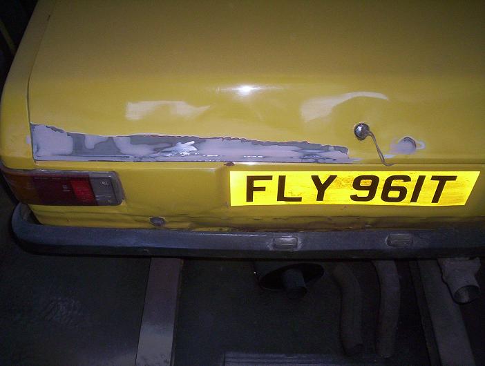

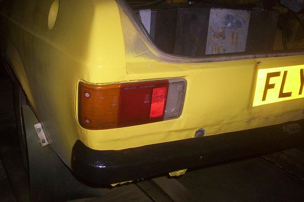

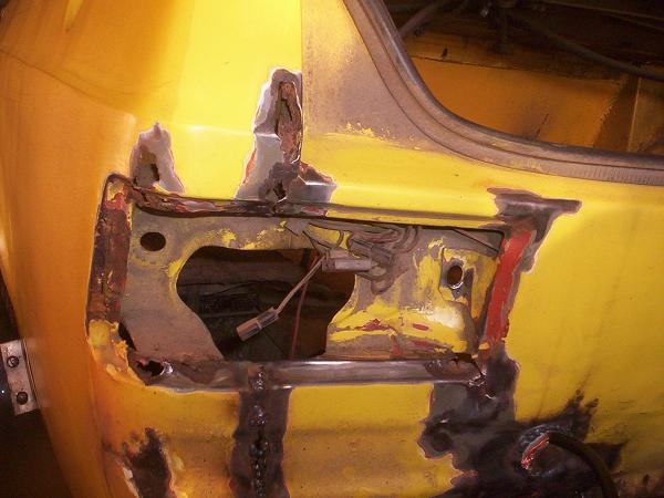

                  The boot lip was cracked and going rusty in places so I welded in a new section

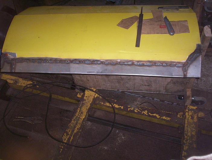

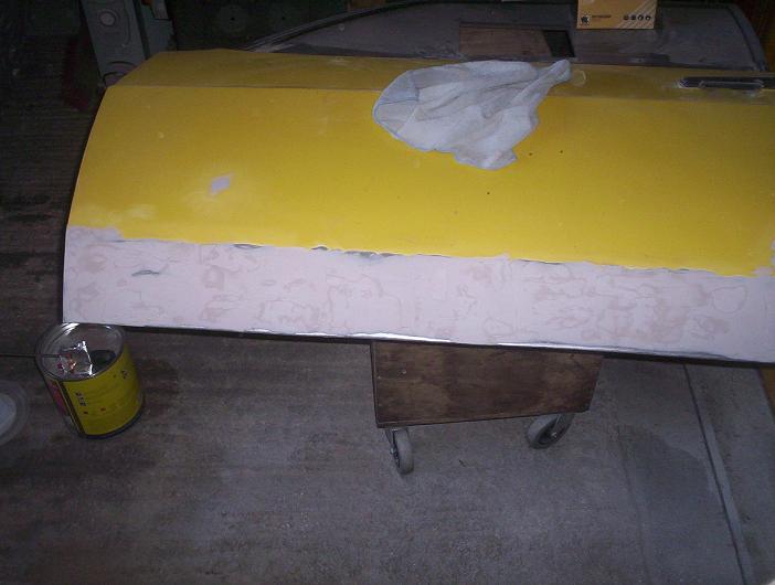

                  Passenger door was getting really bad - I'd repaired it in the past with filler and fibreglass but the rust was coming through again, so I cut the bottom of the door skin off and welded in a new section. The front and rear corners had gone almost up to the swage line
                  Filled the door
                  And the boot lid

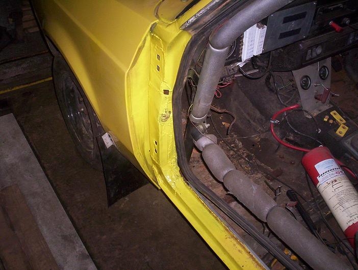

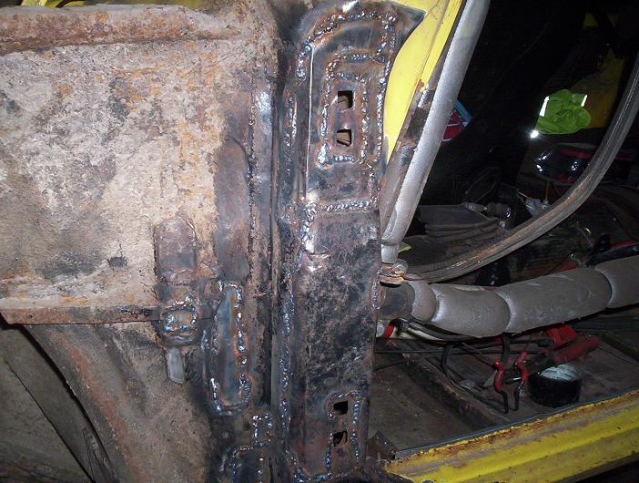

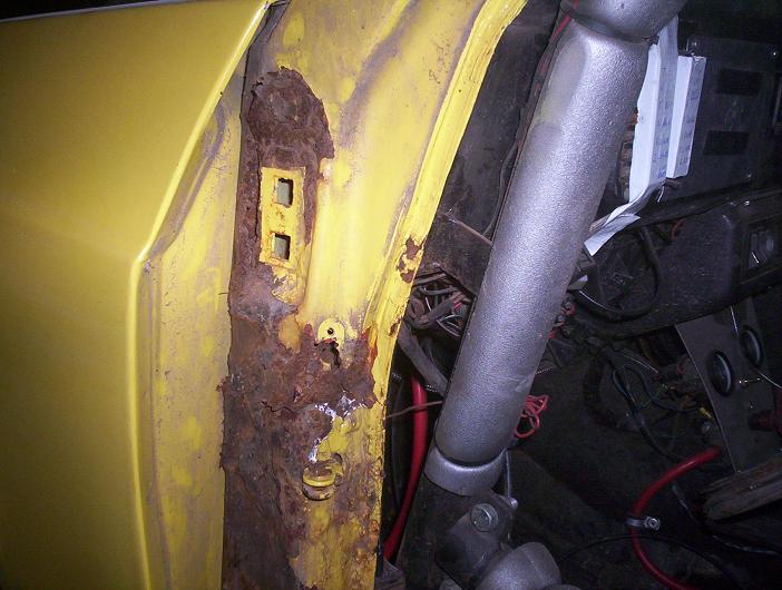

                  Taking the door off revealed a rotten door pillar - it's double skinned round the hinge holes and a lot of this had rotted out
                  Part of a replacement sill made a good repair panel and I removed the wing to get access all round
                  I still had a few litres of cellulose left over from previous repairs, so mixed it up and sprayed the boot and door
                  Then the door pillar

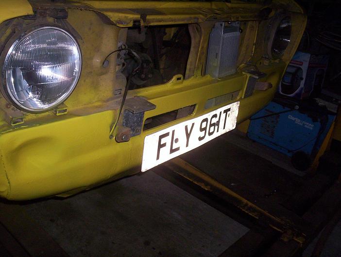

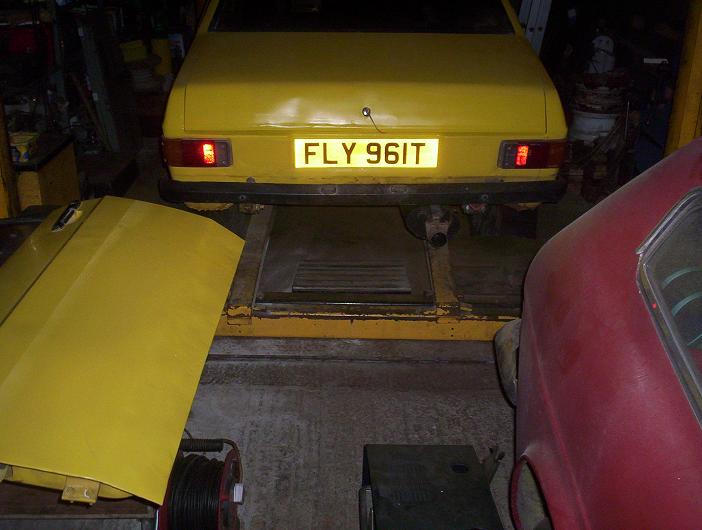

                  And as it was going well and I had some paint left in the gun, I gave the front panel a few coats (I'd wire brushed and primered it a few days earlier)
                  While I was there, I fitted an oil cooler (just waiting to be plumbed in). I've also redone the radiator cut out and replaced the rear silencer with a bigger one as I was on the noise limit on the last event

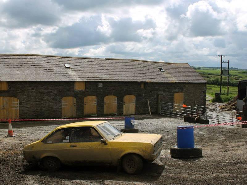

                          Same as last year, the event was based at Jamie Jukes' farm in Penrhiwllan near Llandysul and there was a full entry of 75 cars plus reserves

                          There were 20 Tests, with the first one round the gravel tracks at the start venue which had been extended from 2013 to give a 2 mile test, with some steep hills, some fast downhill sections, a shallow ford and a couple of yumps! A great way to start the day although the damp weather made everything very slippery, I've never used the handbrake so much on the tight corners
                          The organisers had also been out with machinery on some of the more well used tracks on other farms making them smoother and keeping the farmers happy

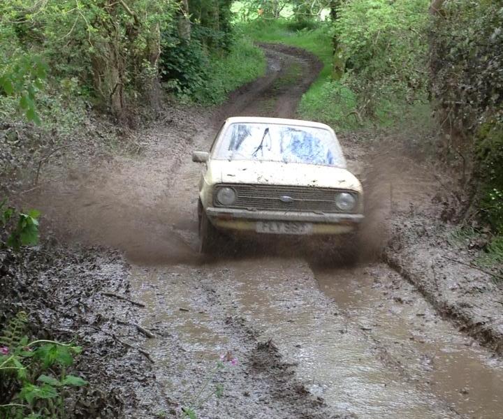

                          Some sections were rather muddy though...
                          We had many moments throughout the day, being flagged down on an early test when the car in front drowned out in a ford, luckily there was enough room to go round them, getting very close to a number of sheds, barns, bales, hedges and banks, and overcooked a couple of hairpins, our rally nearly ended in a large log pile at lunch time, but we got away with them all and Fly never missed a beat, only a slight rumble from the front end on the last road section gave us any cause for concern (traced to a knackered wheel bearing)
                          All the tracks and farms were laid out very well, plenty of arrows and tape, making sure we all went the correct way
                          I think this picture is from Pant-Sod farm which has been very tight and narrow through a shed in the past, but a new route this year was great fun, I got Fly swinging nicely round the double hairpins through the tyres

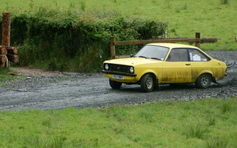

                          Overall we had a great day, kept it tidy on the slippery bits and flat out on the rough stuff resulting in a clean run through all the tests
                          We finished 4th overall, just 16s behind 3rd but 4-5 minutes off the top 2 crews, both in Mk2's as well

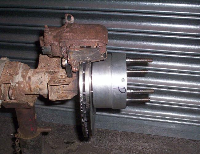

                              I'd run Monte Carlo discs and calipers on the front when I was hillclimbing and still had the calipers and some spare discs on the shelf so I thought I'd put them back on. Unfortunately when I looked at the discs they were well worn, so I got some new ones from Peter Lloyd together with some DS3000 pads and fitted everything up, carefully spacing the caliper as far back as possible which means some of my 5" & 6" Wellers will fit - the Princess 4 pots and discs will be up for sale shortly

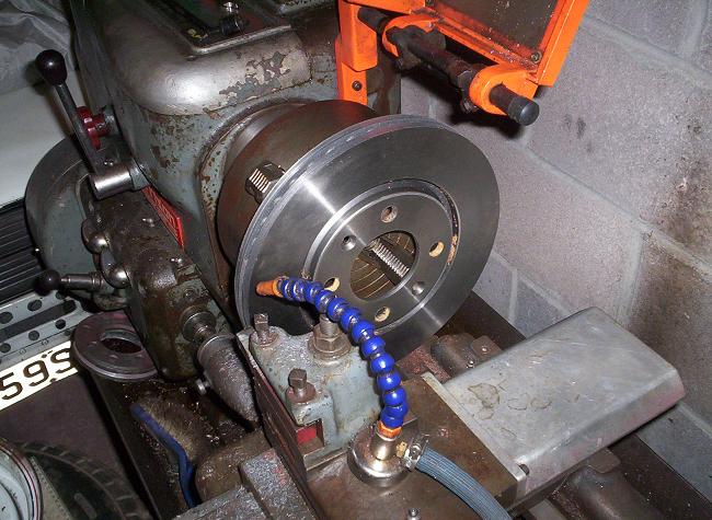

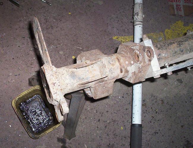

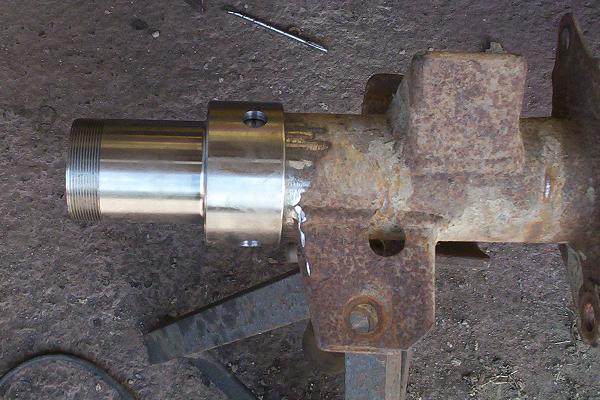

                              After having wheel studs snap on Fly and Dvy in consecutive years, and after some advice from Simon (Gp4), I decided it was time to move up to the twin taper fully floating set up. I bought all the parts from Grp4 Fabrications with Group 1 studs instead of the Group 4 studs
                              Removed the Quaife Hubs

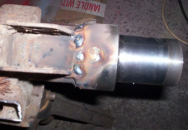

                              Chopped the bearing carriers off as far out as possible and pressed the new stub axles on, after a lot of measuring to make sure the wheels would be in the same place
                              Welded them in place a little at a time with frequent checks for squareness

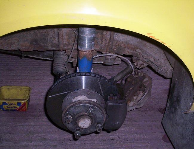

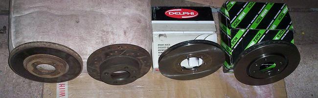

                              As Fly's axle is rather narrow at 47.5" casing width, but I still wanted to use the XR3i calipers, I knew sorting out some discs would be interesting
                              From the left, Rally Design discs for Princess 4 pots, XR3i discs, Mazda pickup discs (6 stud but the same 108 PCD so would only need 2 holes drilling) and Peugeot 406 260mm discs, showing the difference in offset of them. If I tried to use the XR3i discs, the disc would be in the middle of the rear shocks...
                              Tried the Mazda ones on, not bad as 20mm thickness and no offset
                              But settled on using the Peugeot ones as they were the same thickness as the XR3i ones (24mm) so fitted the calipers better, and only had 4mm offset. I machined the bore out to 71mm, turned the diameter down to 250mm and enlarged the stud holes to 15mm so they were a good fit over the studs
                              Once the discs were on, I positioned the caliper brackets and welded them on before heading off to another Targa Rally on 13th July...
