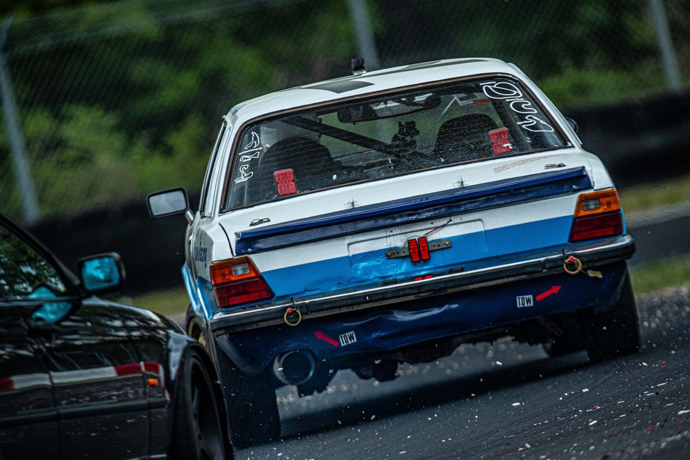

A nice ride along with my car. I removed my rear spoiler and my top speed went up. From 150km/u to 165km/u max speed in 4th gear. What a spoiler can do actually, I didn't notice any los in traction. So spoiler stays off.

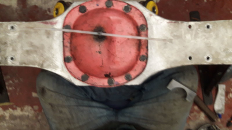

Now hopefully next time i can get more top speed in my car. Going to change rear diff from 3.78 to 4.11. Top speed will be lower in 4th 150km/u but hopefully 5th gear with 4.11 will still pull to more speed then 165 :-)
