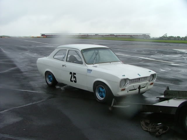

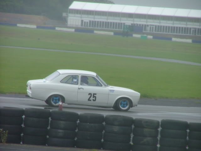

    Here is my ex production rally cross 1300gt,now fitted with a 1700 crossflow which is built to a simple but effective Spec:711m block,standard crank,lightened flywheel,highly modified,lightened,stress relieved and polished rods,arp bolts,high pressure oil pump,Kent 264 cam,duplex vernier timing gears and chain,accralite pistons (modified to give 12:1 compression ratio),copper head gasket,old spedeworth 1600 hotrod spec flat head with mexico sized rimflow valves,steel rocker posts and gear,mass exhaust manifold with twin box 2.25" system, twin 45 webers and aldon vacless dizzy with ignitor.Radtec alloy rad.WCXM.
    Tran-x straight-cut gearbox,5 linked english axle fitted with a plate type lsd.
    Bias pedal box,fiesta mk1 rear discs and calipers,ap 4 pot front calipers clamping on 257mm discs.
    Rosejointed,adjustable front tcas,anti-dive kit,concentric top mounts.Quick rack.
    2.25 coil overs with Koni inserts all round.
    6X13 Revolution rims with Avon slicks.
    When I bought the shell 5 years ago it was described by the seller (N&P at gatwick) as being very sound but a little dented,that was NOT so!! I ended up doing lots of welding and also 5 linked it while I was at it in fact I did all of the work on the car including building the engine, making the front struts and letting in the mexico arches to the front wings myself but I got a friend of mine to spray the outer shell.(I did the prep and painted the underside,engine bay and cockpit).
    At Goodwood I have caught an Ac Cobra 289 and TVR speed six and given some others a fright including an Audi Quattro Turbo (not allowed to overtake though).If there's anything I've missed please ask
    I'm now hoping to take part in the DTRC so I'll probably see some of you about

    Nice car. About time you got some piccies up
      Re: Pushrod kings MK1 Escort hillclimb/sprint car

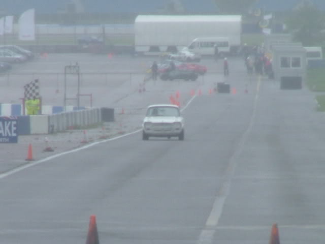

      Thanks,how does it look in action Andy? There are a couple of other pics that a mate of yours took and put on mrjimbos' competition car thread
