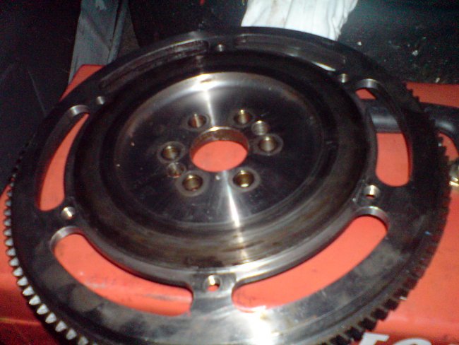

Spent some time on the car today,took the engine out removed the sump,flywheel and clutch.
The oil leak was caused by a small split in the sump
Easily fixed anyway

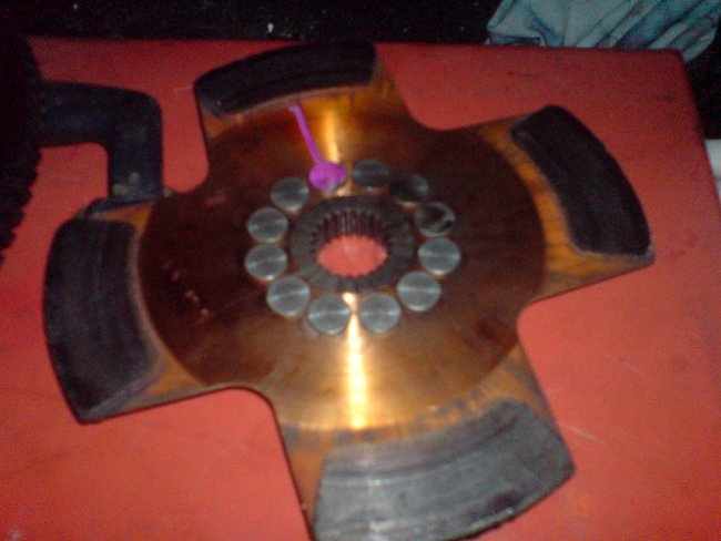

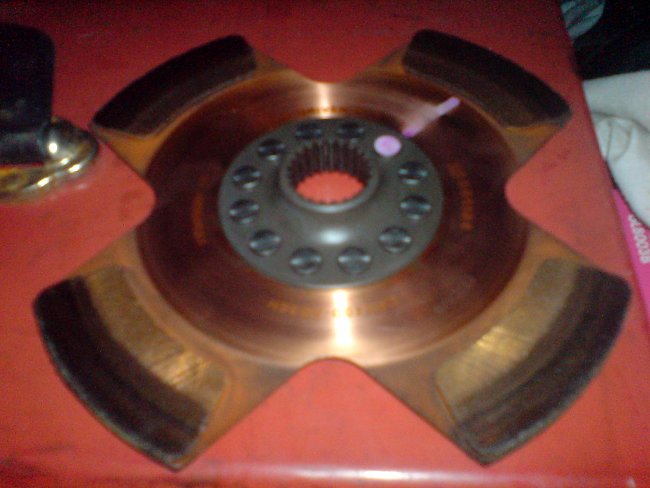

The clutch is more of a worry,looks like I need another friction plate and a new pressure plate in the cover assembly
If you look at the pictures you can see that the cover hasn't been contacting the centre plate (1/2 black 1/2 shiny bronze) this is because the face hasn't worn level so the assembly doesn't sit flush!
