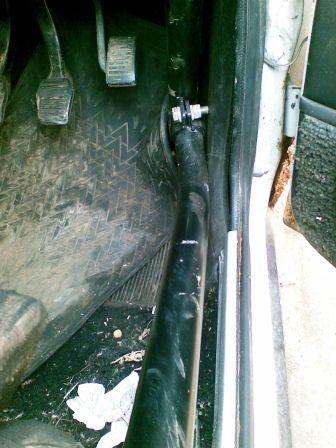

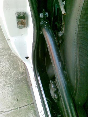

      After seeing the damage to Andys' car I'd really like to have the door bars shaped so that they curve out into the door apperture the same as the hot rods use
      maybe mk1's are different but in my MK2 which has a SD cage if you had a curved door bar you would have to gut the door or it wouldnt shut
        #33
        Re: Pushrod kings MK1 Escort hillclimb/sprint car
        OK,OK Tom>>> don't rub it in thank god you dads not in the same race class
        Graham,the doors are already gutted (it's a race car) but are alloy panelled (inside) at the mo although I'll probably get some kevlar doors or skins ( was already looking when you told me your plans Andy)now that they're more readily available as you know weight is a real disadvantage to a racer.(just wish I could lose weight so easily)
          #34
          Rollcentre racing do a weld in kit that can swoop out into the door, you'll need to tweak them though as they are a universal fit, have a look at Retro Als door bars
            #35
            Thanks Gary,I was thinking of bending some tube up myself and possibly copying SD s universal bolt on clamps so they stay within the non modified rollcage rules.But thinking about it the blue book states homoglated rollcages, mine's way out of date so I suspect the rule doesn't count
              #36
              not quite, your roll cage will have a drawing number that is held on file with the msa, a competition roll cage has to comply with what they have on file irrispective of whether is 6 months or 60years old, or it needs specific certification from the msa
                #37
                There are other cars with modified SD cages running in the DMN,what are the chances of them having certification? Or can you get away with certain changes? OR would it be ok if they stay the same as the drawings in the blue book ?

                  i modified a cage and got away with it for years until i ran into a stroppy scruit, eventually he agreed to let me out and i continued to race with the same cage until i wrote the car off a couple of years later.
                  if you stick to having bolt on additional reinforcements as per the blue book your be fine
