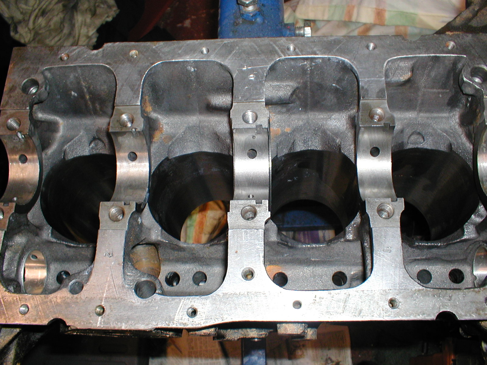

                          Sorry Bud,didn't really have time to take many pictures but here are the ones that I did take.
                          These show how I've matched the inlet manifold to the head (taken before I finally polished the ports).
                          And this one is the basis of my new engine: (Yes it IS a brand new Block) This has now been built up using a balanced cast crank, new set of Accralite pistons,new con rods (to my usual spec), a one off Kent cam,duplex timing gear kit (off set dowelled to save weight),new bearings and pumps etc.
                          This one shows the engine just before I fitted it this afternoon:
                          The car was supposed to go on the rollers today but due to problems with the rings which delayed the build I had to postpone the session until next week
                          Will put some more piccys up when I've taken some.
