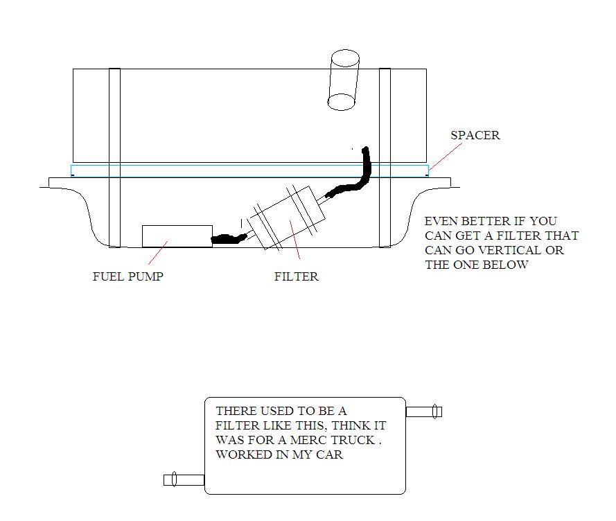

                  Nick, just looked through your thread and not one pic of your boot / tank area .. so i'll assume that you have a rally style tank and fuel tank stand, this is raised above the level of the boot floor, now what you do cheaply is get something to stick under the tank to raise it a bit more, and get a fugging huge fuel filter, diesel or something like that, plumb that into the line from your tank to the pump, you now have a small tank thats fed from the main tank, for a couple of quid you'll find out if its fuel surge.

                    Gary,I've got a square 4.5 gallon alloy tank mounted on the boot floor.I have thought of tilting it forwards as that's where the pick up is.
                      #130
                      i'd still fit a large filter ... or get the the fab gut to open the tank, fit a sheet inside with a 2" swaged down hole in the center inside .. about an inch above the bottom, and get him to fit an outlet in the inch space .. hate using push pumps as vacumn pumps..they are not designed to lift
