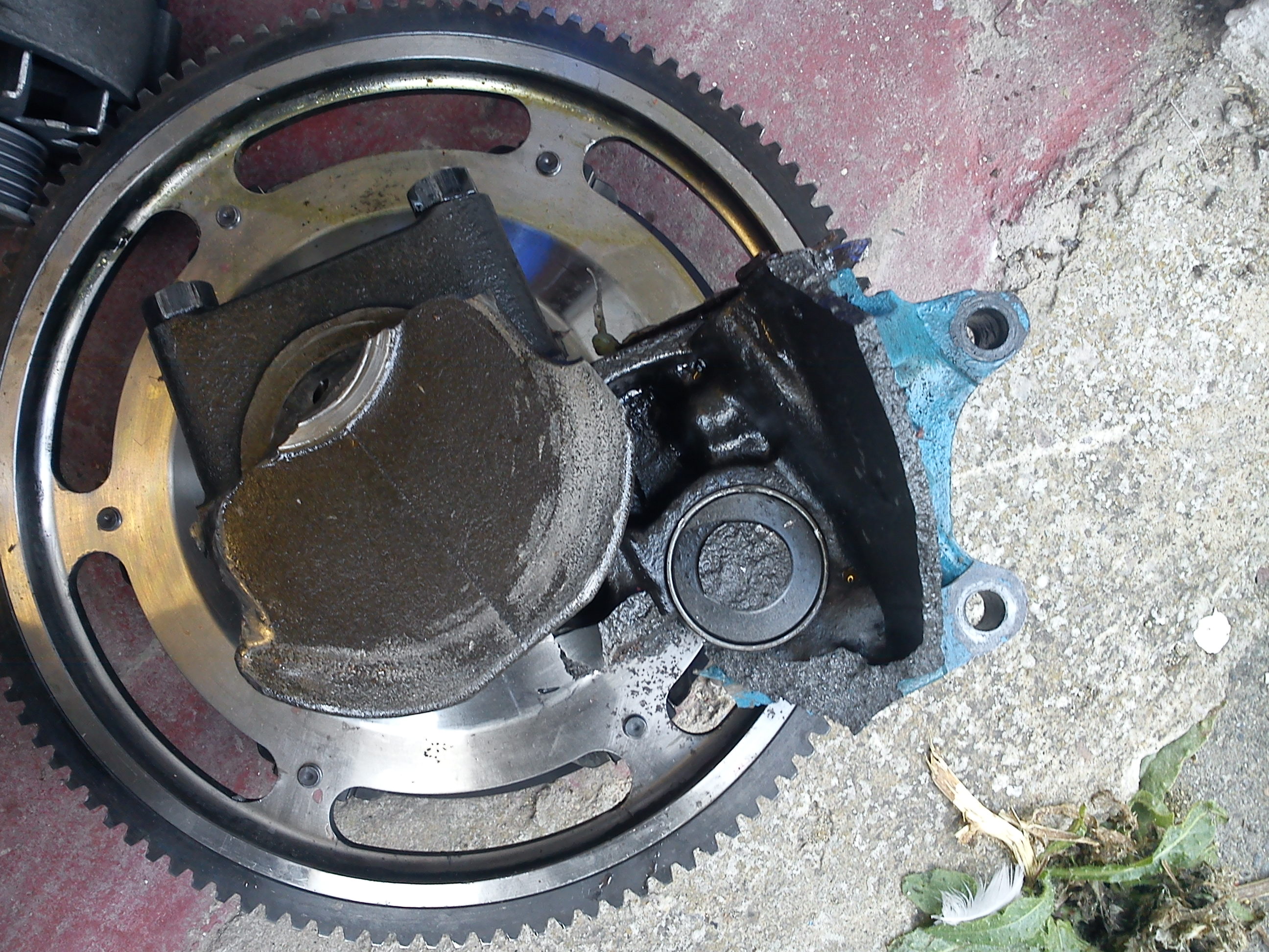

                  Had a bit of trouble in qualifying,coming along the start/finish straight there was a loud bang and the car suddenly lost all drive!! I think this may be the reason why!

                      rear web thats where x/flow cranks tend to fail, FF1600's which have to run std cast cranks change the crank every couple of seasons
                        #281
                        I generally get my cranks crack tested anually but didn't for this year due to supposedly running a new engine. Is my luck this year going to get any better?.....Bloody hope so.

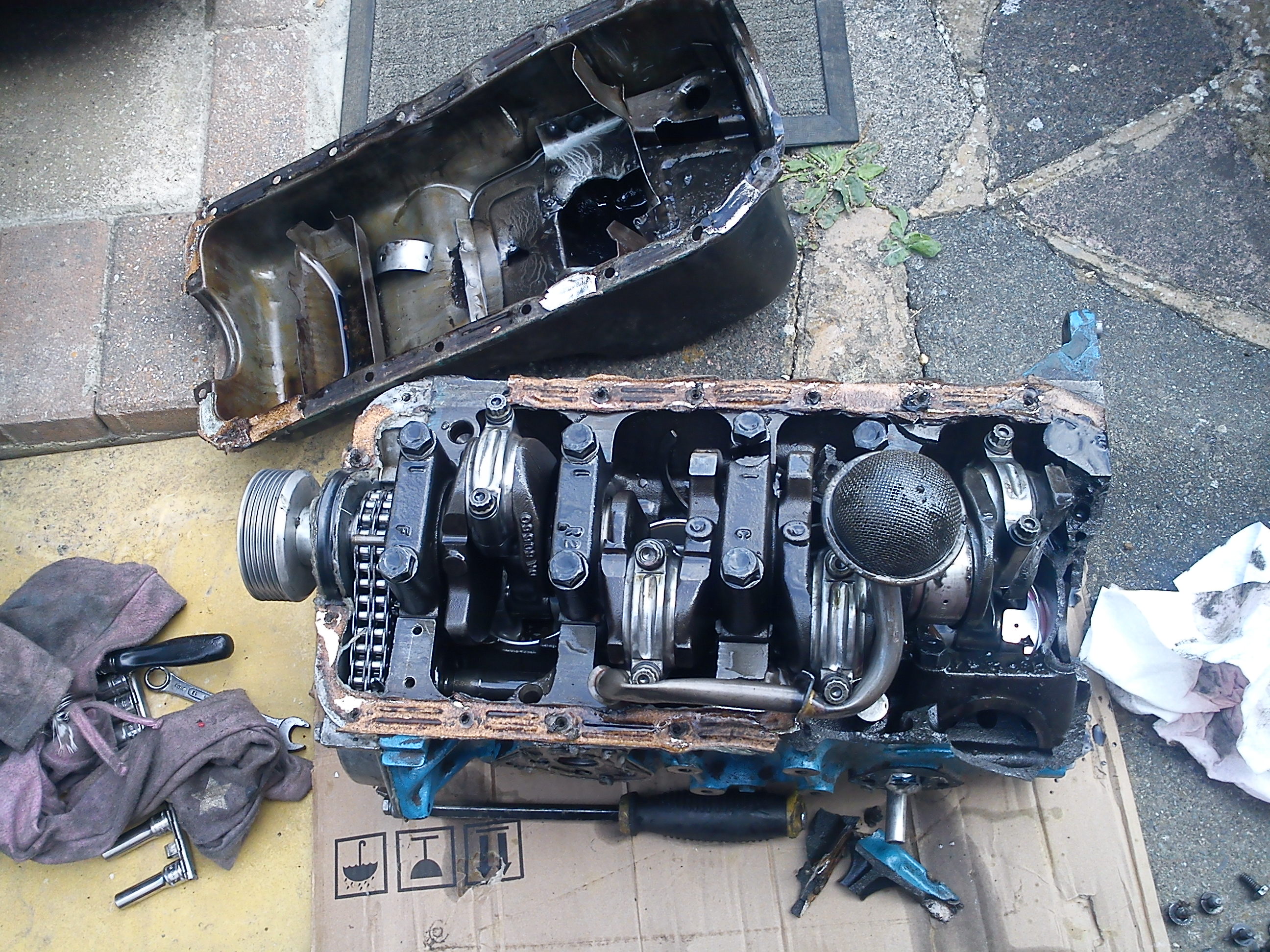

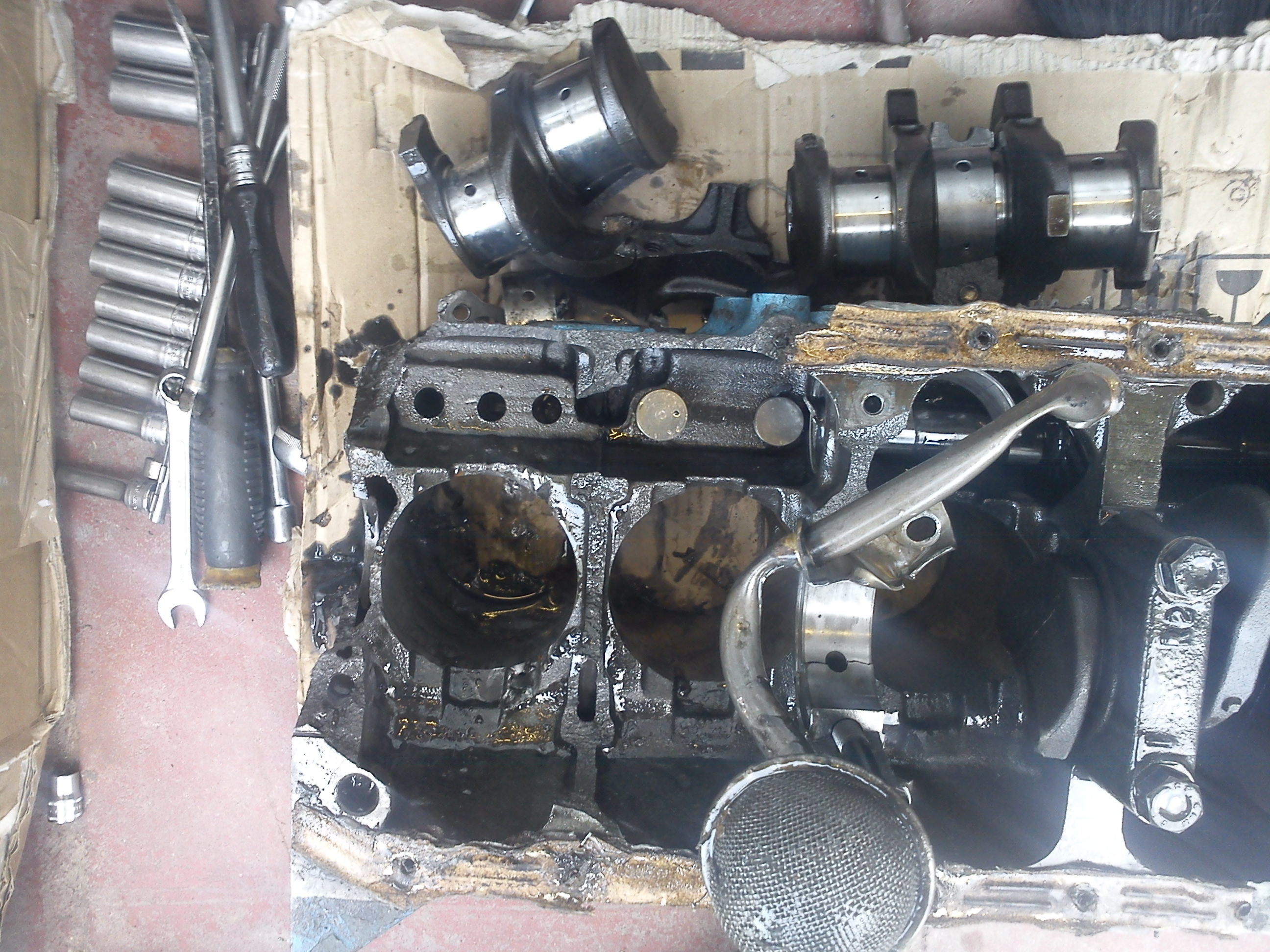

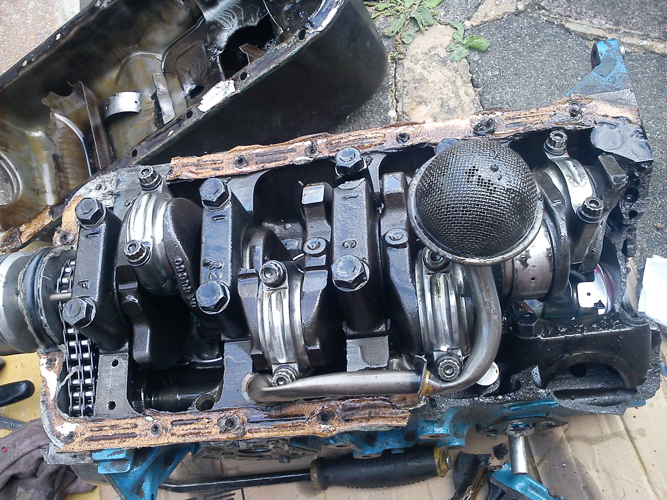

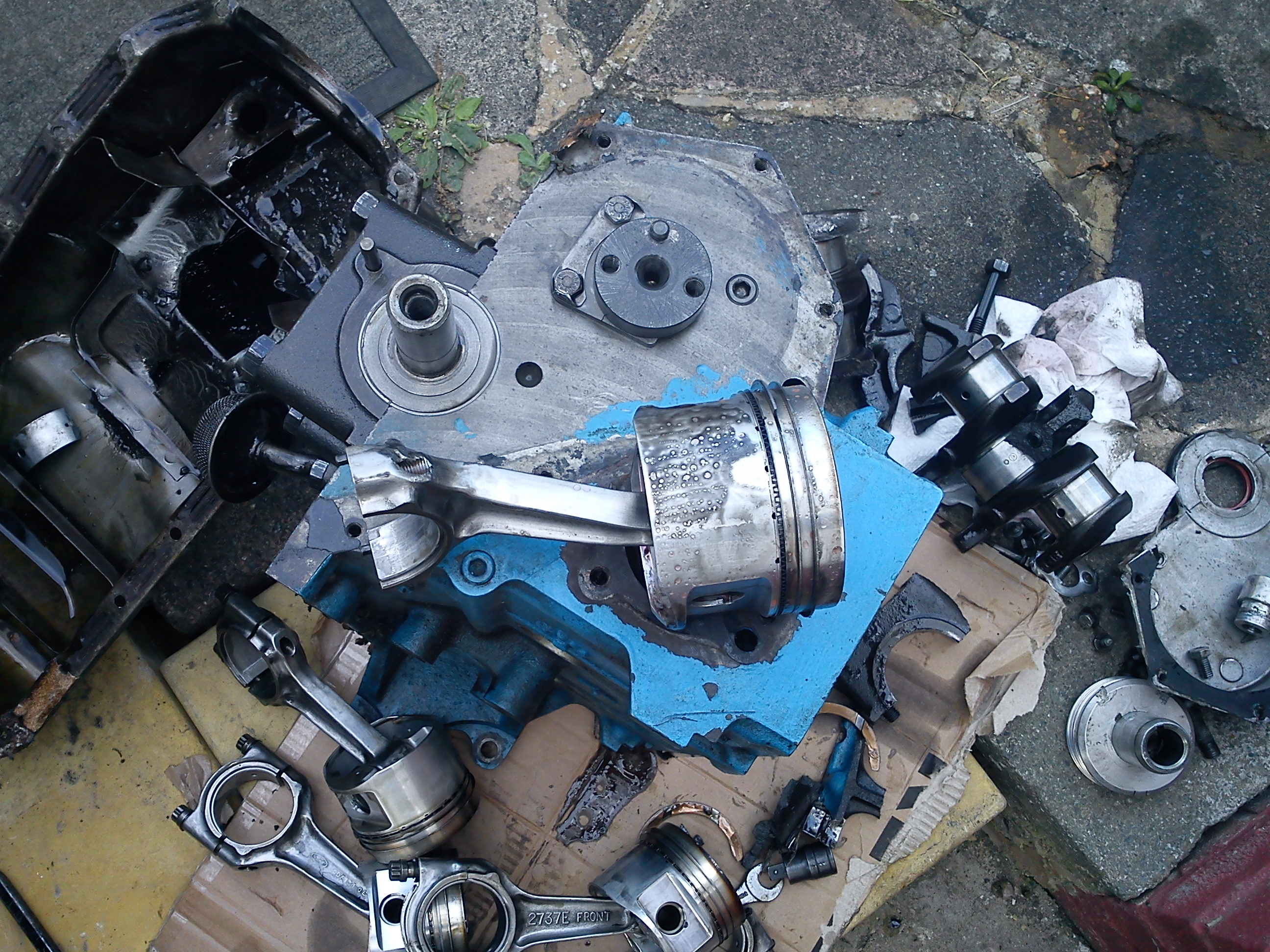

                          #282
                          bloody hell thats made a bit of a mess

                              #284
                              Things can't get much worse! It's not only the engine that's broken,the bellhousing's knackered too,plus maybe the starter motor, I won't know until I fit another engine.........Main problem I've got is that I've got nowhere to work at the moment!
                                #285
                                I've shared the same faith than you did. Back then I was wondering is it the crank that fails or does the main bearing cap start to give. Well I did not go for the steel main caps... I went for the Pinto. But could you give the steel main a some thought.
