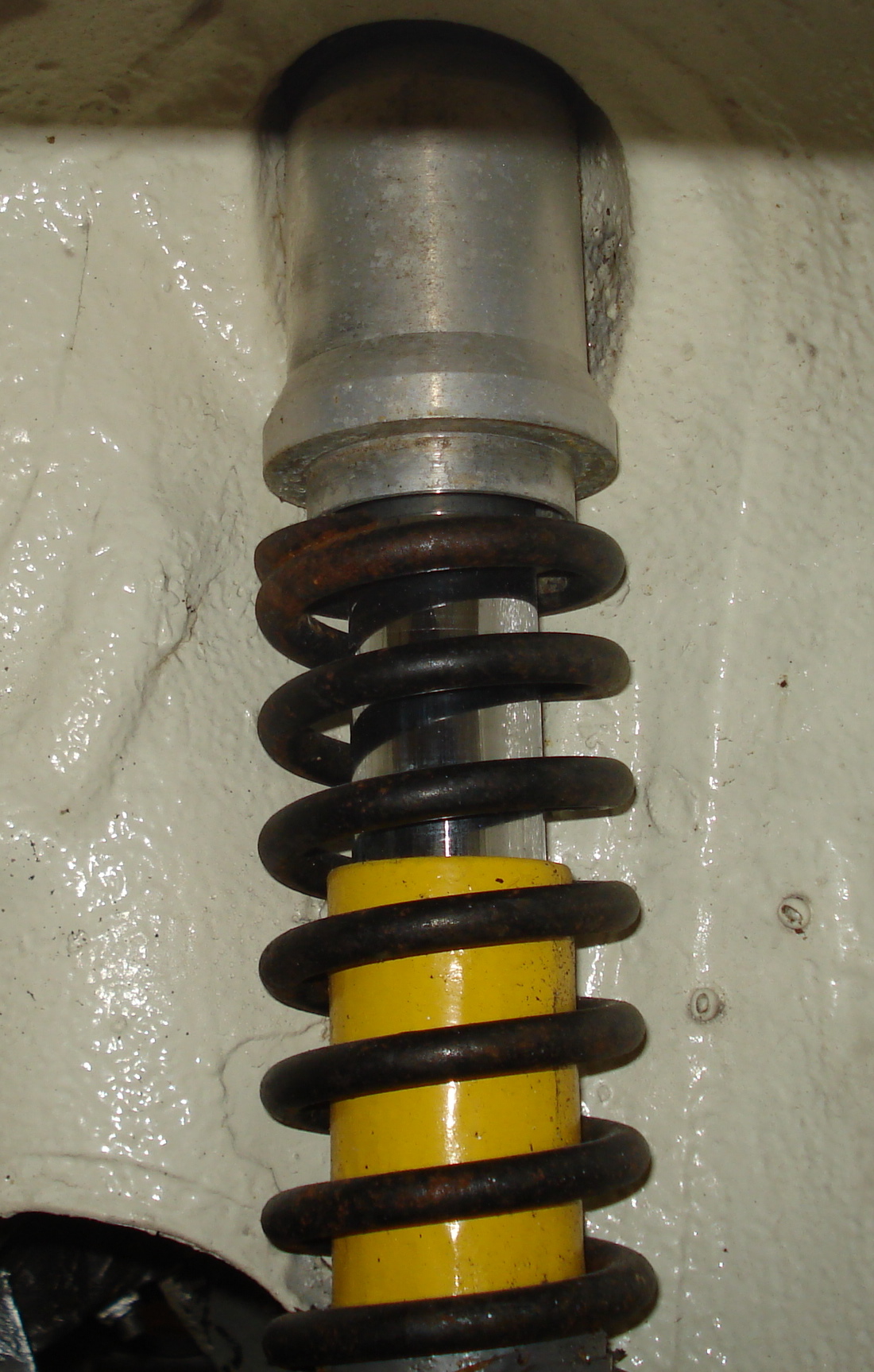

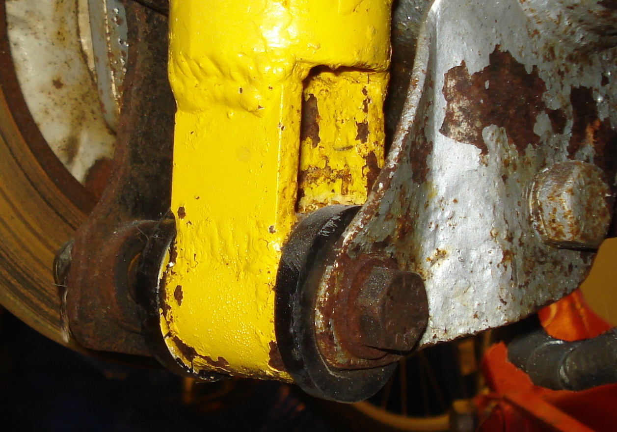

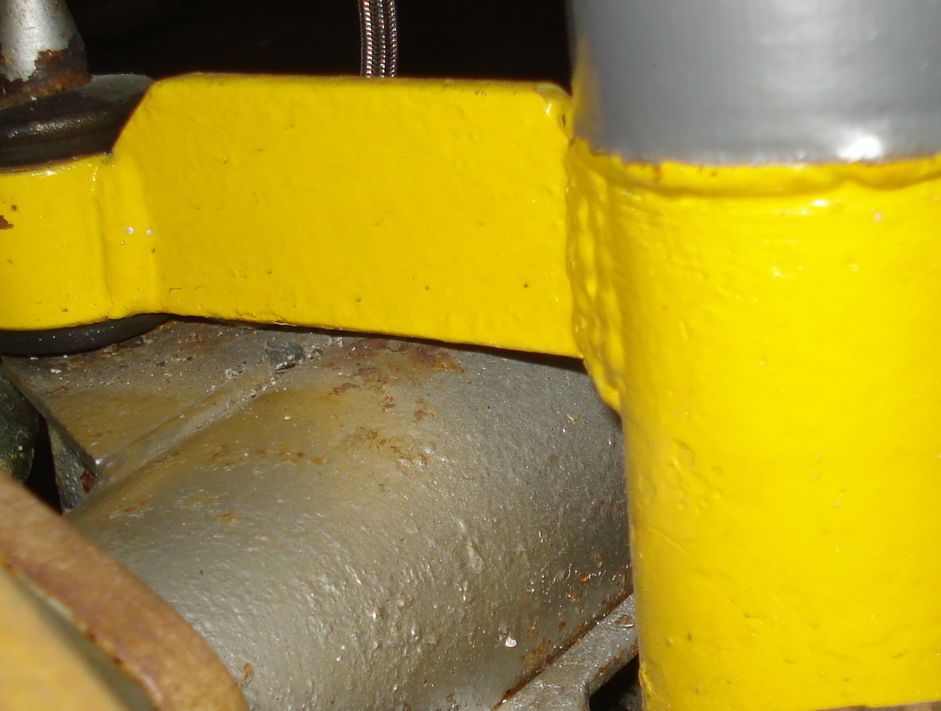

Fitted the Kustom rear arms, having removed the rear hubs to fit the wheel studs.
Saved 1.7Kg in weight. The new arms weigh a combined 628grammes, and the TAS arms weighed in at 2.37Kg. Alloy panhard rod to follow.
Hubs will be drilled 12.5mm so the wheel studs can be fitted.
I found the rear wheel speed sensor had melted, from the heat build up on the rear disks. Time to have a rethink about its position and the position of the others for the ECU. (one on each wheel)
