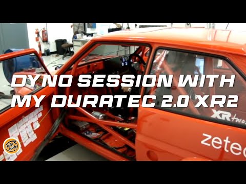

        Troy worked his magic on the car.
        Corner weighted, then alignment which showed up a .problem with the 2nd driveshaft, which as I suspected is too long and binds which prevented us getting the castor and camber on the near side. So I need to order a shorter one.
        On the rollers we still had the oil leak from the filter housing and stripped it all off the car, rebuilt it with dowty seals after modding the filter housing, and that fixed the problem.
        Troy already balanced the bodies, and I'd fitted the larger injectors before the session, so the engine ticked over at 650rpm, and starts on the button.
        Several power runs highlighted a problem with an earth somewhere. My car kept causing the dyno to reset, so after some headscratching we earthed the car VIA jump leads to the dyno chassis and that cured the fault.
        Dyno runs showed a cooling issue but it turns out I'd plumbed the header tank in to the wrong hose so I need to sort that out.
        Red lined at 7k but if we move it to 7400 and run a straight cut box, I reckon we'll get 210 easily.

          Took lots of video on my camera.
          Two from my camera phone are on YouTube

                  The Fiesta was causing the rolling road computer to trip. Troy said he'd never seen it before. We had to earth the car to the dyno chassis, to cure the problem. Most peculiar, considering the Fiesta never missed a beat. I reckon it was static being generated by the wheels on the dyno, but its hard to tell where it came from. There was a voltage differential between the Fiesta and Ground, and grounding the chassis fixed it. Its a new install at Northampton Motorsport as they've just moved premises, so it could be an earthing loop somewhere in their mains setup.
