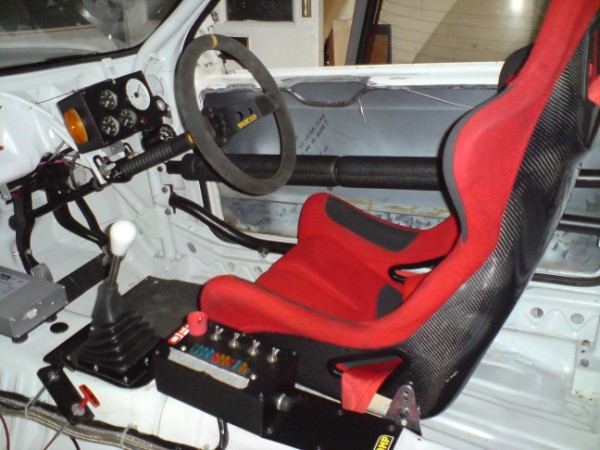

                  Concentrated on finishing the inside of the car today. Have now fitted my new carbon seat that was a TS bargain. Is a bit narrower than the sparco, a little lighter and looks much better in the car in red than the blue did imho
                  Also finished my new gear lever. It is the one Gary made for the TVR T5 that I had in the escort, so first I had to change the holes as the spacing was different on the tvr box and then I cut nearly half of it off to suit the driving position in the sierra. This is just a touch longer than the type 9 stick was I think.
                  I got a nylon gear knob from motorsport tools and turned the end of the stick down to 10mm. I have drilled the knob out to 10mm so that it is a tight fit and will glue it in place before I drive the car. Didn't see the need to thread it as it is only one more thing to work loose
                  I have also fitted a gauge pod and boost gauge that I picked up from Burtons the other day. Is easily visible through the wheel

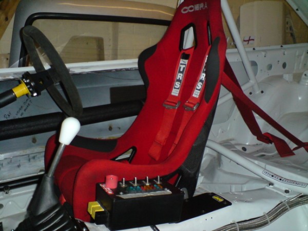

                  Hi Dave,
                  Do you race with a HANS device? If so you may want to check the angle of your belts. If not I strongly suggest getting one as they really save your neck. They are mandatory in the US and I wont even get in a car with out one now....... especially wheel to wheel
                    Originally posted by DanR
                    Hi Dave,
                    Don't have one yet but when I do I'll probably fit a belt bar to the cage

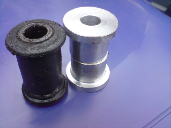

                          Fitted these alloy steering rack bushes today, much better than the origional rubber ones and at £20 new off ebay a bargain imho
                          Still trying to get the old rear beam bushes out though , they may have won another battle but they won't win the war
                          • mk2stu
                            • 318
                            if their the same as fiats rear beam bushes m8 get a blow torch on to them(i use oxy at work but a small plumbers one should work fine)
                            burn the bush out itll smoke like mad but dont worry really let it burn then get a hammer and chissel and smash the rubber centre out it will probably take a couple of goes with the gas once the centres out scrape away as much of the remaining rubber as you can on just one piece then cut the metal sleave make sure you get a good even cut all the way through otherwise itll be a bitch once youre happy youve cut the metal sleave get a good sharp small chisel hit along the line were youve cut and theyll just push out hope that helps mate

                              any luck yet m8?
                              do ya like dags
                                Originally posted by mk2stu
                                any luck yet m8?
                                Na, only been working and eating all weekend
                                Will have a go with a blow torch later in the week, also got some other pullers to try
