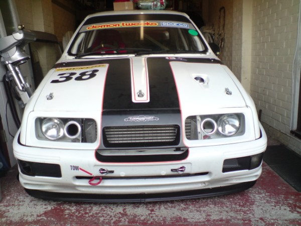

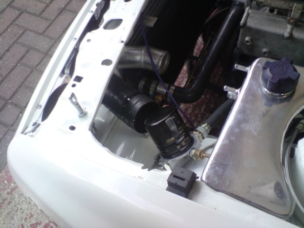

    Have now fitted some 75mm radiused air intakes into the headlamp perspex covers. The o/s one feeds directly into the airbox and the n/s one feeds some handy cool air to my now relocated remote oil filter.

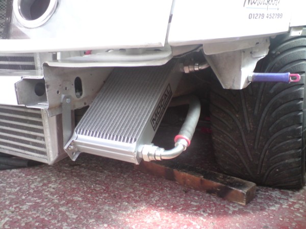

    The oil filter is located to allow the best possible pipe runs from the engine to the oil cooler which I have fitted under the inner wing. The cooler gets air from the n/s spotlamp apature and isnt actually that close to the tyre as the pic suggests. I will be fitting a mesh and plastic guard to the cooler just to be sure that no stones or rubber off the tyre will hit it.

      The bottom outlet on the Header Tank, where does that lead to..........the tube that runs next to the bottom of the rad ? If so where does that lead to ????

        leads to the bottom hose steve

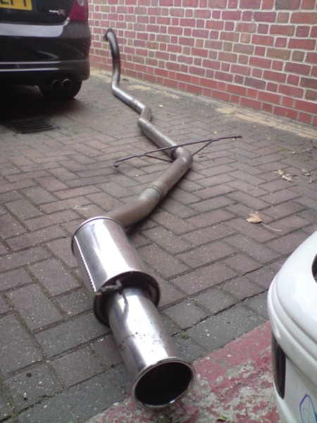

              Didn't get much time to work on the car this week but did manage to find a decent exhaust system on ebay. Looked like crap but after a bit of a clean up looks quite smart. I think it is a twin box scorpion that has had the middle box removed, and it should be ideal.
              Just need to make some brackets for the car now as I think I cut the centre ones off last year as part of the weight loss scheme

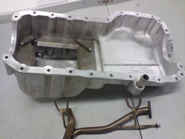

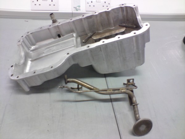

              Should be picking up a 2wd sump tomorrow too so we are gradually getting there

                It'll probbaly be pretty loud i reckon Dave.. plus have you checked how much the system narrows going through the silencer?
                I've heard several people saying that the one to get is mongoose as they don't have the same narrowing/restriction going through the back box.
                Obviously it's never going to be as big as the tail pipe but iirc the 2 1/2 inch scorpion narrows to somethign like 1 1/2 inch through the silencer which can cause problems.

                        Let me know if I can be of help with the zorst tubing Dave
                          Not too worried at the minute Mark as the system is 3" all the way through and should be plenty big enough for the power we need. The rear box will ultimately get replaced with a re-packable silencer anyway but at least we will already have all of the bends etc in place.
                          As for noise my more revvy NA engine on TBs ended up with a single box and was ok, so with lower revs and a turbo I should be fine.

                              My new sump after a quick dip in the wash tank at work
