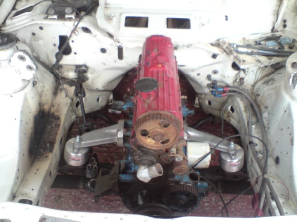

    Out came the V6 yesterday and in with a pinto that I have aquired as a dummy engine whilst my excellent new engine builder works on the real one. The dummy engine will enable me to fit all of the ancillaries around it and fully sort the engine bay, that way once the new one is done it will drop in and all be literally plug and play

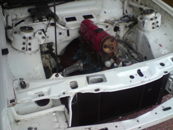

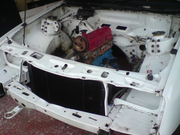

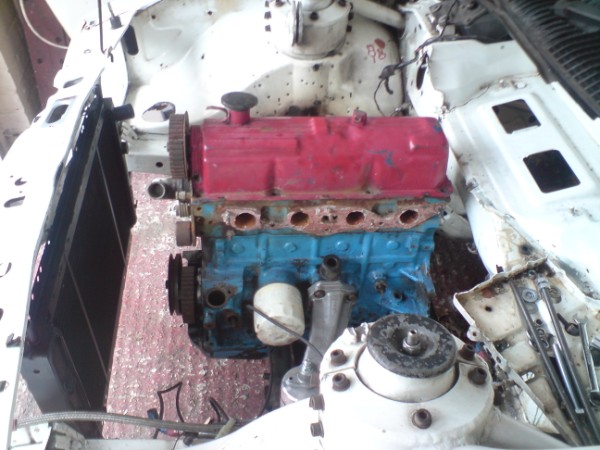

    Here's the pinto ready to start having the exhaust and ancillaries fitted;

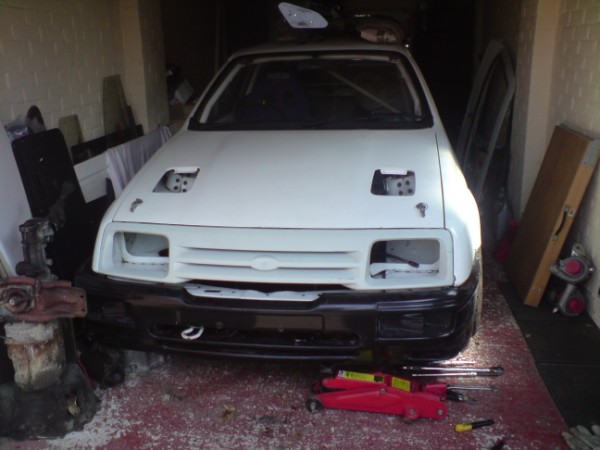

    And a rough idea of the new look of the car, won't have a cossie grill or whale tail, but still have RS500 bumpers and arches. Will all get a little tickle from the painter once we're ready too, but wiil stay white and black
