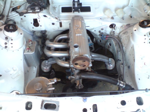

          Right everyones been grafting on the car today and after a bit of paint and drilling the engine bay is starting to take shape.
          Water hoses are on and awaiting silicone replacements. The dry sump tank needs another inlet tigging on and a bracket to hold it to the chassis rail but thats roughly where it will go. The breather tank will sit forward a bit, between the rack and the oil tank, also bolted to the chassis rail.
          We bare metalled and painted the cam cover and top mounts too, to pretty things up a bit.
          I also fitted the bulkhead blanking plate and coil pack while andy started to modify the wiring loom...
          Thats about as far as we got before the sound of a V8 and tyre smoke marked the arrival of the painter, Ray. He already has all of the panels at the paintshop but it was the first time he's seen the car. After much pondering and grinning he called a halt to the building up of the car by saying he needed it stripped naked ready for a total repaint
          A couple of hours later, and there is only enough bolted to the car to let it roll and steer. i'll get a couple of pics tomorrow but needless to say its STRIPPED. Will start prepping it tomorrow ready for Ray to get his hands on it. God only knows what colour it will end up .....

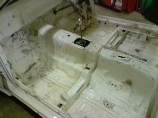

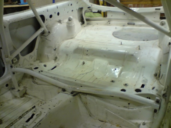

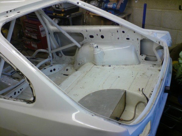

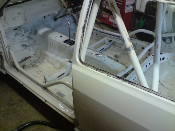

              Started prepping the interior today, flatting down the paint and removing duct tape that didn't want to be removed, having spent 10+ years stuck to the floor and the cage.
              Clearly someone hadn't heard of grommets, each 10mm hole had 6" of tape to cover it up
              A little more still to do inside the car and then the engine bay can be prepped, although that is in pretty good nick, mostly just in need of a flat down and a blow over.
              Also removed the door bars to clean up the area below and retrieve the parts of the old loom that were jammed under there. Don't want to remove too much cage as it can be a bitch to get back in but most is easy enough to paint in situ and the screen will be out soon too. Will be fitting a 2nd set of door bars higher up to protect the driver, but the lower ones will remain as they tie nicely into the sills.
