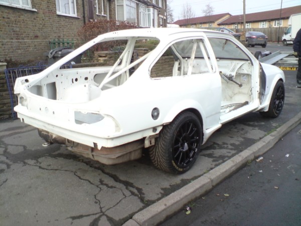

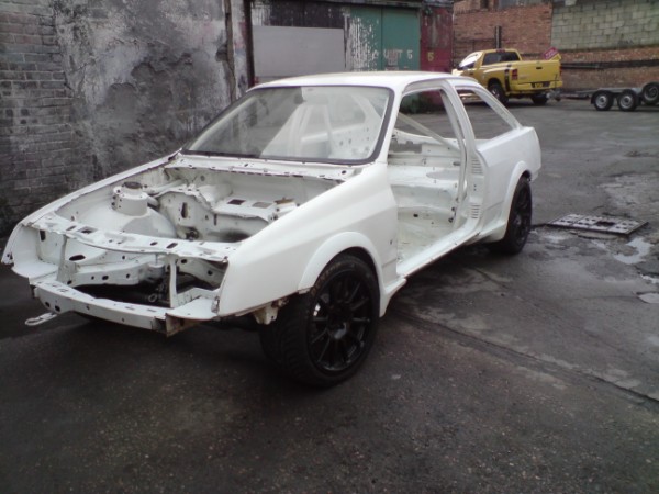

            Well all the prep we can do is done now so heres how the car looks as it leaves for the painters..
            On arrival at the workshop after taking a very rapid drive through Walthamstab behind the new tow car
              #201
              Are you running with the standard fuel tank.
              Who's is the yellow beast?

                The Dodge is the painters, does great burnouts and loves going sideways, although i'm not sure the trailer knew wtf was going on

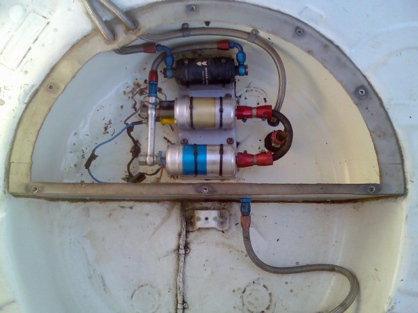

                      Right all of the origional tank and filler fittings are off of the car for good now and i've sourced a nice 7 gallon alloy foam filled tank which will fit in roughly the same place under the floor. The filler bowl will poke up through the floor and therefore need a little cover over it but at least the whole tank won't need firewalling in
                      The pump/filter arangement can stay under a cover in the wheel well but I'll probably sheet the whole wheel well over so I can get my lift pump and maybe a swirl pot under it too
                      This is the current pump arrangement designed for the YB;
                      Oh and I also have the kevlar tank guard that came off the car if anyone is interested, I think Ford fitted it to all of the rally cosworths back then, it needs a good clean though
